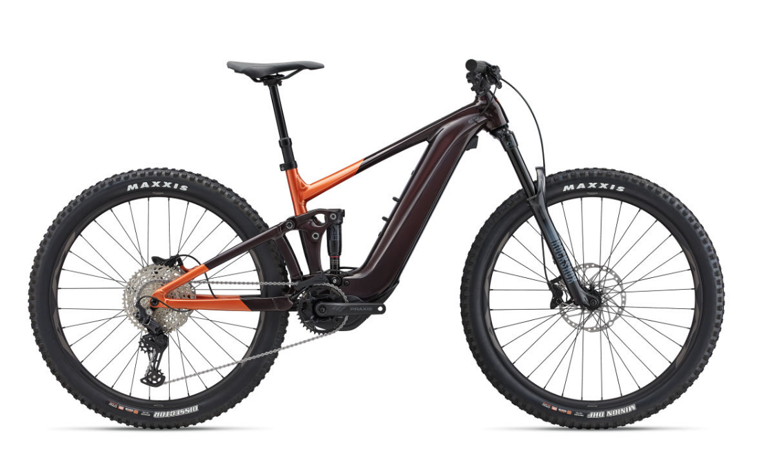

The latest Giant Trance E+ 3 Pro. The colour is Cordovan/Copper Coin.
According to the website I see for the bike pictured in your reply it isn't marked as the "Pro". I haven't shopped for mountain bikes in a long time. My last and current is a 2015 Giant Trance 1 which came with composite wheels and is very light. I'm ready for an electric version.
