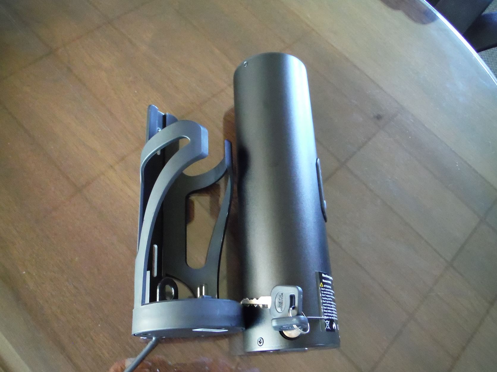

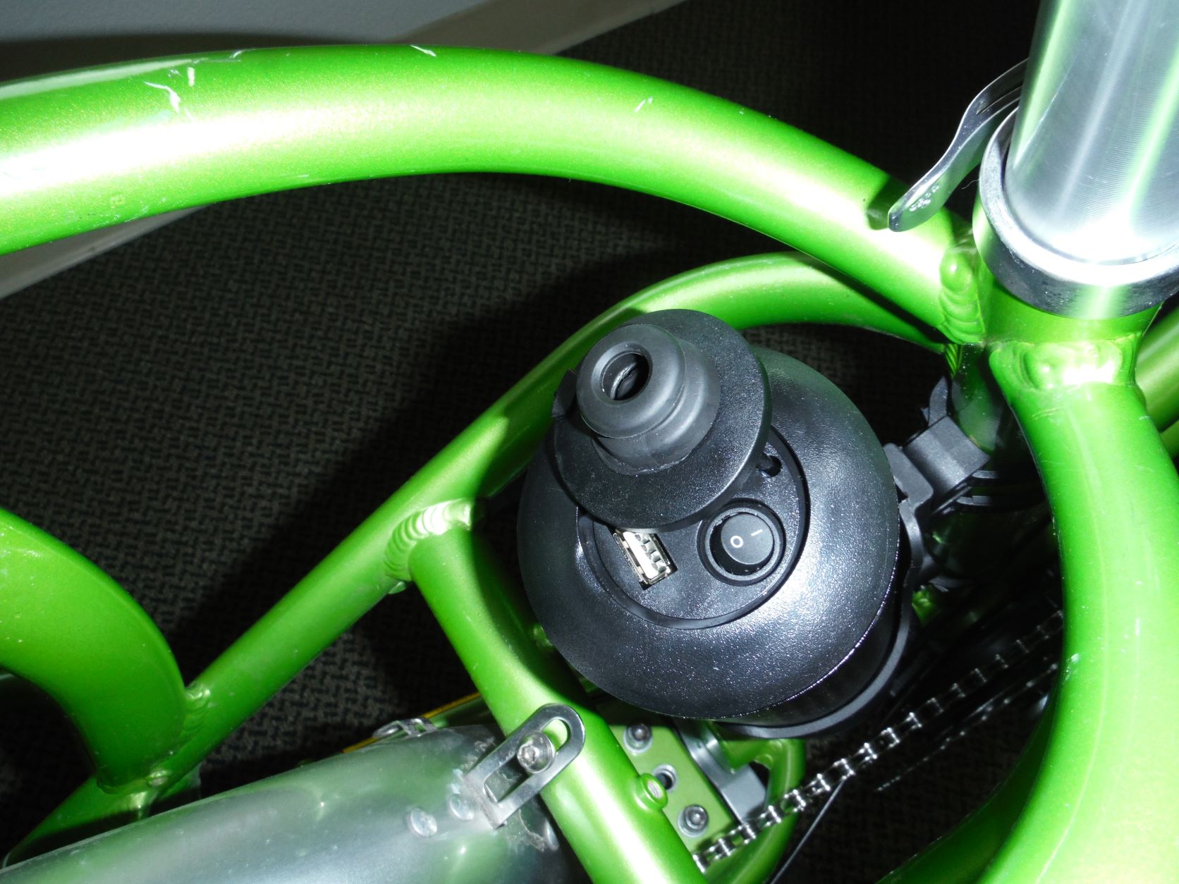

In the off chance you are in the SF Bay Area, I just had some very nice batteries made and they arrive next week. I am not a retailer, just a fellow builder willing to be helpful, so you do not have to wait six weeks. These have premium cells and BMS. The 48V look a lot like water bottles and are 7Ah or 10.5Ah. They also lock with a key and have a USB port, On/Off switch, and charging port under a cover of the battery's lid. I like having a USB port. I can use it to slowly discharge a battery for safe storage or transport. Being able to turn a battery off is also a nice thing for safety.

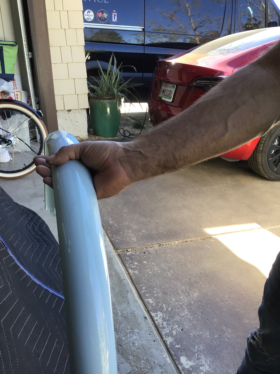

Here is a pic of the fender. You cant tell anything from this photo… but I’m very impressed with the results I got from rattle cans!
in case anyone is wondering… I used Montana Gold paint ( and their universal primer) with SprayMax 2k clear coat. Lots of prep work, color sanding and buffing with a buffer and compound. I did not strip the frame to bare metal prior to priming… I just sanded it till it was dull.
I’ll post updated pics when it’s finished!!
