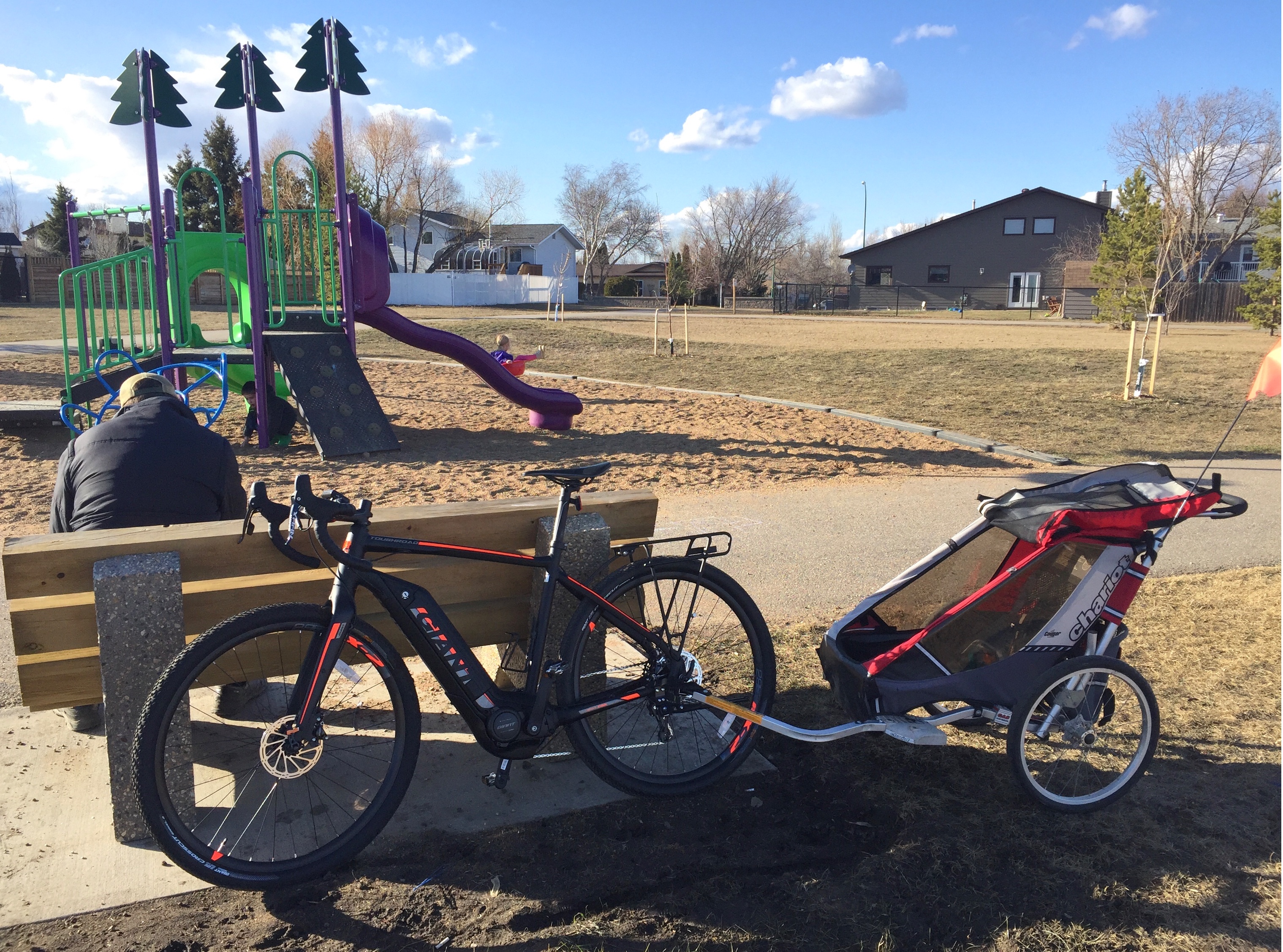

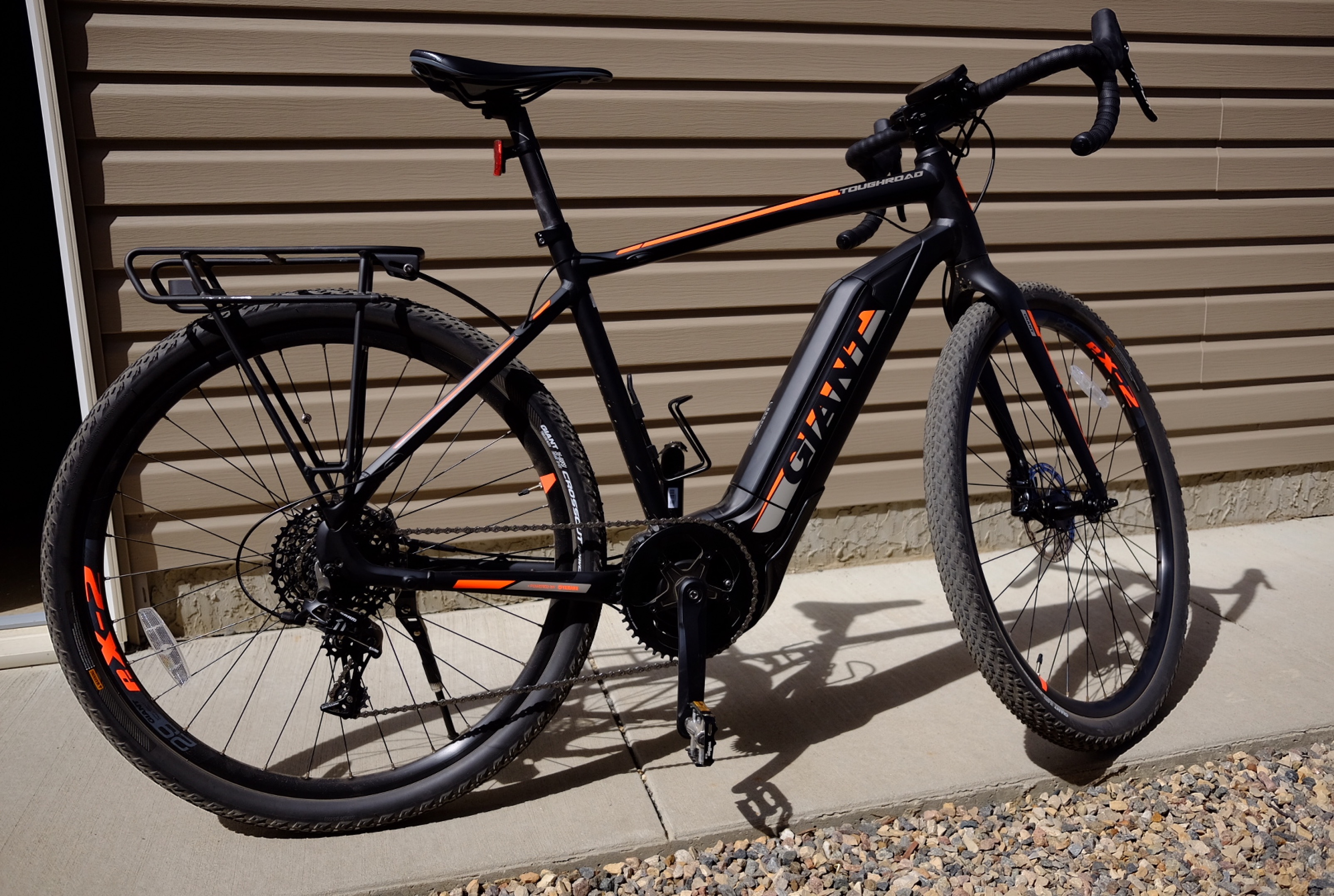

I took possession of my ToughRoad GX E+ about 10 days ago and I am loving it!
I chose Giant simply because I live in a small city and our fantastic LBS sells them.
My riding consists of a lot of street and path riding with some dirt trails. I also considered a Quick-E+ and a Dirt-E+ but ultimately the ToughRoad ticked the most boxes for me. My wife got a Quick-E+ 2017 though.
I have the rear rack and the front and rear fenders should be in this week to nearly complete the setup. The only thing I have left to figure out is what to do about lights. Because of the display there isn't a lot of room for a light on the bars.
Pulling the child trailer sure is a breeze with pedal assist!

I still love it. It’s taken a bit to get used to no front suspension and drop bars coming from an old mountain bike but the 29ers roll over the rough stuff pretty well. There are tubes in the tires now but I plan to run tubeless when I get a chance to set them up. I’m considering seatpost suspension but haven’t decided yet.
Also my first experience with a 1x and I think it is perfect for this bike. I rarely use the highest gear - although I was ripping at 52kph with the wind at the back the other day - and I’ve yet to need the lowest gear. Kind of sucks that it is limited to 32kph - derestricted this thing would really go.
I almost always ride at the highest assist level since I’m not worried about range and I love the acceleration. I stick to 32kph on the way to work but ride above the cutoff speed on the way home so I get a bit of exercise.
I got the toughroad fenders. The front one is extremely close to the top of the tire and I only run it if rain is imminent that day. The rear one I just leave on. I was disappointed that they are shiny black and not matte like the frame colour. No big deal though.
Not yet. 32 is quick enough most of the time so I’m not in a big rush. I am looking at getting the bikespeed-RS eventually.
