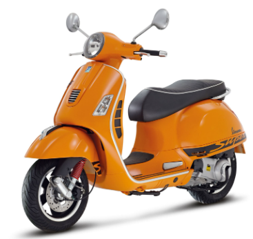

The fact the moped you have shown has been Type Approved does not make it legal. Not sure whether the British Road Code has been changed for mopeds but my bets are it has been not. If the owner really tried, a Pedibal could be made road legal (see above) but I even cannot see a number plate holder on the mini-motorcycle.
I do not want to elaborate on that more, and only regret I wasted 15 minutes on watching the idiot chirping. Oh, she would not mention it was a moped, oh no.
The law of the countries I am familiar with does not make the "UK legal throttle e-bike" any different from a Vespa.
