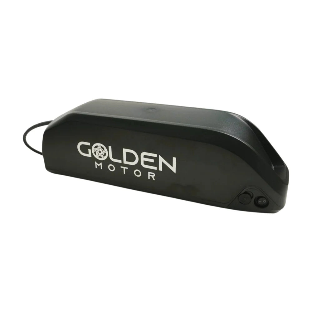

Hey so I'm doing my first diy build. So far I got a schwinn biggity dlx fat bike. I'm ordering a bbshd kit and also getting the asi bac800 external controller. As far as the battery goes, I'm on the fence between this
And then I saw this on amazon.ca for much cheaper but I'm wondering if you guys think it's a reliable battery given the specs in the add

The akonasada from Amazon appears to be just another new Chinese trading company, also on Aliexpress. I’d avoid them unless someone has seen or reviewed their builds. They don’t mention which cells are used. Brand names can be meaningless. EM3ev or Grin eBikes.ca, and then Golden Motor would be my choice. My first battery was from EM3ev. It’ll age out before cycling out.
EM3ev wins for me. My shop has them build the batteries, they have D-Powercore Bluetooth Battry Management Systems. Super easy full battery review/data on a smart phone. Making supporting their batteries easypeasy.
25A continuous is fine for a BBSHD. And the cells are GA, capable of much more. Perhaps that’s why the sale. They dumbed the pack down with a lower rated BMS. Making Goldenmotor best suited for 750W BBS02B or hub motor not your BBSHD.

BOTTOM LINE. Personally I’d use the Grin Phaserunner. They have a sweet BBSHD setup. Next LG HG2, 30Q or similar spec cell. I’m surprised that you’re considering a BAC style controller and not paying close attention to battery out put. Perhaps you might step back and reconsider some choices. You could hide a Grin Baserunner in a 30Q case. Or since it’s a kitbike? And you are ramping it up think about a hardcase sized 30Q. Shark packs won’t hold 17Ah of high output cells. I run 52V 20Ah Triangle pack on my BBSHD.

He’s apparently dreaming and reading about adding an external controller to over volt the BBSHD. The BAC800 he mentions will run up to 96A. I’m thinking endless_sphere or electricbike.com/forum are better forums for this monkey business. He’s looking at prices, not specifications. But then it’s a $300 controller kit on a $350 bike needing immediate brake upgrades. Pity the guy that sells the motor under warranty when the customer fries it.

Well I appreciate all the information. This is my first build so I am certainly a rookie. I did order the battery and as I already stated it seems to have great reviews both on the dhgate site and on reddit forums. If it's not up to snuff at least it wasnt expensive and then I'll just get the luna cycle direwolf which was my first choice but it's very expensive when you live in Canada. Also I'm already in the process of upgrading my disk breaks. I've already upgraded my seat and added a back rack and front and rear leds as well as reflective rim tape.

I guess, 130a throttled back, to under the power 30a your battery and the BBSHD controller will put out. Whatever! Have fun, hard to parse why anyone would buy something not in spec with the BAC controller. 96a is more than you’d ever use. When you fry stuff you’ll learn! Have fun! Been there!
