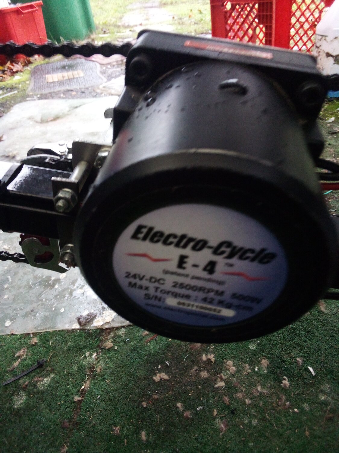

I bought it used how's the 24 Volt motor on it , This is a picture from the place that designed the kit for it , it's called an E4 motor style ,I tried some E trikes but the recumbent trike is more stable , The kit comes from a company in California who designed it ,

So the motor fits over the axle , do you have a picture of that bracket , Yeah I tried several different ways to mount a motor over the axle but it didn't work out , this seemed to be the best way on this recumbent , mount to motor
The axle is built into the motor( its part of the stator, the reason to use a torque arrestor is so the motor torque will not spin the axle out of the dropouts, the dropouts are the part of the fork the axle rests in if I can find this torque arrestor I mentioned I will drop a link on this site.
A Guy named John Bry makes this, this is the view on the left front fork, a setscrew tightens the cutout around the axle or positive grip and the body rests along the fork held in place by 2 hygear clamps,I do not believe the motor will shift with this thingy attached.

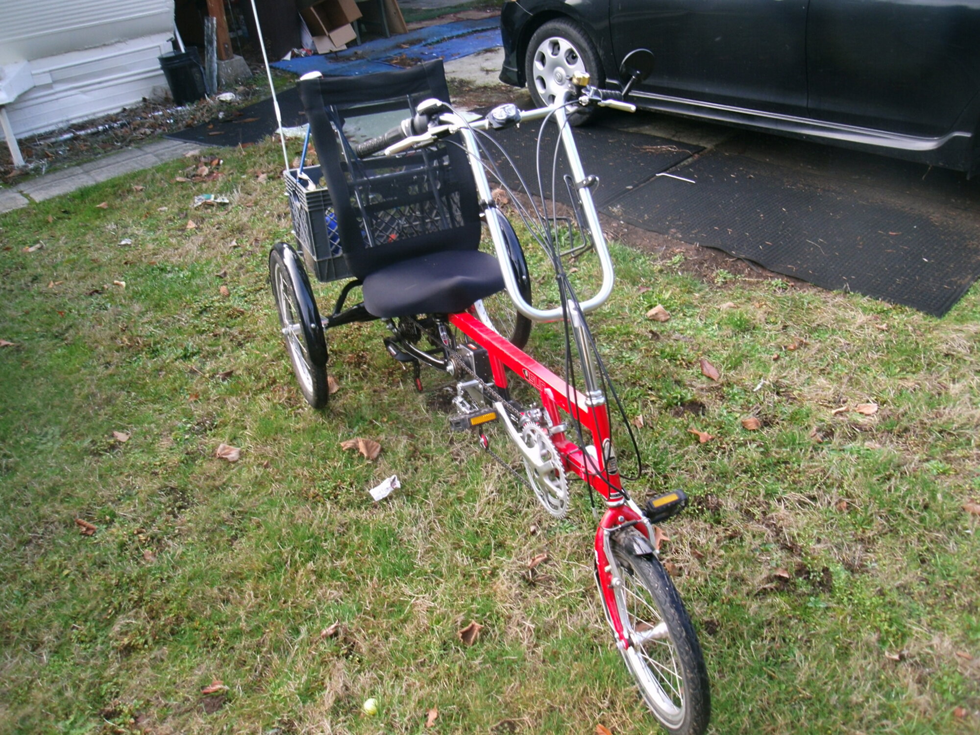

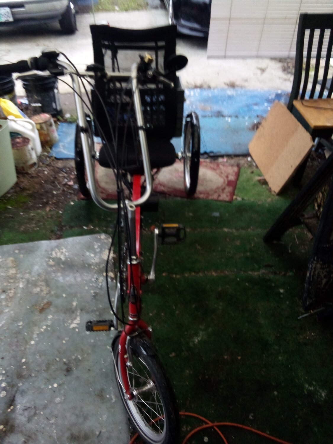

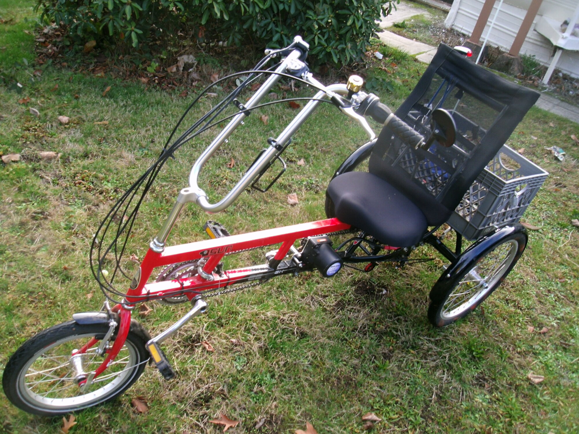

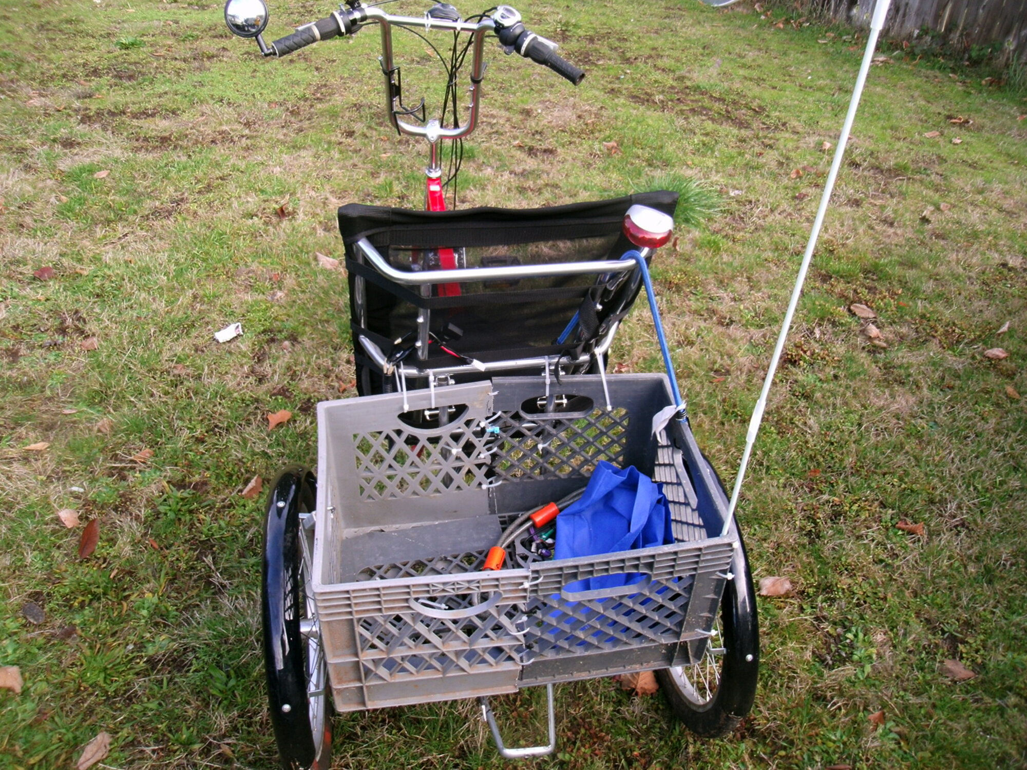

Here's some pictures of my recumbent trike as it looks today,I use it mainly for riding the round a neighborhood, going to yard sales or taking the cruise

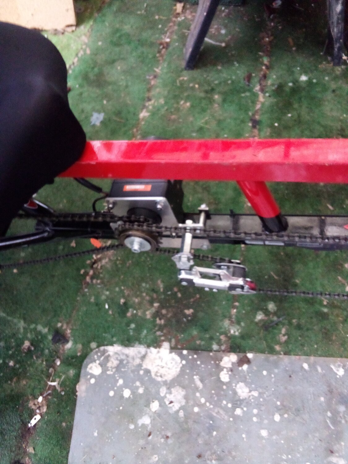

When the motor is spinning, the pedals are too? I can't figure out where the freewheel is at. Must have a really large turning radius, looks like the front wheel can hit the pedal.
ok I don't have a picture of it right now, but on the motor there's two sprockets the outer ones are free wheel and the inner one is not a free wheel so the outer ones connected to the crank, and the non Freewheel part of the is connected to the rear shifter and sprockets, so when not peddling the crankshaft does not turn but I don't have a picture right now couldn't find itWell it looks like if you click on the third picture above and enlarge it you can see what's going on with the chain and the motor Drive anyway thanks, turning radius is fine and no my feet don't hit the pedals,
Backwards gooseneck always looks funny to me... but it's not like what way it faces really matters.
If I have one complaint about my e-bike is that it feels too short. There's just not enough distance between the seat tube and head tub. You certainly don't have that problem! :D
Since you've got custom frame connected to the head tube, I probably would have put more rake on it... But I'm weird like that. Costs you a little turn radius, but let's face it at that length like it matters.

Better quality picture? Please. I’m curious but can’t make out details! Thanks!
Yeah I noticed that too, the gooseneck backwards , I just haven't changed it, yet,
This picture is a little better, there is a square cutout with a set screw that really tightens it around the axle shaft.
