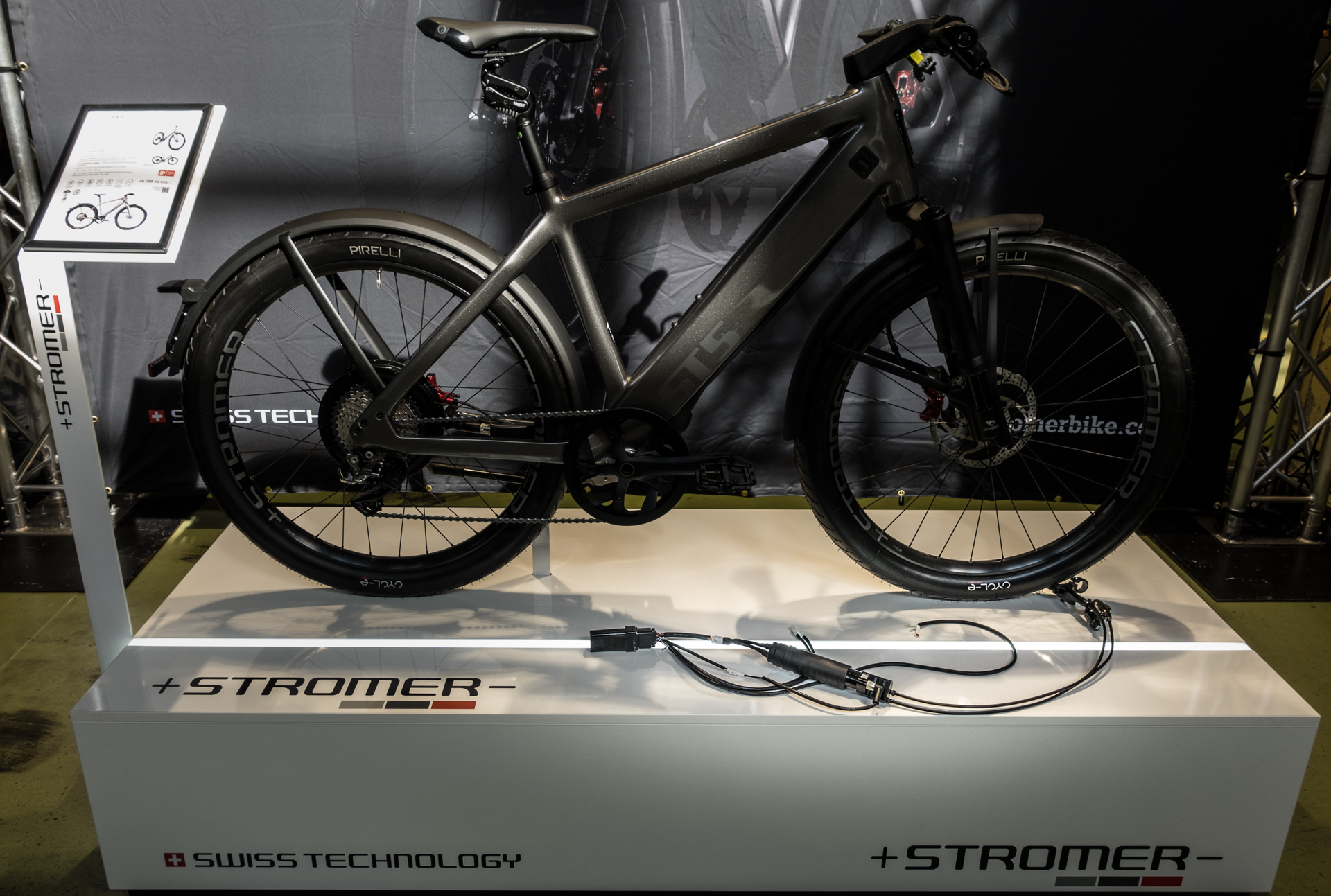

The next step in technology is to add the ABS to a Stromer. You know the Bosch ABS system, but as Stromer is also a brand with esthetic claim, it was no option. That's why the italian blubrake system is installed. The sole thing you see from outside is this second rotor. A light barrier counts the holes, so the rotation of the wheel can be measured.
The price will be slightly higher, to compensate the expensive ABS, there will be Alexrims instead of DT Swiss, XT instead of XTR shifter and the slower 190 charger.
I was able to test ride the ABS Stromer - did this on gravel. However, the best picture I could took was at the exhibition.
Thanks for picking up this topic!
I did not only pictures, I did als a short test ride. To test the functionality, I've chosen gravel. This is not the common road surface for a commuter bike. But the function of the ABS can be easily demonstrated. I checked first with the rear brake (no ABS), then with the front brake only. The outcome was very surprising for me and of course I discussed it with the people from Stromer. They confirmed my observations and explains why the ABS has this behavior as shown in this video:

I had a longer talk with people from blubrake. They already updated the technical parts, now they are more integrated and somewhat smaller. The functionality remains the same, a software update will take place. Stromer will change to to new series on the ST5 in Q2, the ST3 Pinion will have from beginning (an an option).
Observe the changes since the presentation: Red brake callipers and welding seams polished.

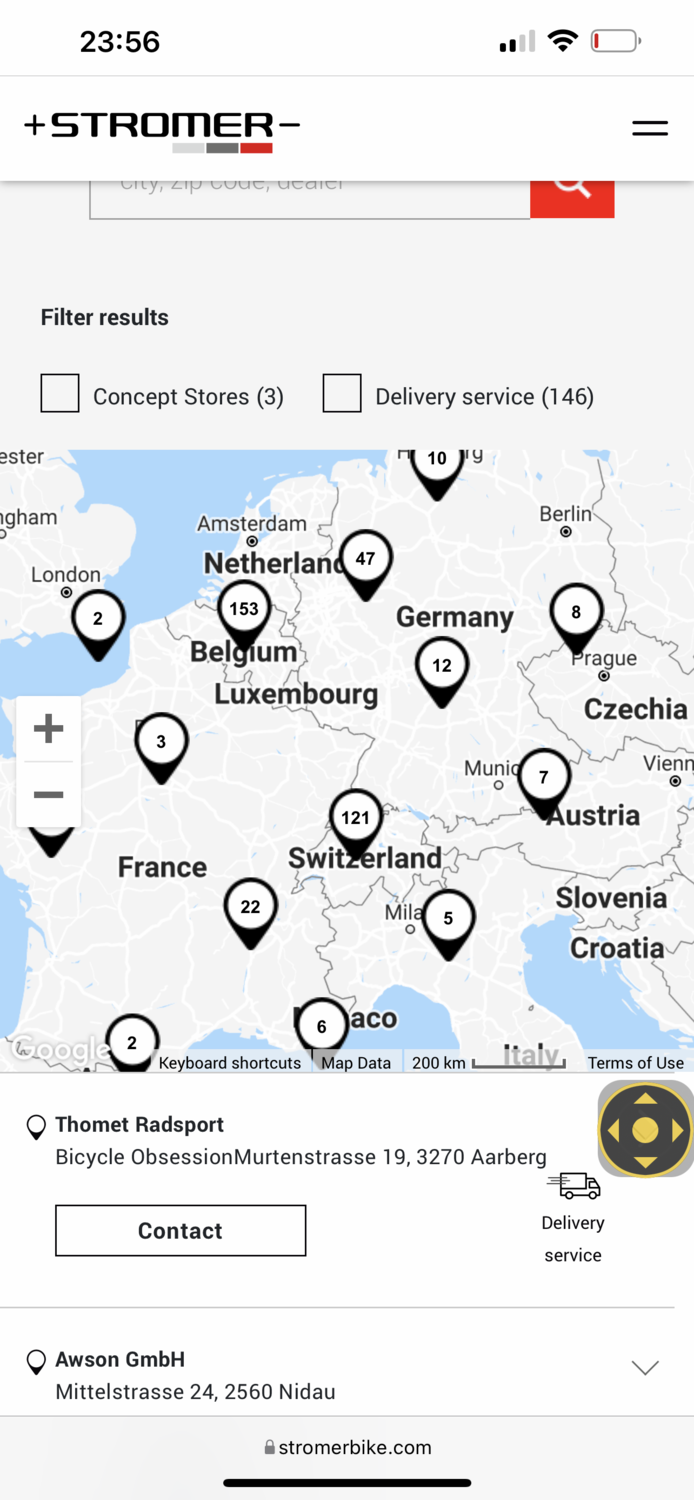

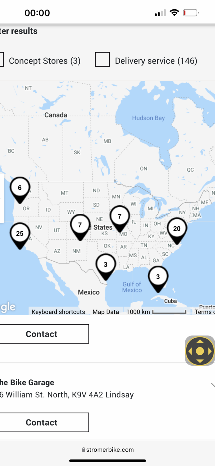

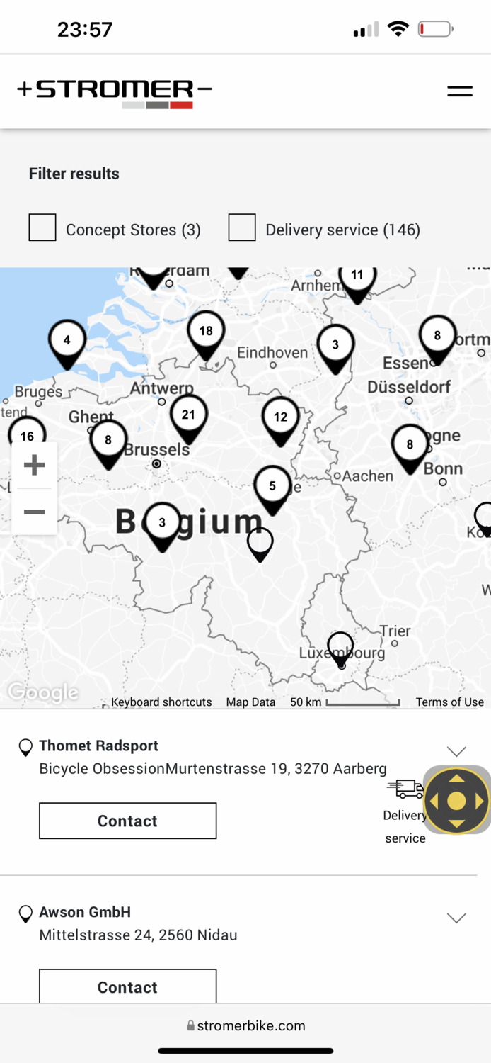

Stromer dealers in Us:
Only 6-7states with dealers, only 3 dealers in TX, Tx is about the same size of Europe..
C Belgium 50+dealers and Europe service vs Us !
