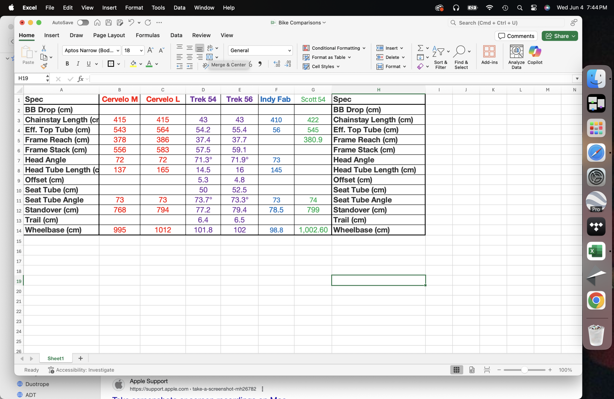

I stewed over these bikes all day yesterday until I went to bed, then woke up Googling and studying their geometries again. I just could not talk myself into the Medium Cervelo. Even though Reach was about same as Trek, the Stack is way shorter. Which is why, when I got on the Trek, it felt so much more like a good fit for me.
The Scott Addict eRide 30 was a contender, but none in town to test ride, and they have hub motors. Better specs on motor than the Trek, but not quite up to the Fazua Ride 60. And as much $money$ as these cost, I just wasn't willing to take a flyer.
So, I called the only other Cervelo shop in town (luckily we have 2 such shops). They had a Cervelo Rouvida Road model in size 56. I rode it and bought it.
Tonight I spent the evening figuring out how to charge the motor and the SRAM system, which is actually pretty easy. I like how the Cervelo motor is a magnetic connection to bike just like the magnetic charger on my Apple computer.
FYI here are the different geometries I compiled for my Indy Fab, Cervelo, Trek, and Scott.
