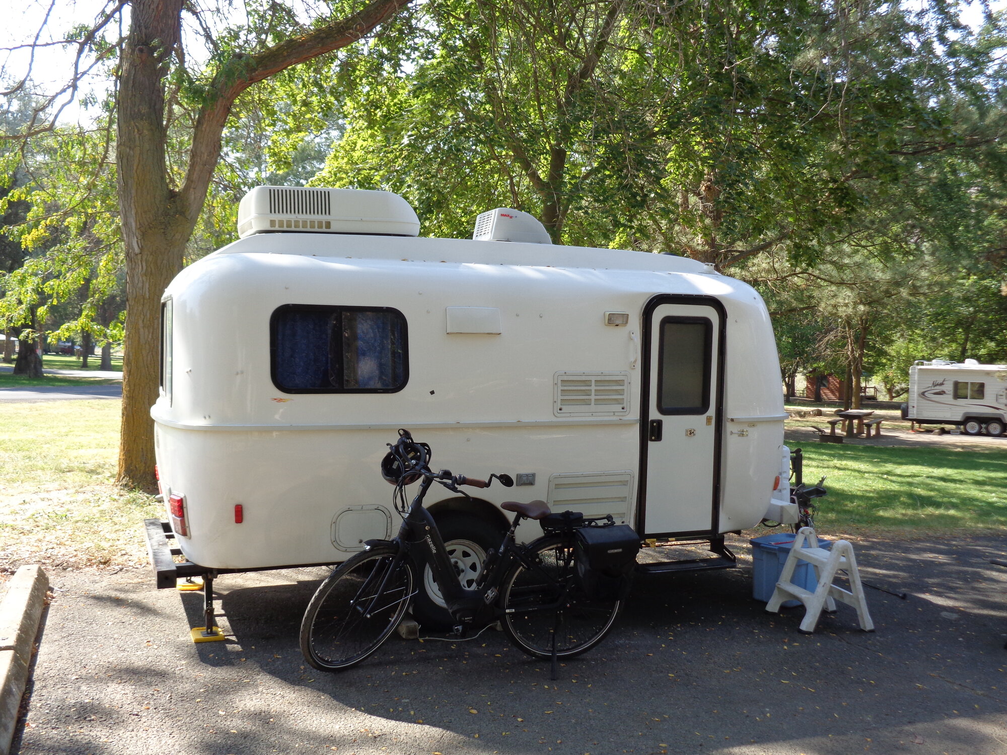

I don't think ebikes are as delicate as we think. I haul my Gazelle in the pickup bed. Then, at the campground I lock it to my trailer fender where it isn't sticking out. At night, I'm sleeping right next to it as the bed in my trailer is against the back wall and I also have a dog with me.
