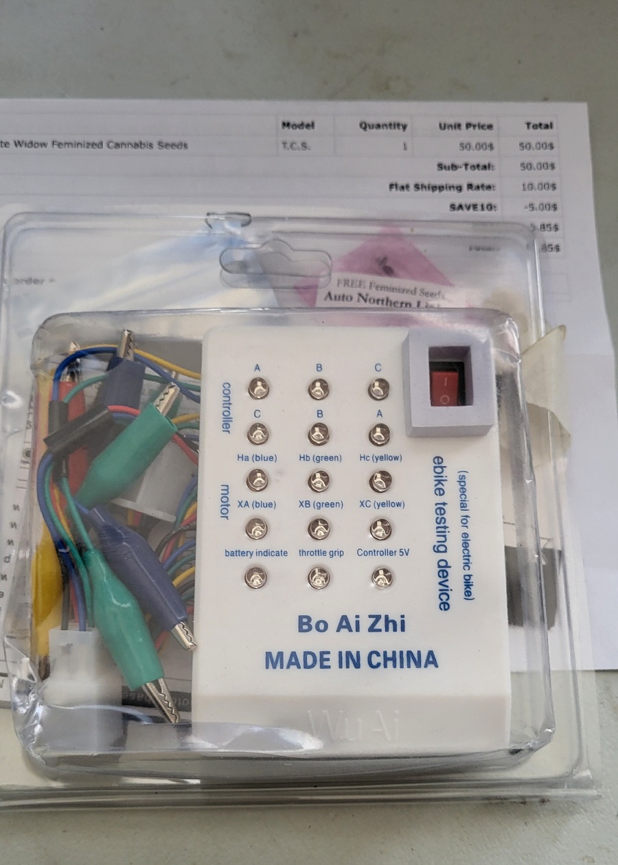

You can do everything the tester does using a Multimeter but the tester is a lot easier to use.

A tester should make all of that information unnecessary to know or understand.
My tester came with a connector plug that just plugs right into your ebike harness but it doesn't fit my waterproof connector plugs.
I could make a connector plug, but I got my motor working, so I'm not jumping into that rabbit hole unless I have to.
