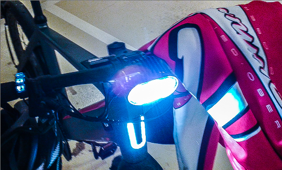

I just purchased a SuperNova M99 Pro to install onto my Haibike Fullnine RC with a Yamaha motor. What I discovered is the Sduro line only puts out 6v for the lights. I will be trying one of the M99 Pure units to see if those will work. The M99+ requires a 12v system. I have written to Supernova asking about the compatibility of the M99 Pure with the Sduro line.

The M99 Pro I had purchased did have a switch that was intended for the high beam. I am not comfortable installing the pro directly into my battery and the access is not available to my view. So I just installed the M99 Pure which is a 6v unit that can be controlled from the 4 way pad on the Sduro.
