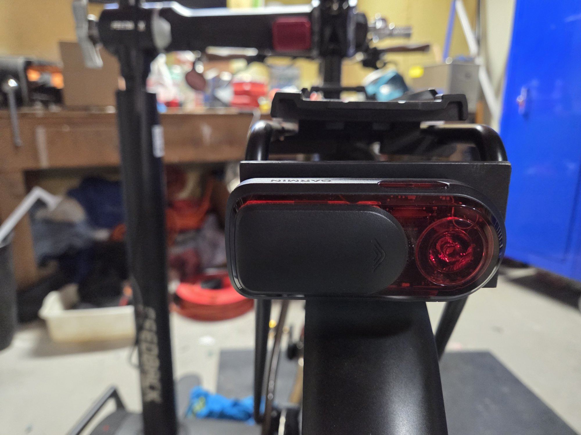

A while back I made a custom Garmin Varia mount out of a sheet of HDPE that attaches to the SKS rack. I sized it for the RTL510 but the RV820 looks pretty good on it.

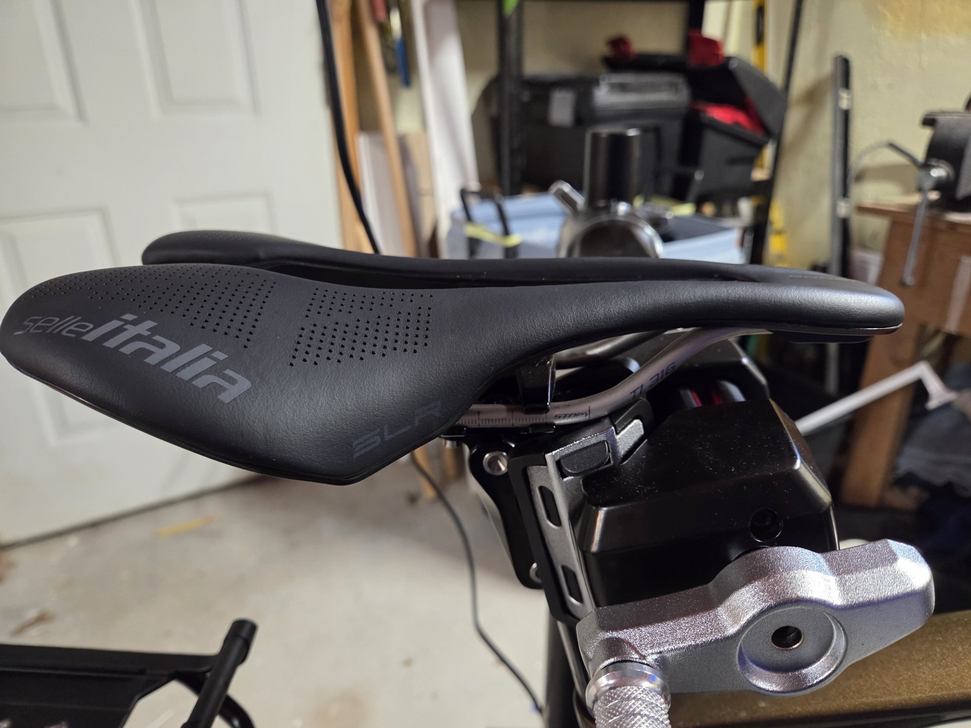

I also changed the saddle to one my fitter recommended, a Selle Italia SLR Superflow Boost, 143mm. I found one in great condition with Ti rails that we pulled from an eBay bike before sale. $100. It's the most comfortable saddle I've ridden on any bike in a while. A keeper.

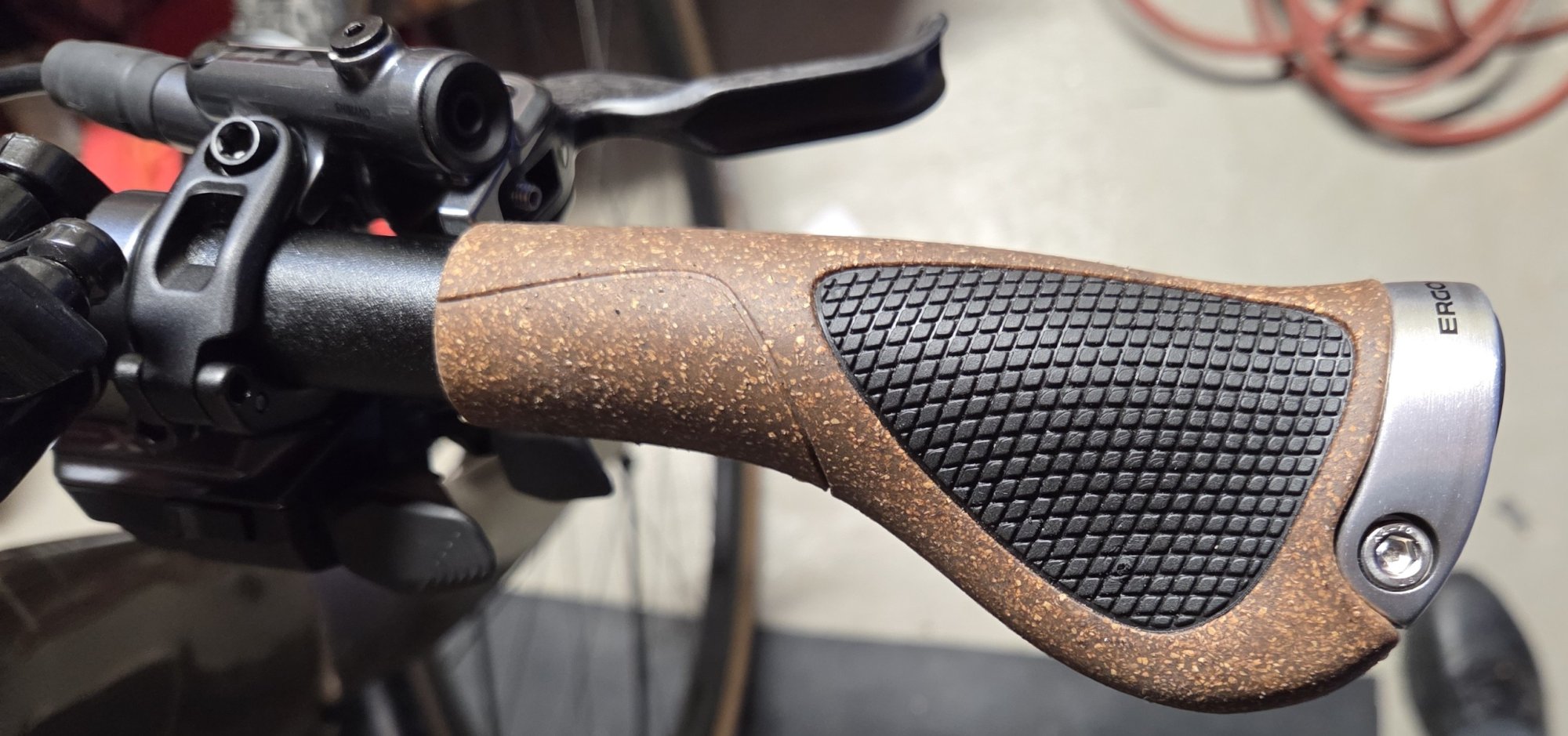

Finally, based on @Jeremy McCreary's advice, I decided to change grips from the moto grips that came with the bike, to Ergon GP1 BioKork. I need to rotate them back a bit, but they stopped my wrist pain as they effectively increase the sweep. The cork is a bit sticky, but I always wear gloves when I ride, and they do not stick to them. They also absorb road vibrations really well. I bought them direct from Ergon on sale. They came super quick. The cork looks nice next to the brown frame.
Not sure that was me, but I do like my blue rubber GP1 grips. Didn't expect the most comfy paddle orientation to be that vertical, but life is full of surprises.
That saddle looks great, Chris. I really like the ergonomic grips on my Fättie. They came with the bike. I don’t recall any discussion about the BioKork ones, but they look very cool — and I bet they do look right against the Pinarello’s paint scheme.
Do you like riding with rear radar? That’s what that is, right?
I won't ride without it. I upgraded from the first generation RTL510. I posted a thread about it somewhere.

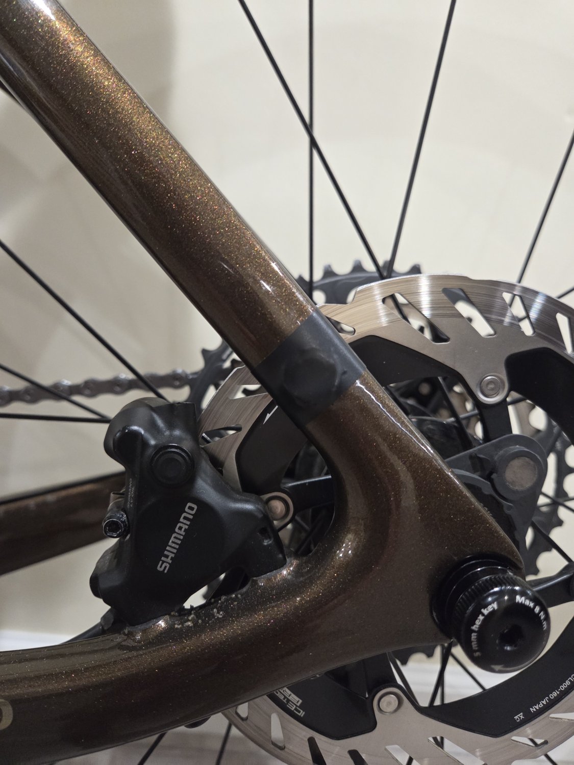

Unfortunately, the rear rack inserts in the seat stays have let go, even though I rarely rode with a load on the rack, and if so, no more than 5kg. The paint has also cracked around them. Pinarello approved our local carbon repair shop to fix it and retouch the paint. Once it's back, I'm going to remove the rack and fenders, and keep it as my long distance road/offroad bike. It fits me as well as any custom bike that I've owned, and I just love riding it.

Was looking at the non-modified version of his bike at a local shop this week and wondered if it was the next bike for me after my Vado SL. Google search brought me here. Nice writeup and cool mods. Sorry about the cracks!
