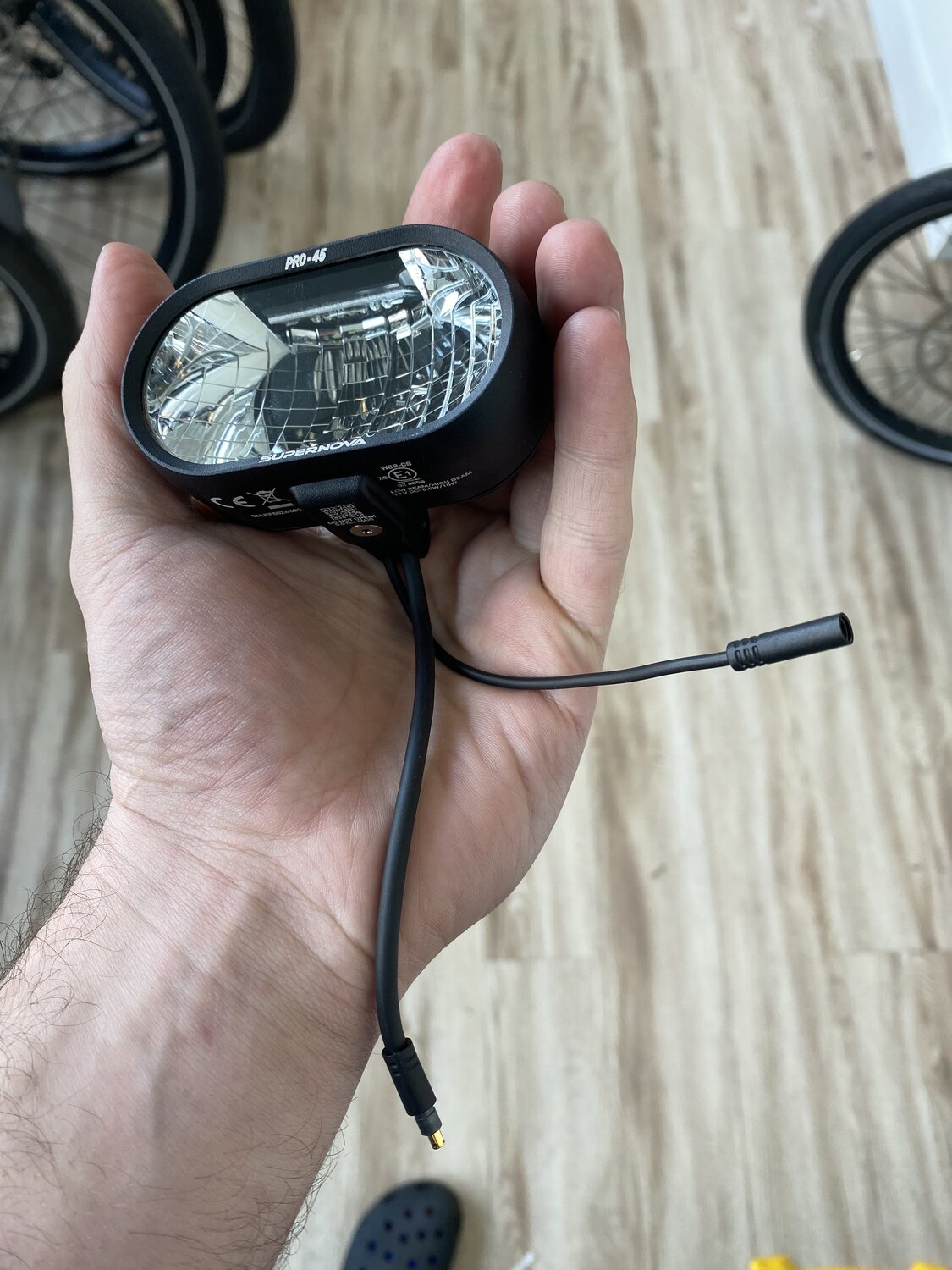

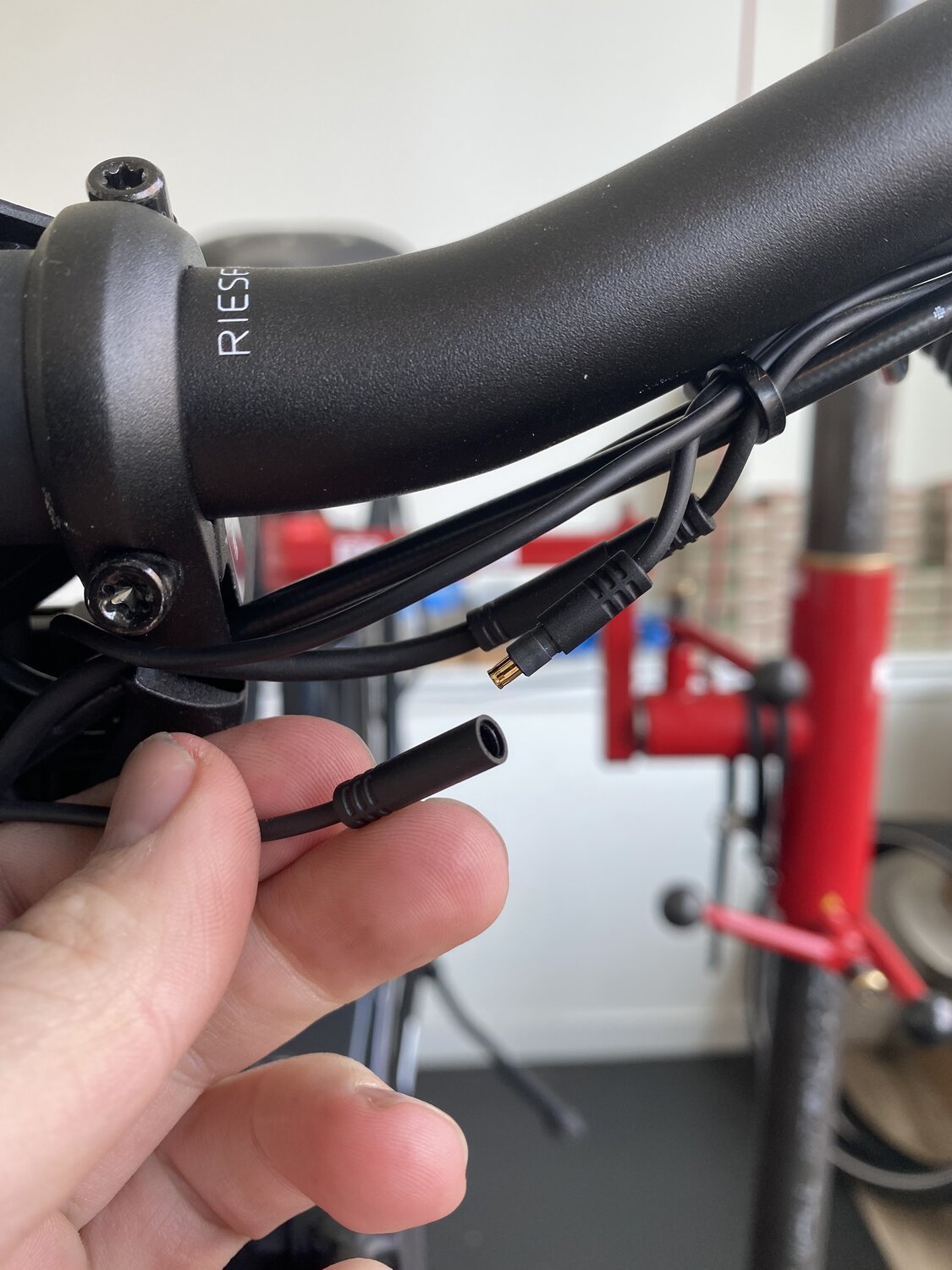

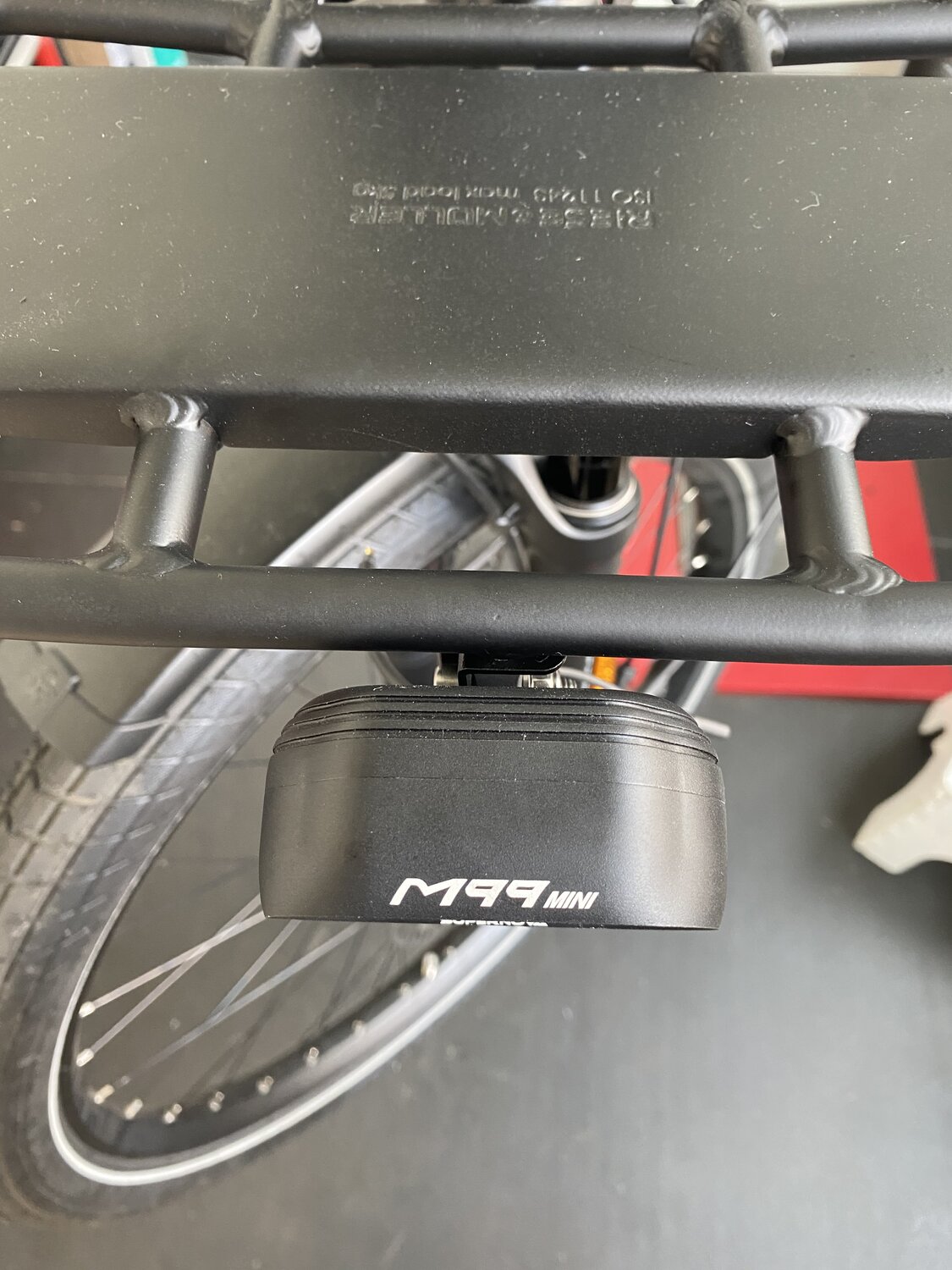

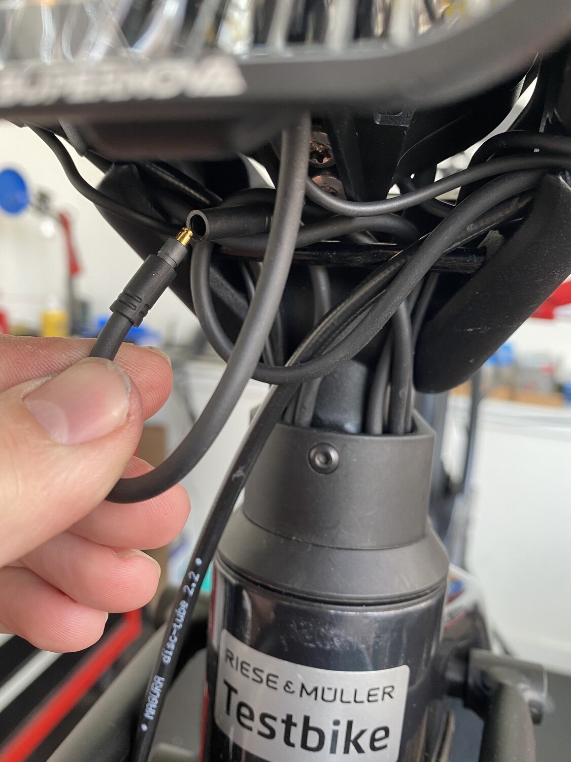

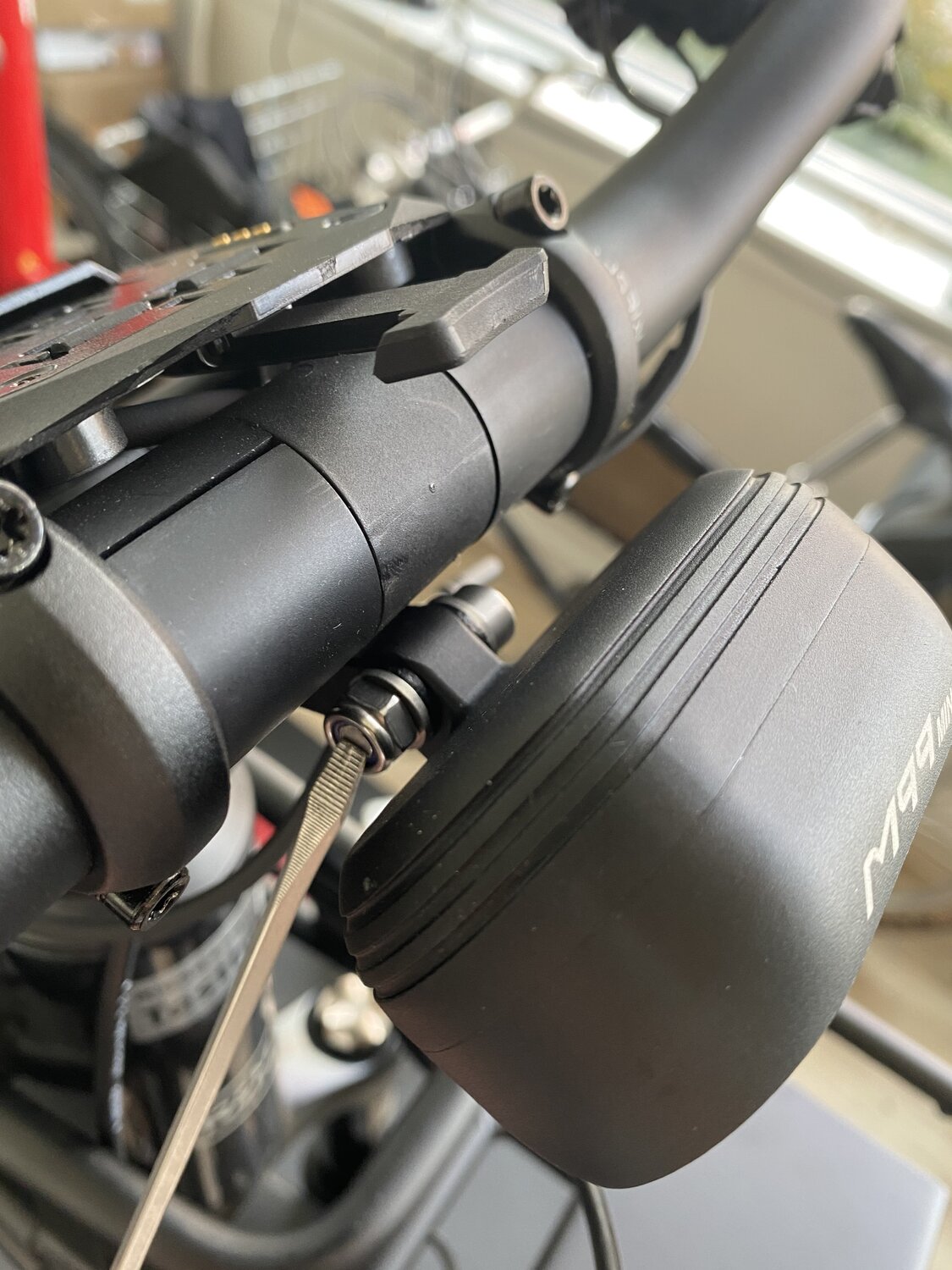

Below are the directions for relocating the headlight from the handlebars to the underside of the Front Carrier. The bike we used is a 2021 Homage GT Rohloff HS with the Comfort Package and the Nyon Cockpit set to the highest angle that the cables would allow.

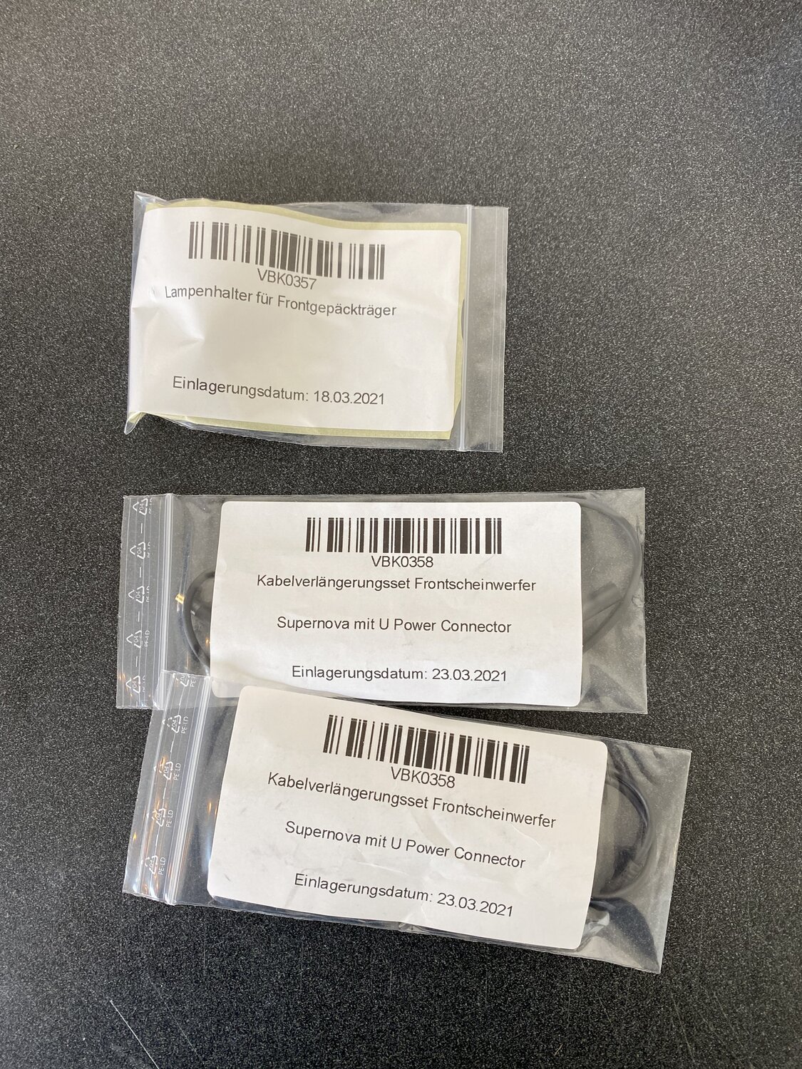

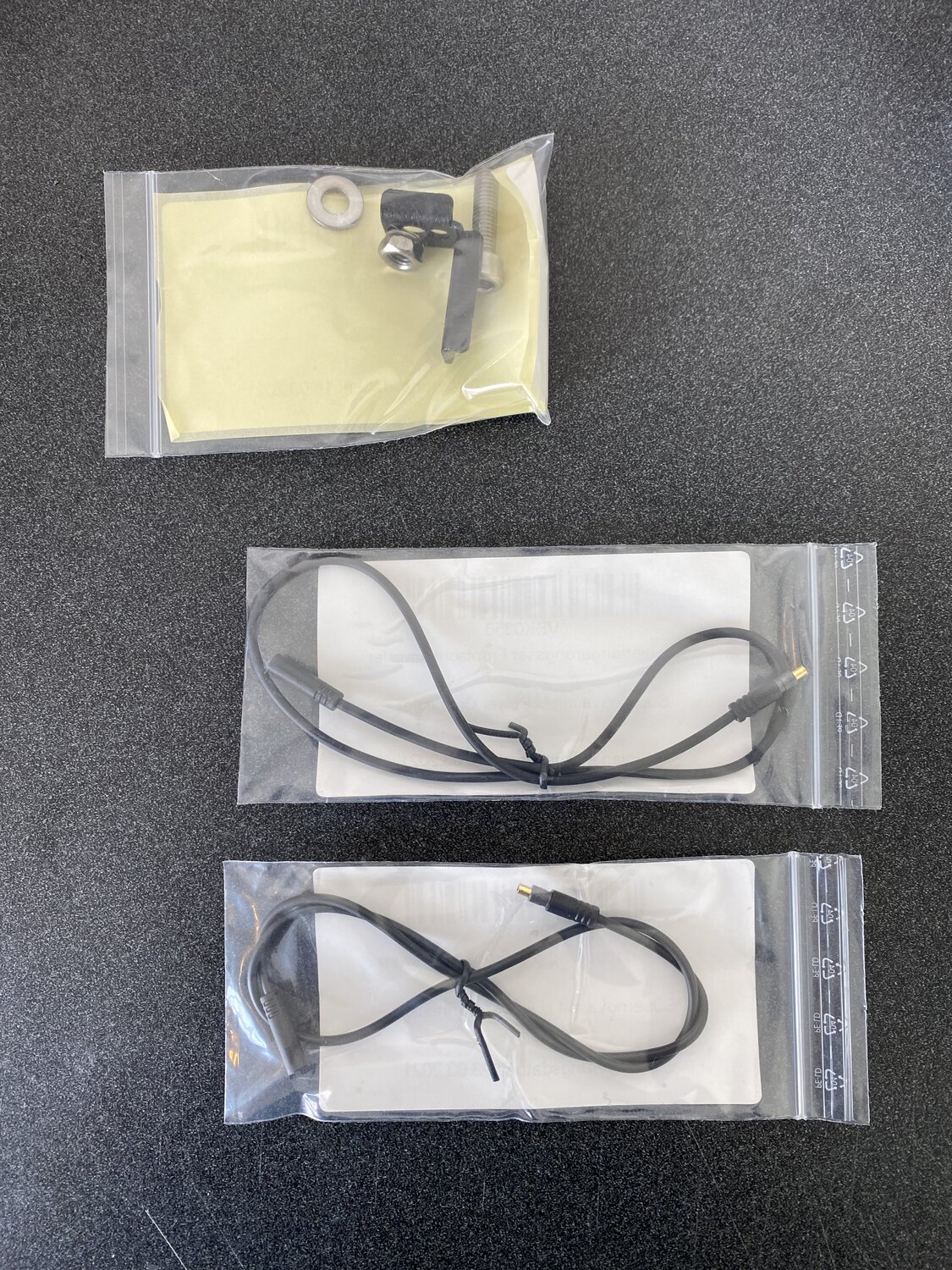

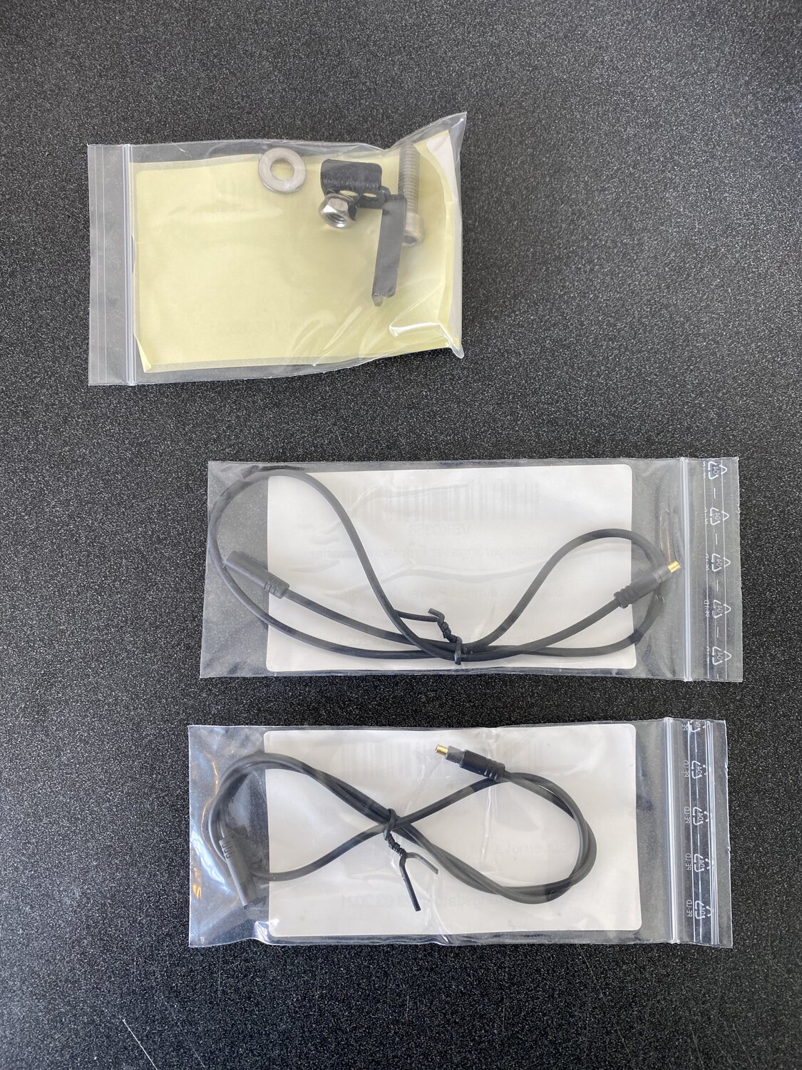

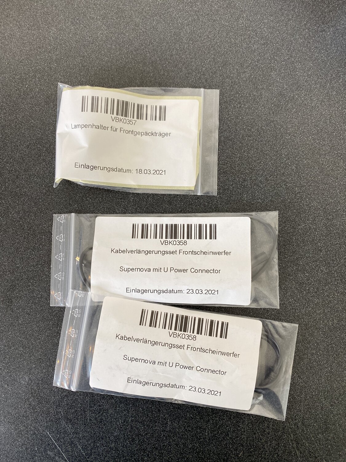

The parts required are Light Bracket for Front Carrier (VBK0357) and Cable Extension Set for Front Light w/ U Power Connector (VBK0358) Note you will need two Cable Extensions if you have high-beams.

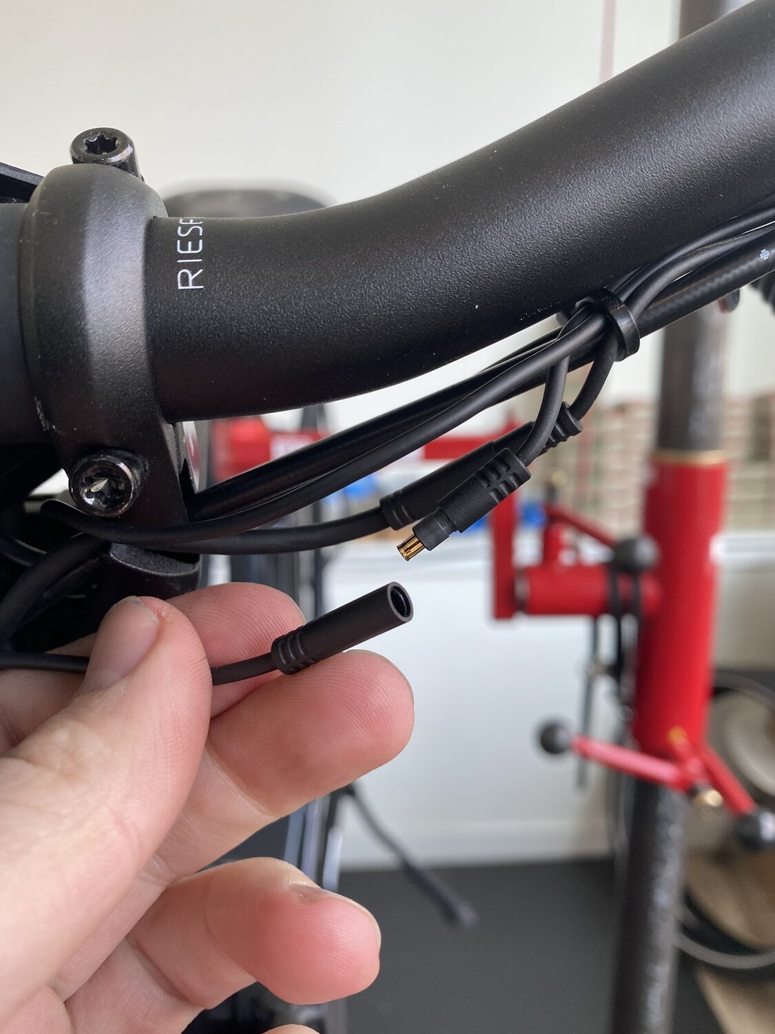

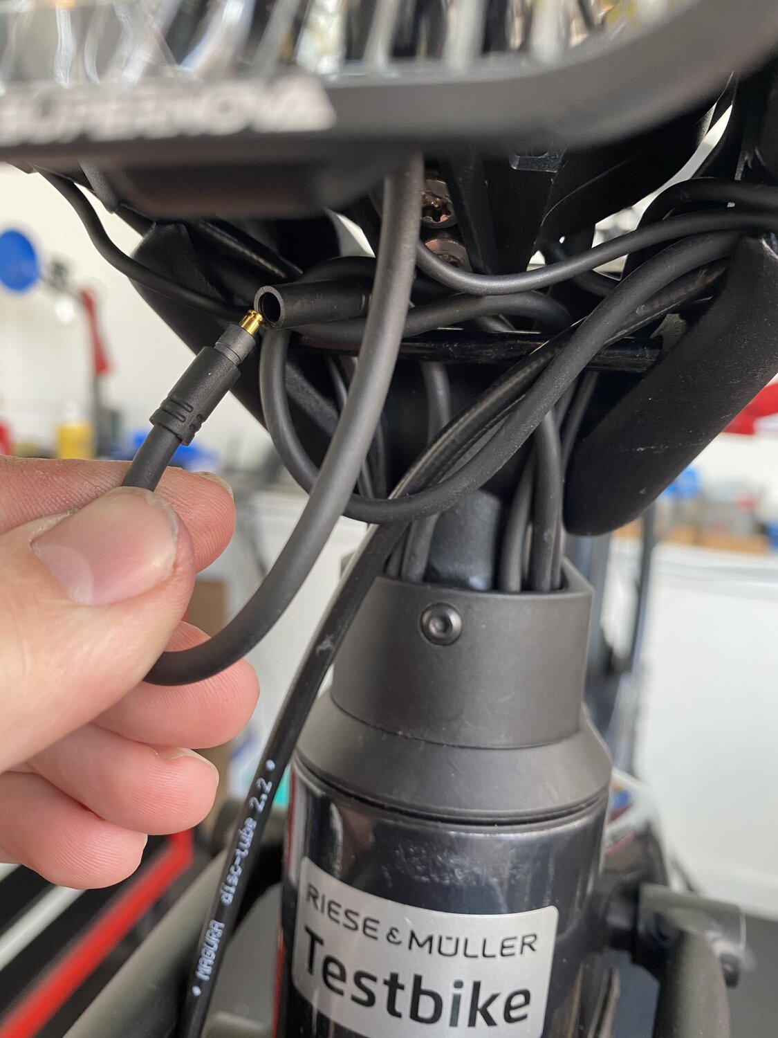

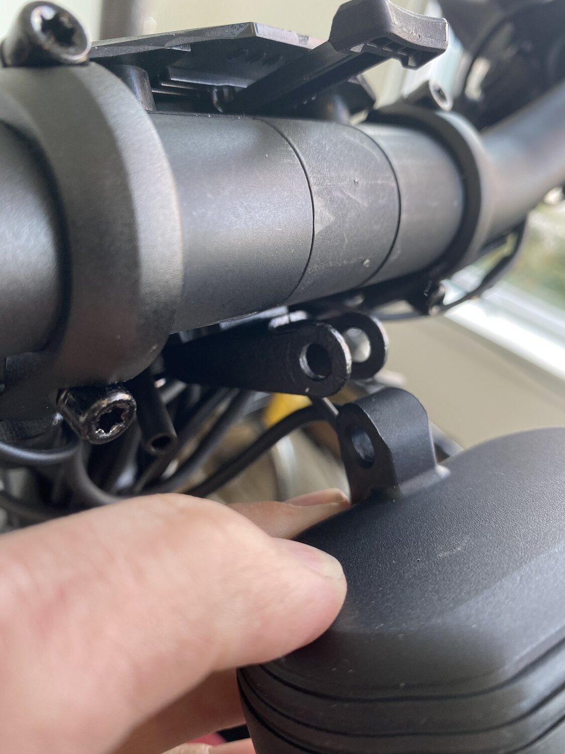

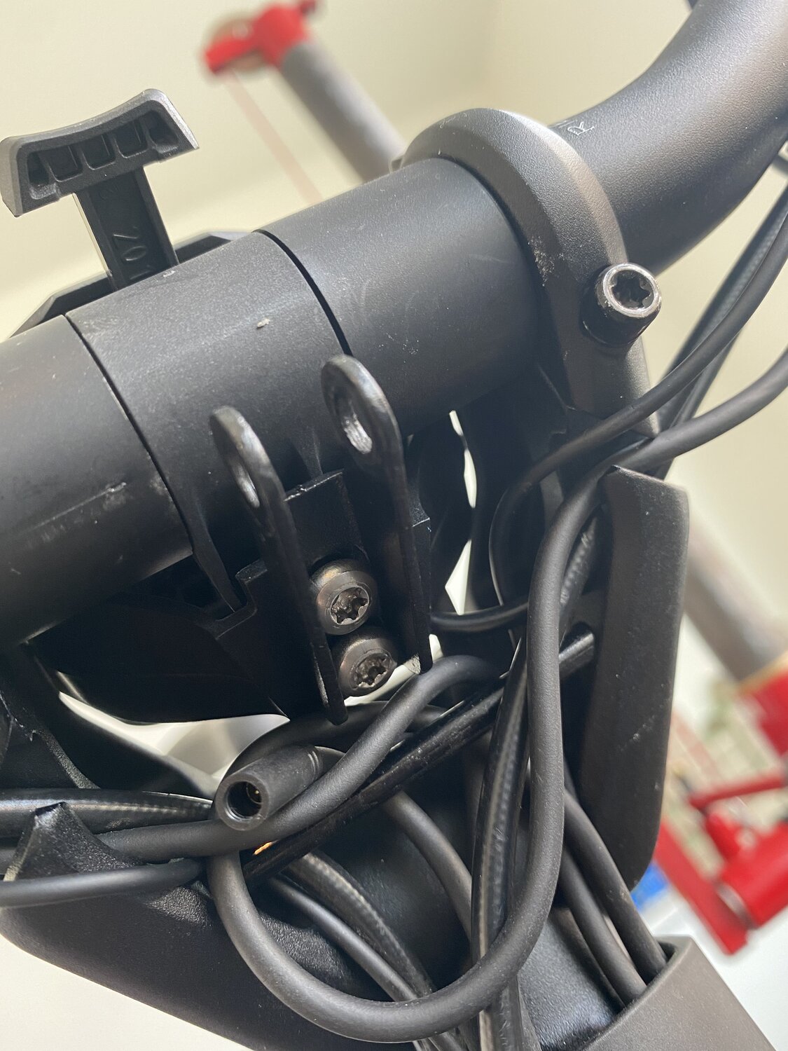

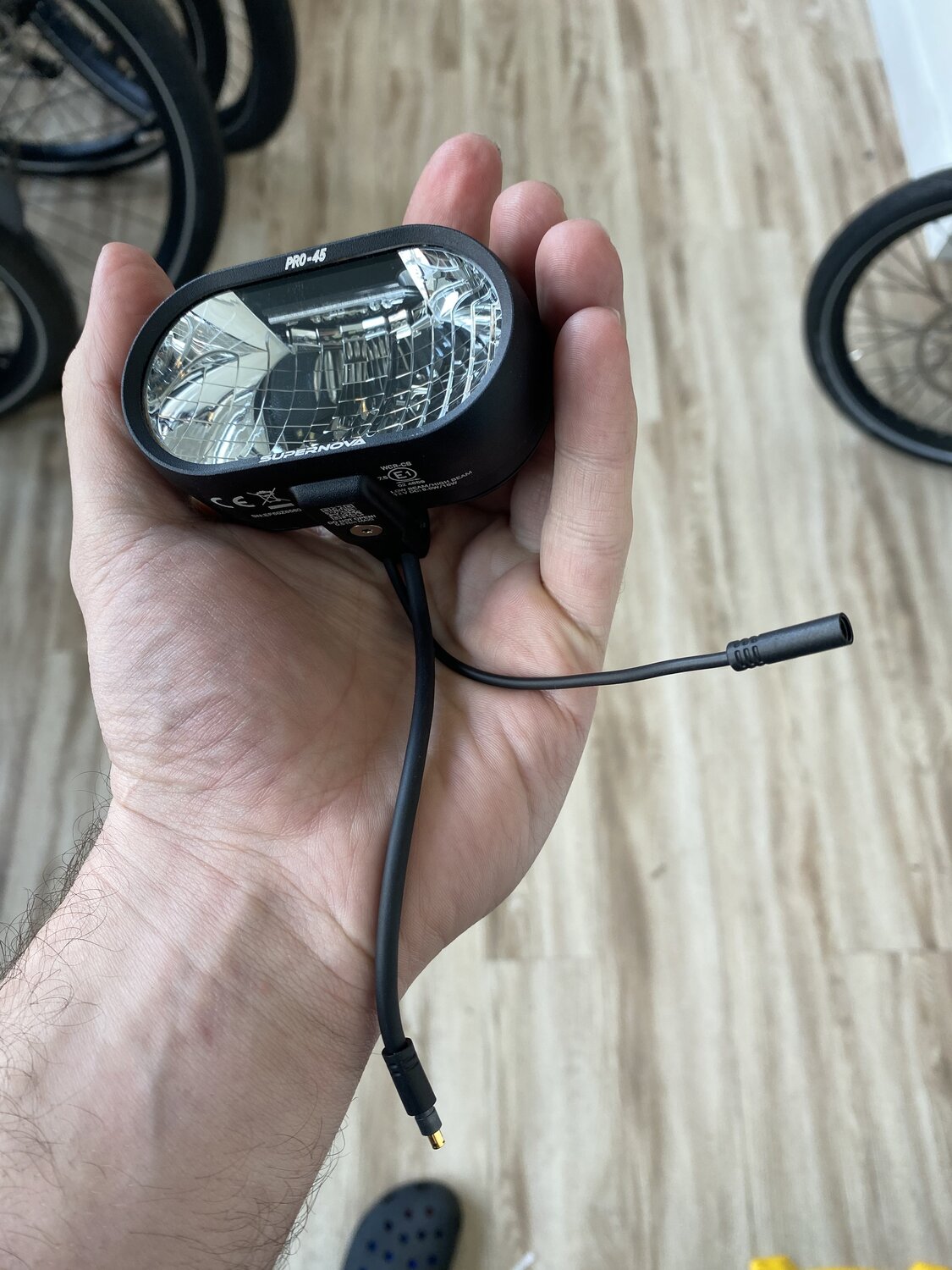

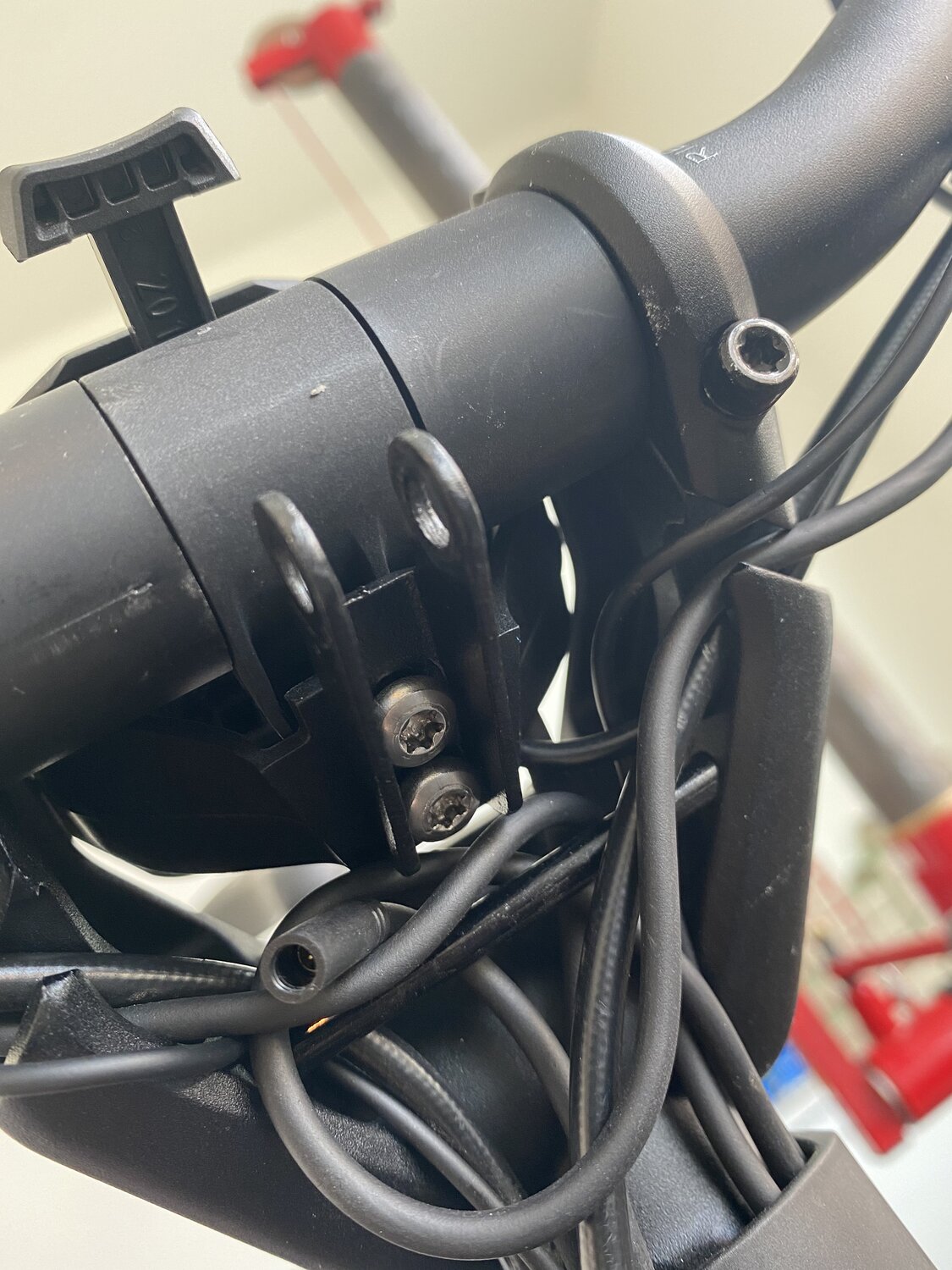

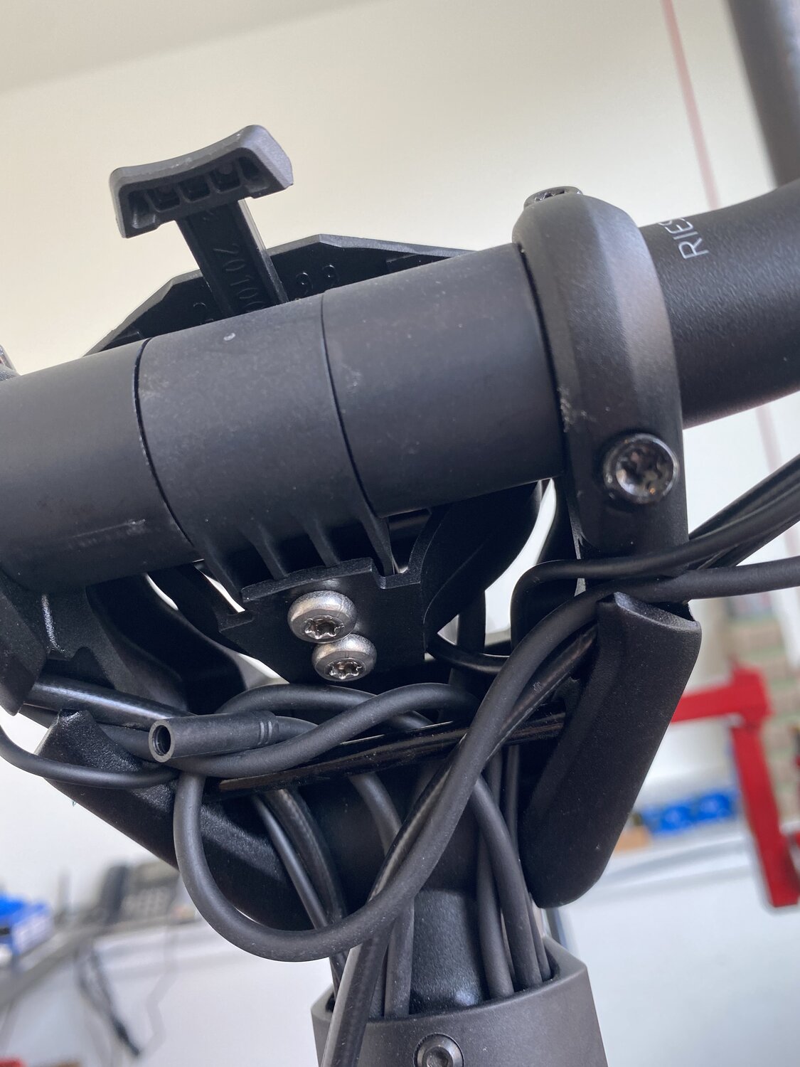

1. Start by disconnecting the headlight power cable connector and high-beam button connector.

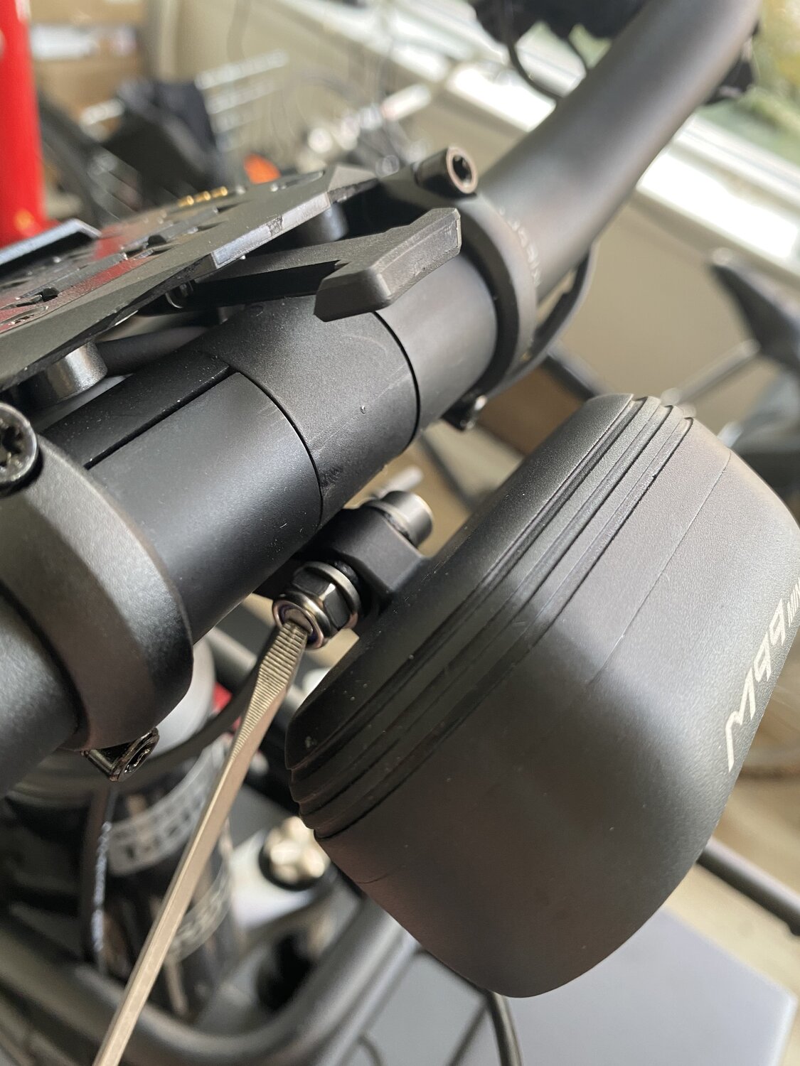

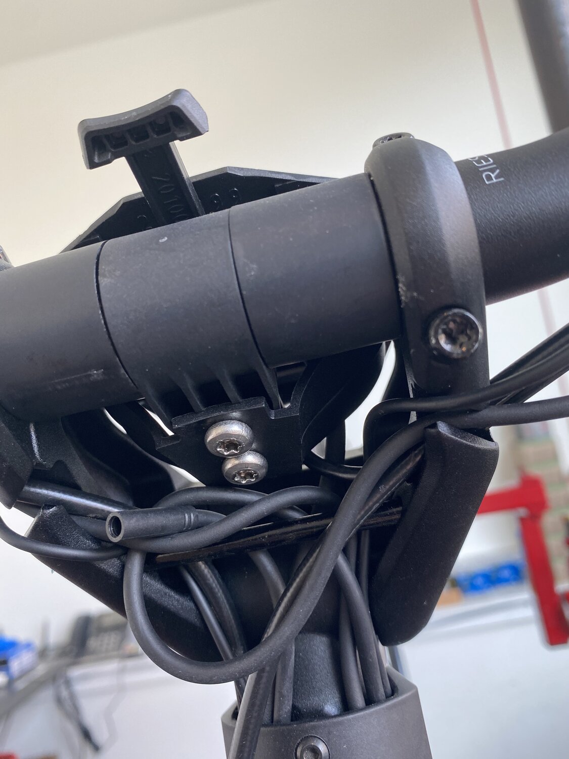

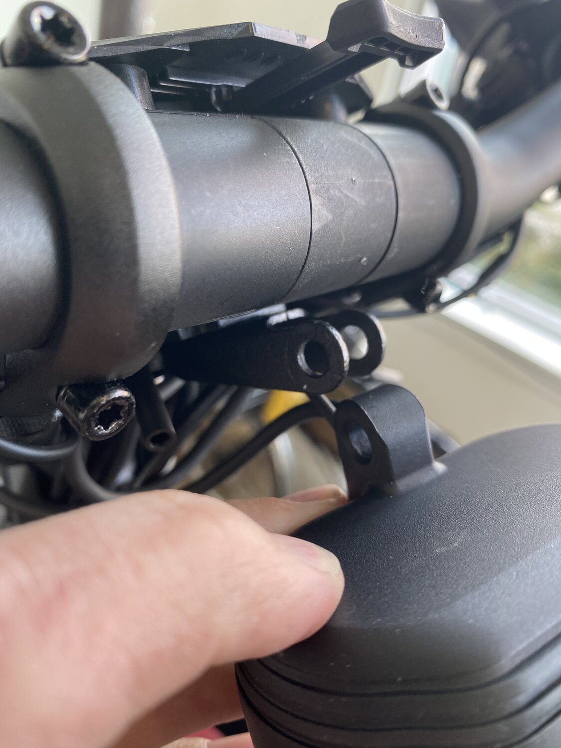

2. Next remove the headlight from the light bracket and remove the light bracket.

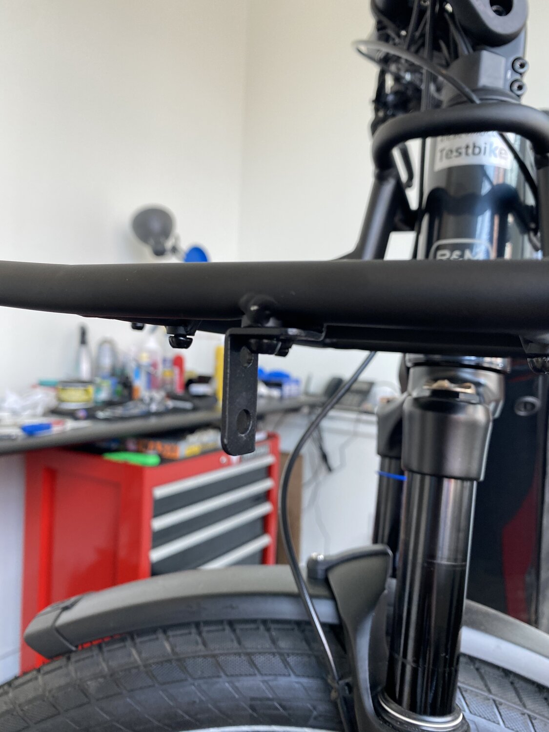

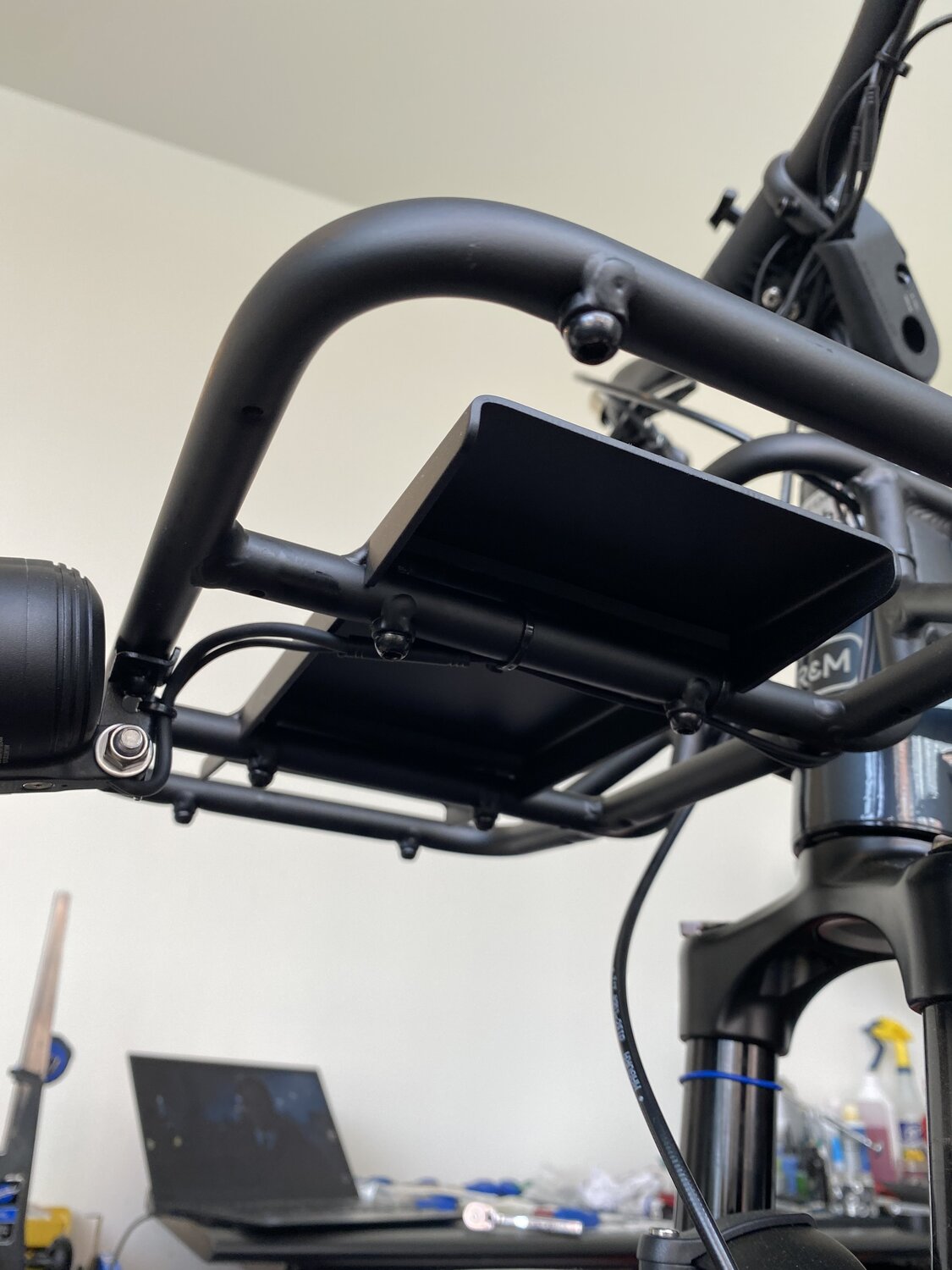

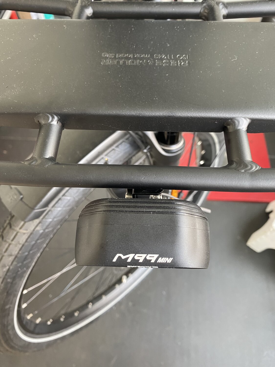

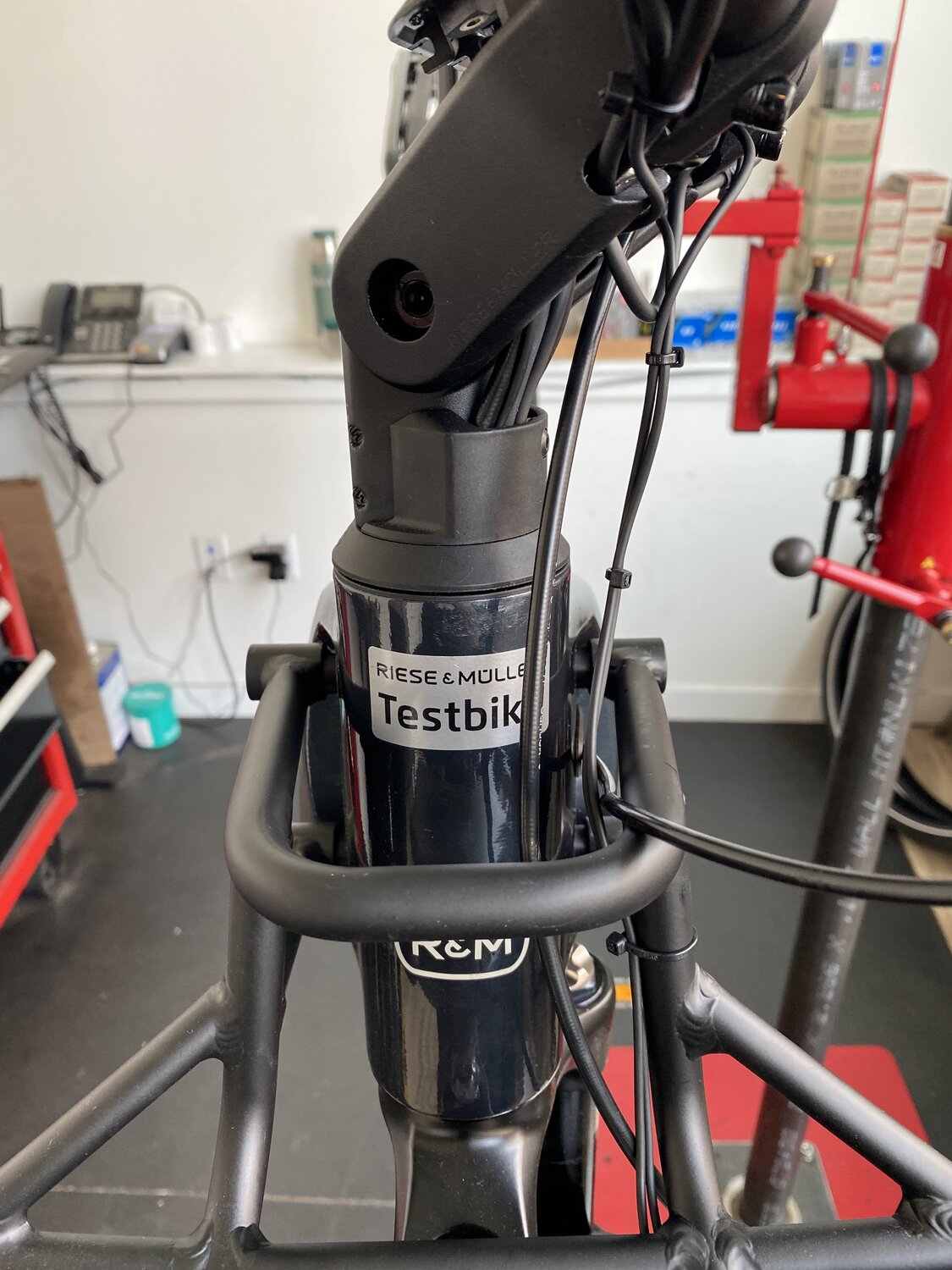

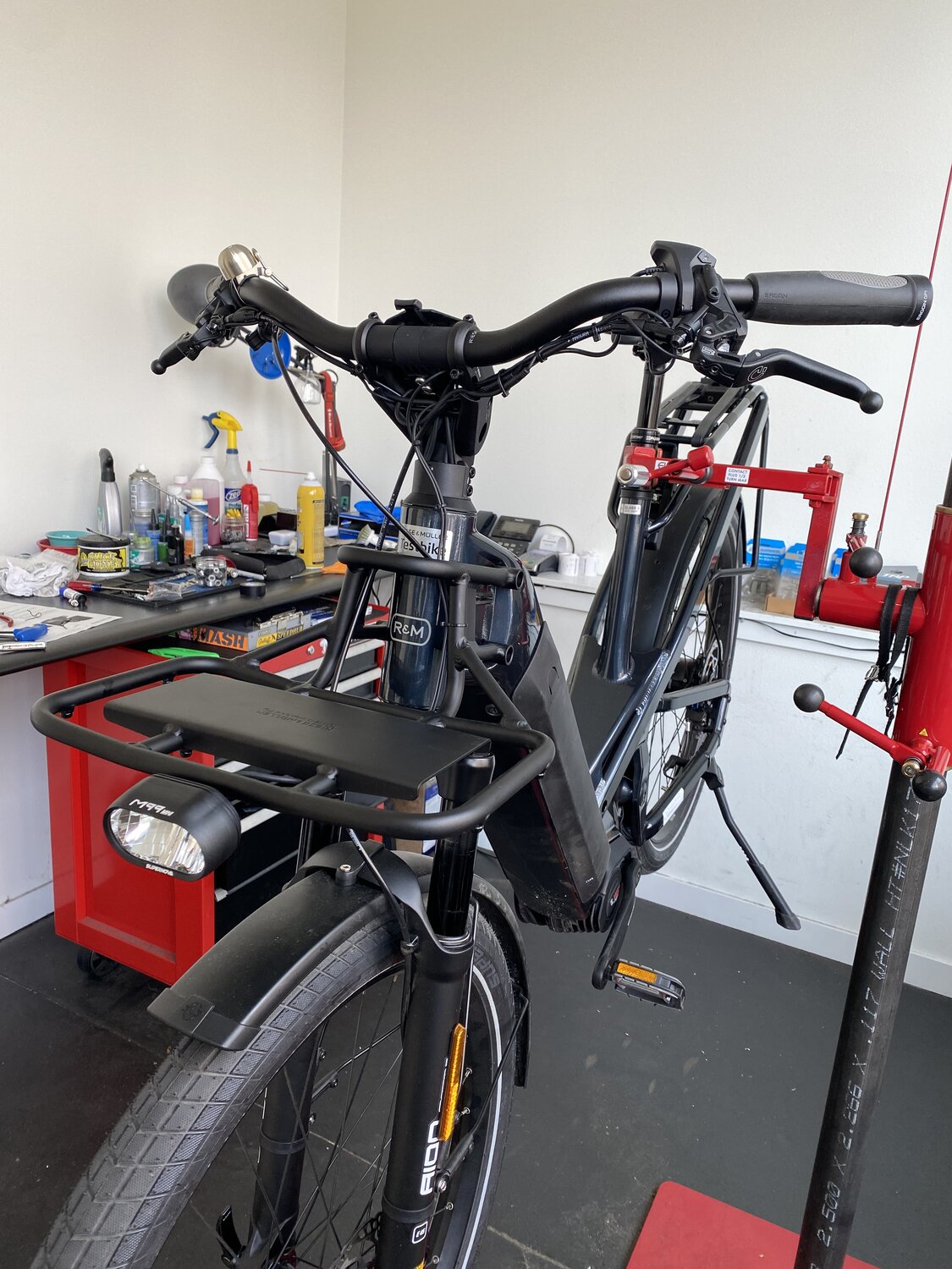

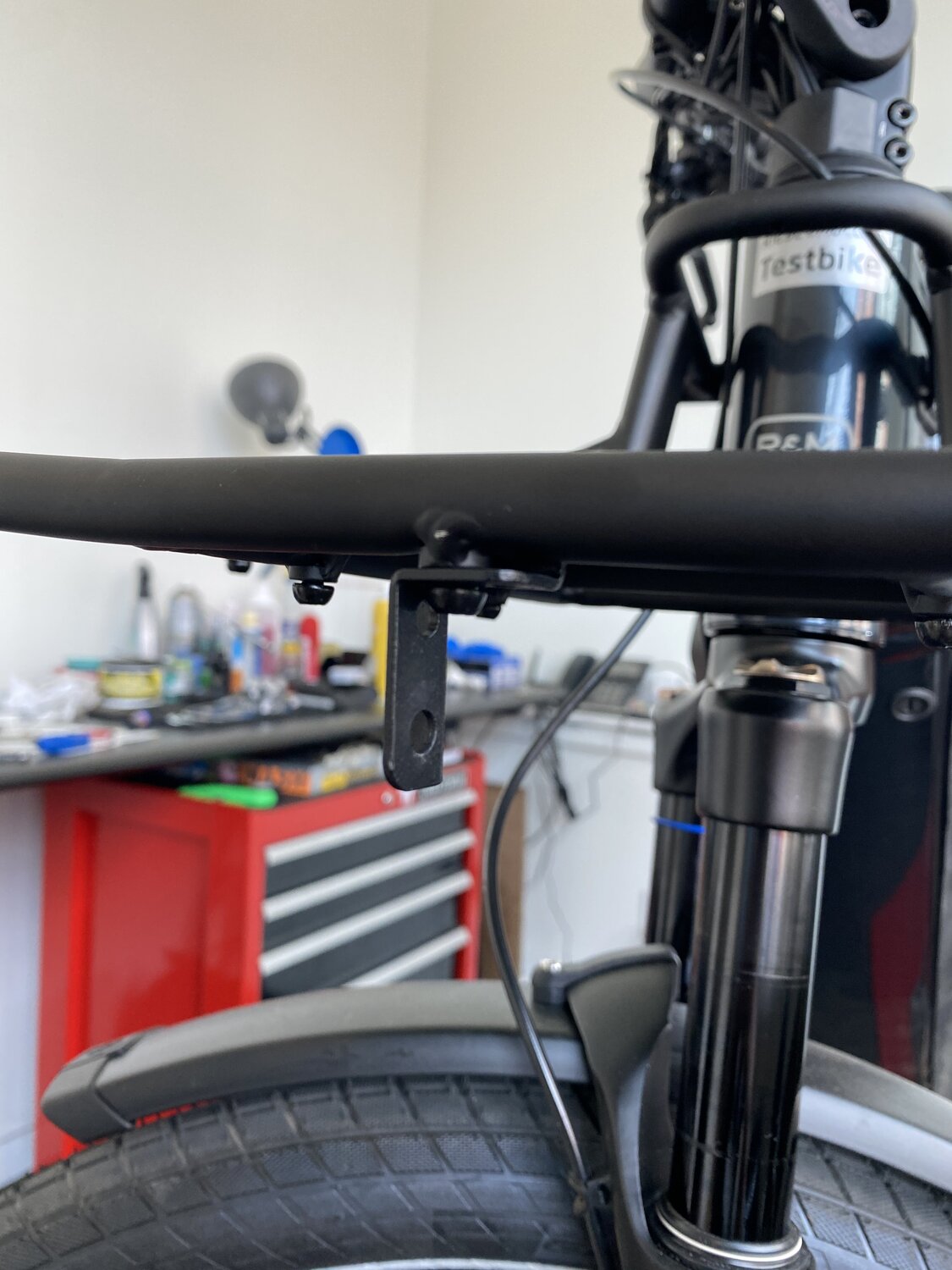

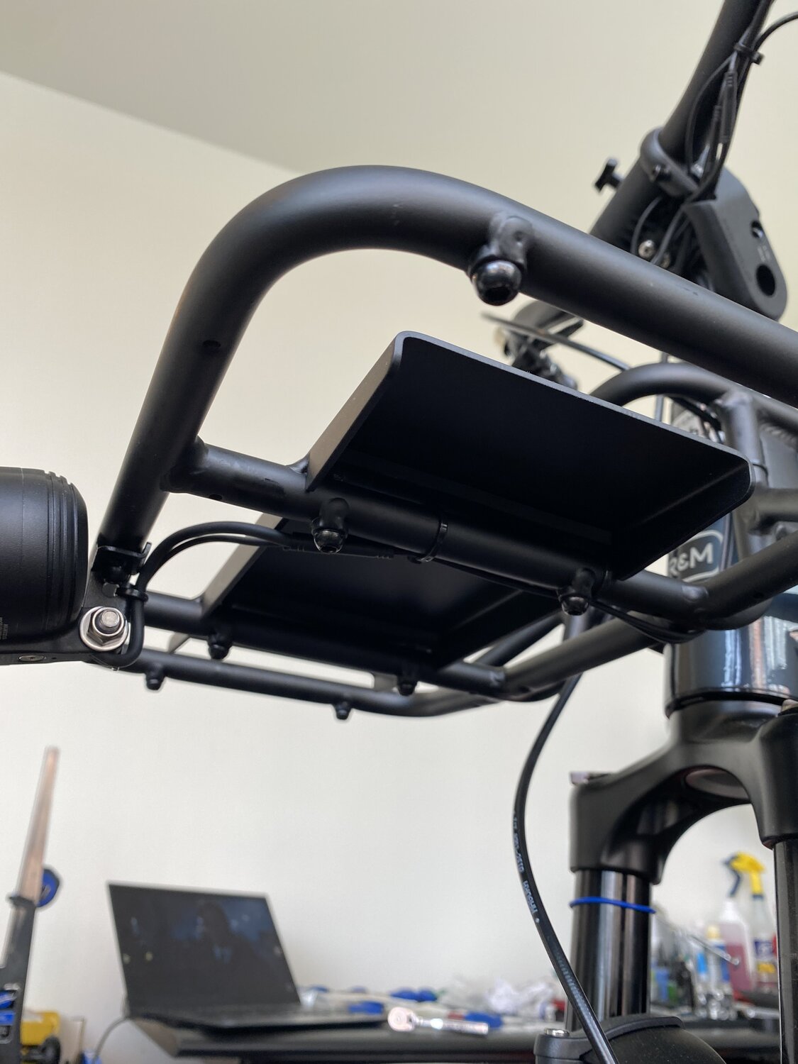

3. Mount the new Front Carrier bracket to the middle eyelet on underside of the Front Carrier and mount the headlight to this new bracket, checking that it is centered.

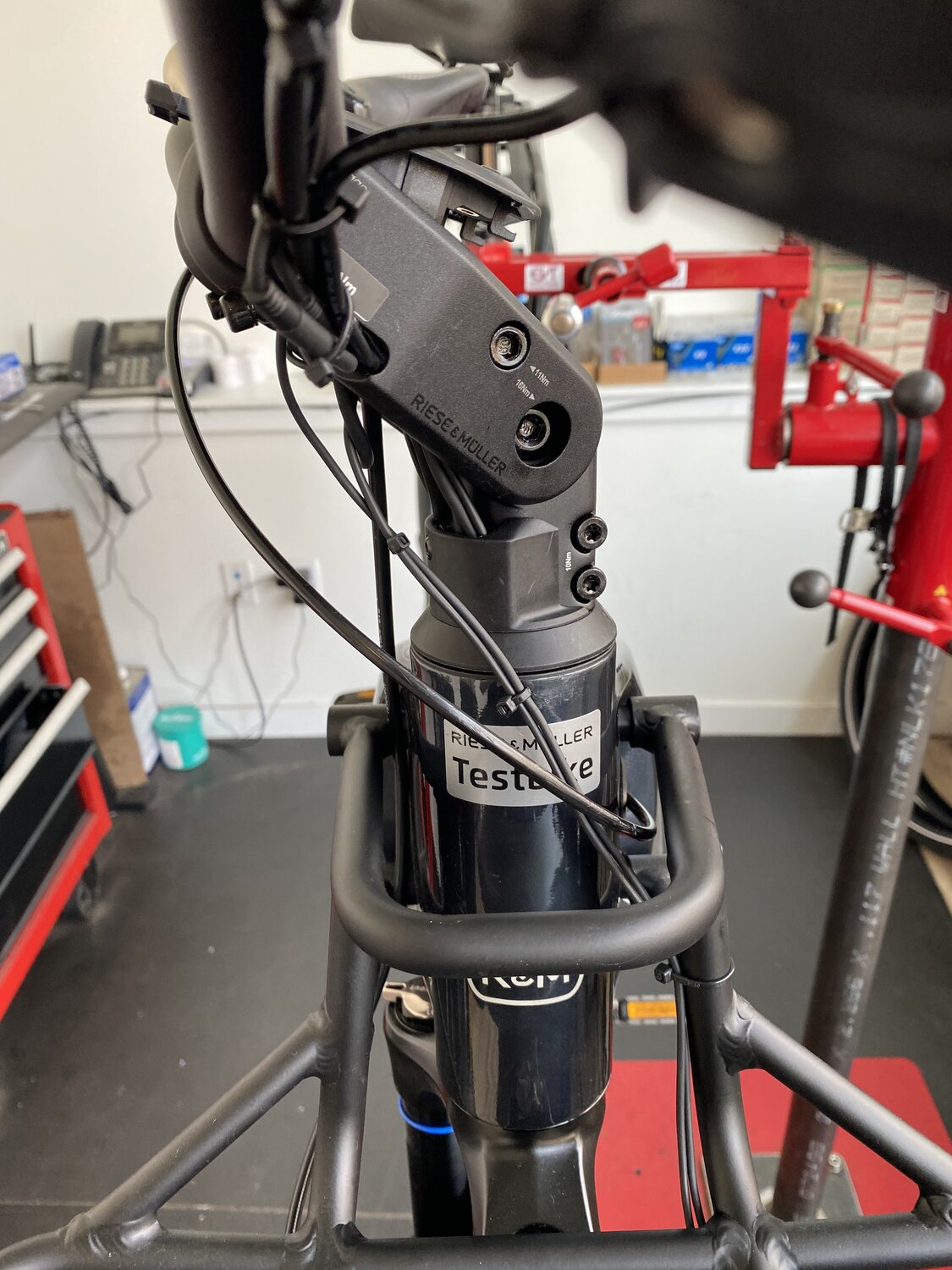

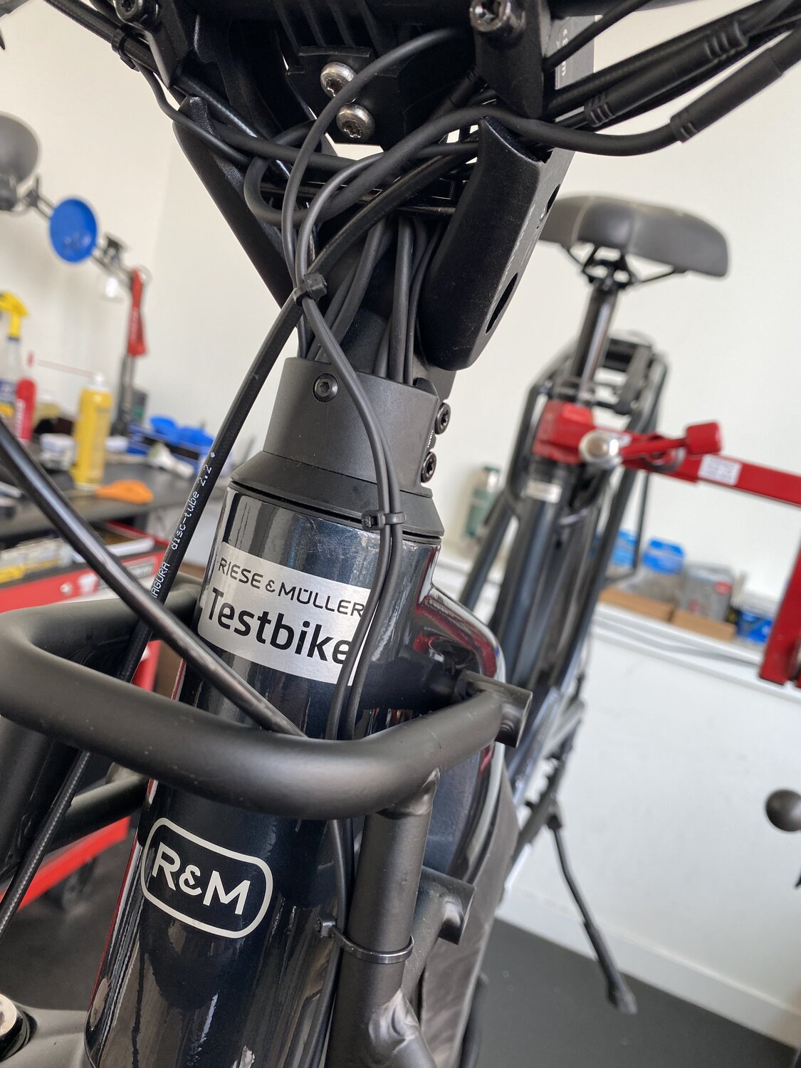

4. Install the Cable Extensions.

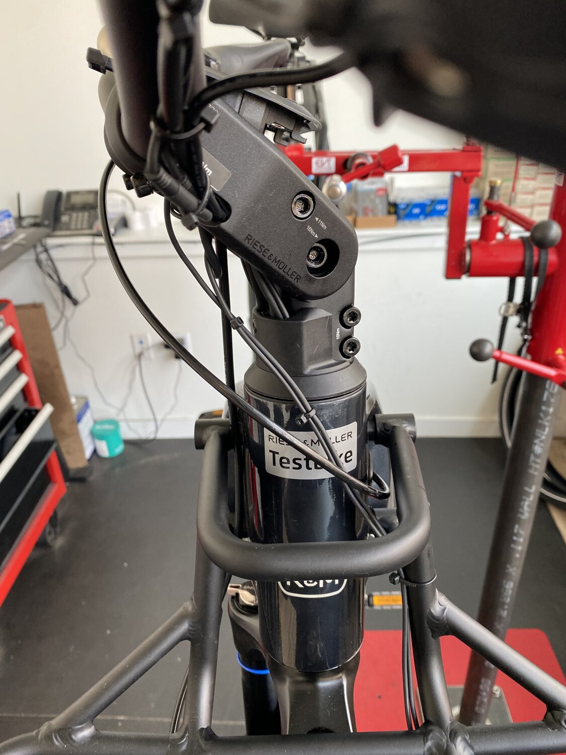

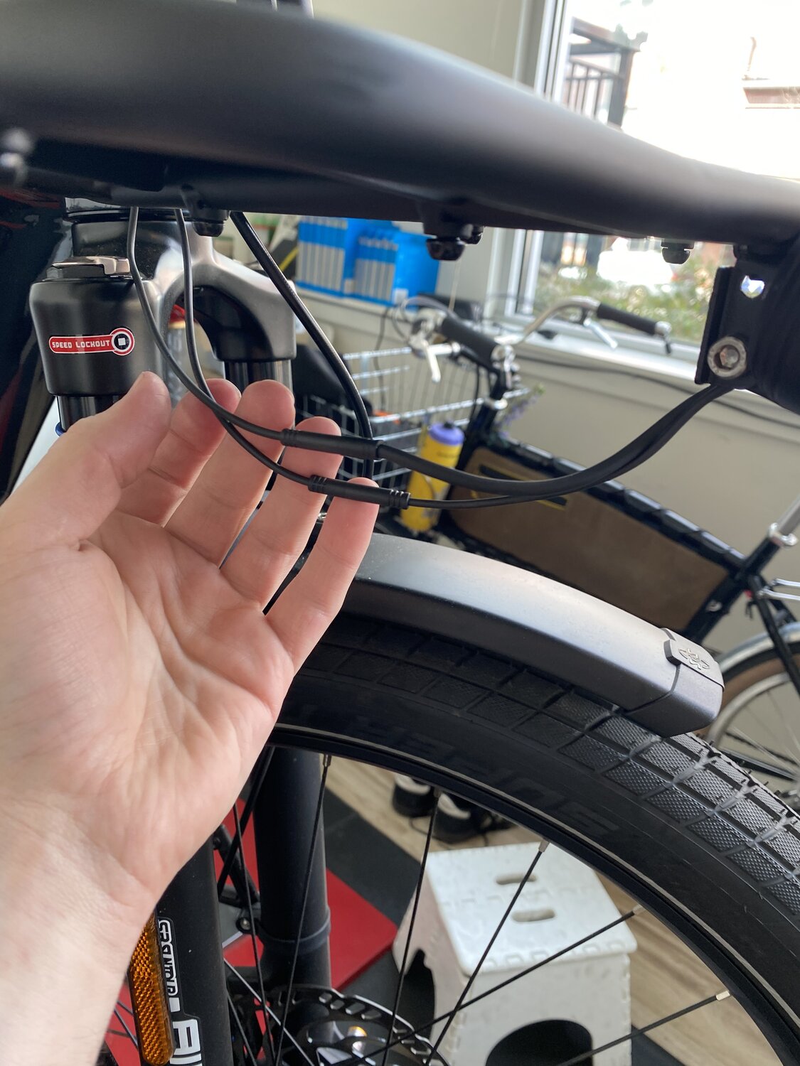

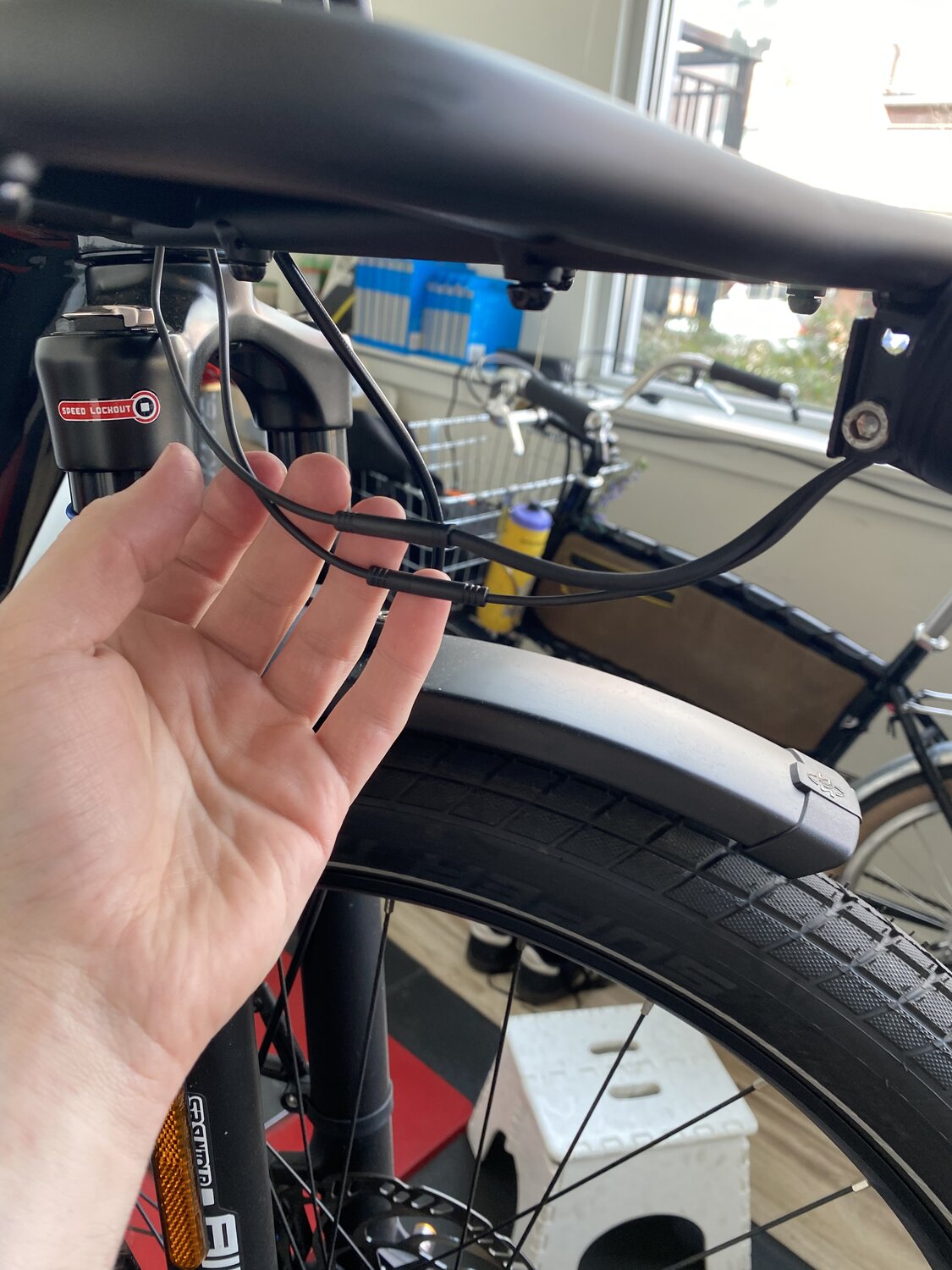

5. Attach the Cable Extensions to the underside of the Front Carrier using zip ties. Our high-beams button was on the left side of the handlebar, and we found that running the Extensions along the same side of the Carrier was required for there to be enough slack to turn the handlebars in either direction without putting stress on the cables.
6. Done!
I hope you all found this helpful! Feel free to post any questions about the process.
