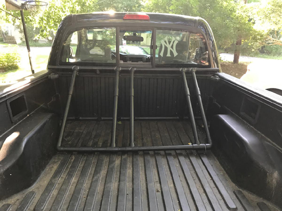

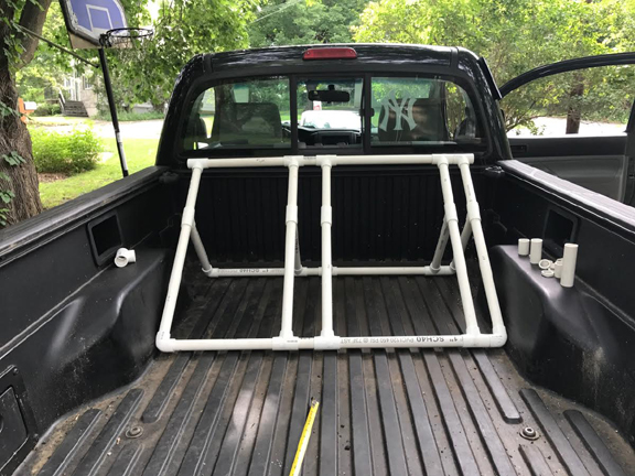

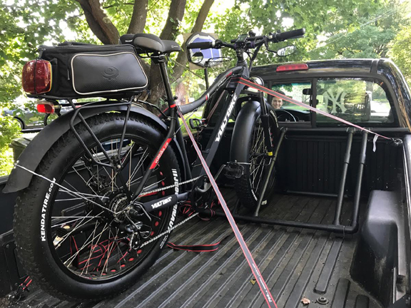

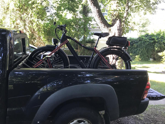

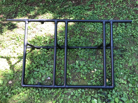

I searched online and found several different DIY setups. This is what I went with. Space enough for 2 Bikes, the Yukon and the Colt that is enroute. Total cost $70 including paint.

Wow. On your Voltbike, that is quite the tail light you have there! How is it powered?
Hey Denis, glad you like my rig there:) That tail light is available at Larson electronics online. It is powered by AA batteries. It stays on steady red or seizure inducing flashes. It is also cheap.
http://www.larsonelectronics.com/p-635-.aspx
Somebody on the trail told me that if he rear ended me it would definitely be his fault. Lol.
Just an update. Went for a trailride today with my son and both bikes in the new rack. With the use of the separator rods the bikes felt like they were part of the truck. No wobbling or shifting around. The tailgate firmly up against both rear wheels, the front wheels cinched into the rack, separator bars in place and lashed to the bikes with braided parachute cord at the seatposts and up behind the handlebars. When the tension straps got cinched in position it felt extremely sturdy. I still drive it very conservatively (to my 17 year old's chagrin) because I don't want to unnecessarily take chances with my favorite toys, but I felt pretty confident driving with them.
