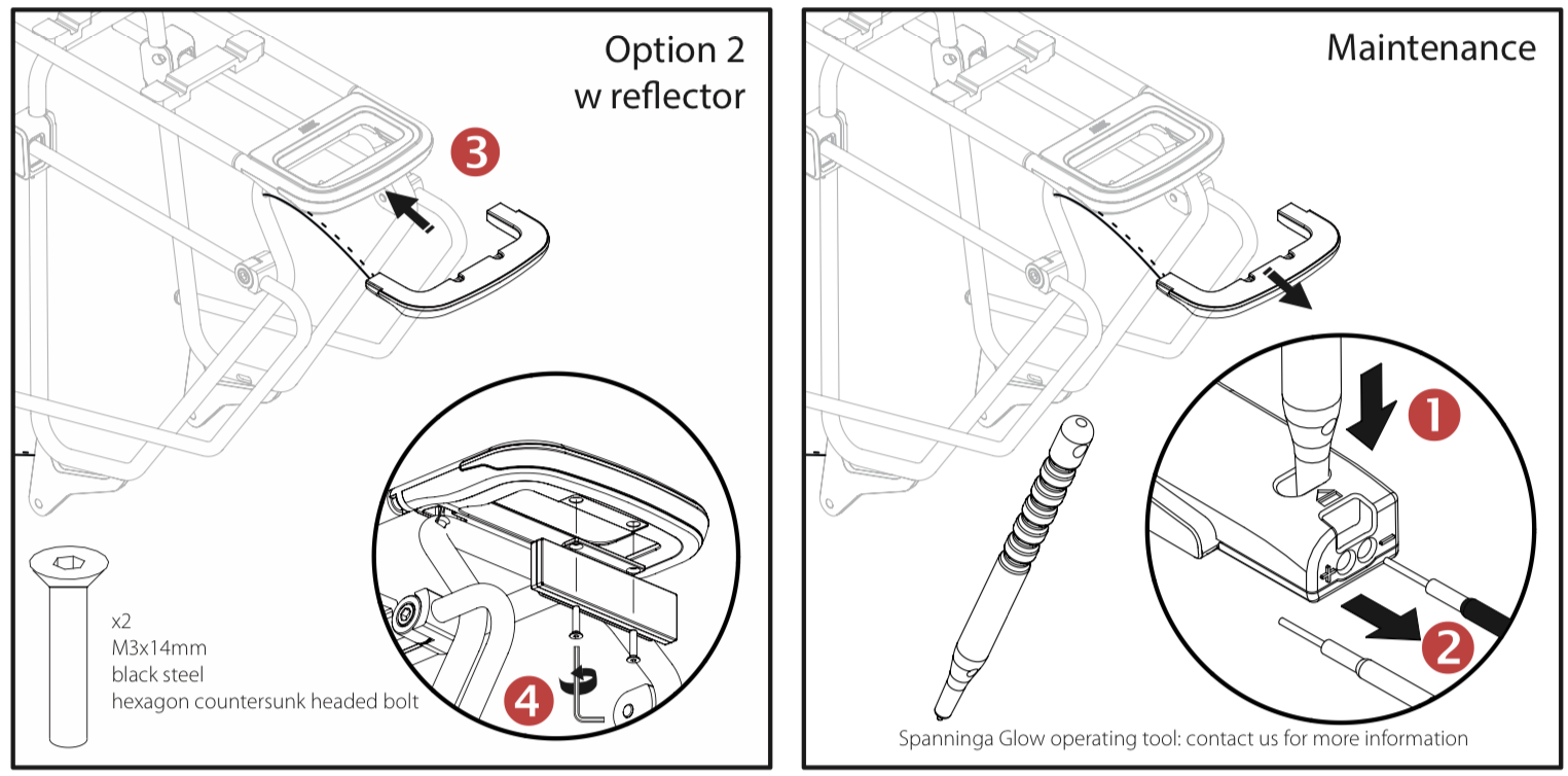

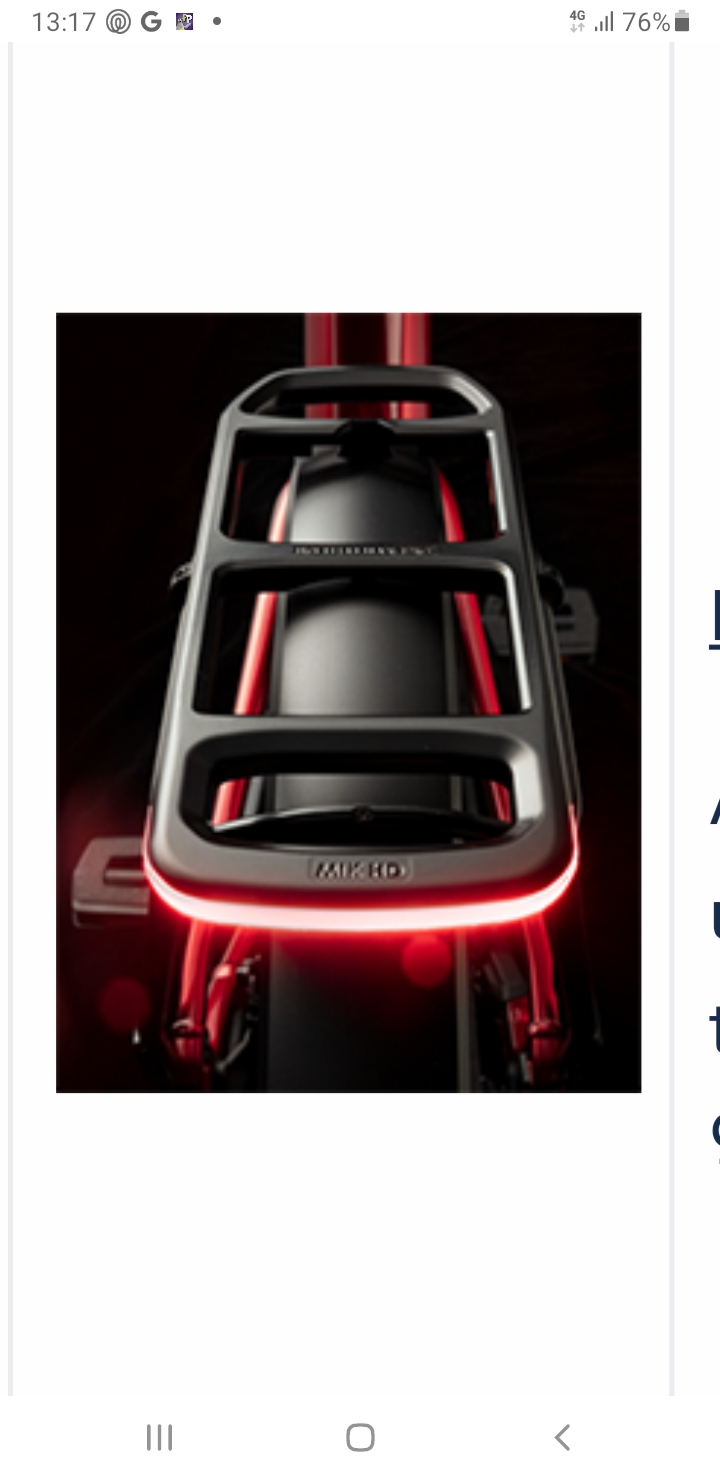

Can anyone tell me how to remove the light part please
Light is held in place by the two screws that attach the reflector bracket (varia bracket on a 5.0) to the rack.
You’ll probably need to remove the rear wheel and fender to get to the plate which holds the wire to the channel in the bottom of the rack in order to have enough slack to pull the light out.
