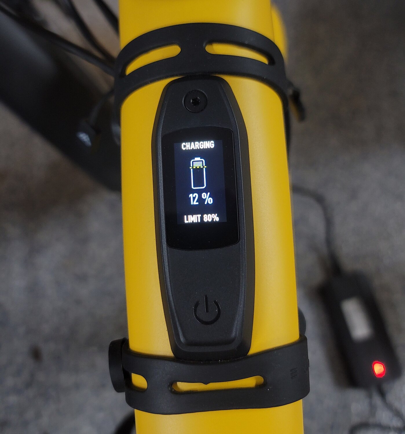

Well aware of the 20-80% state of charge recommended for Li ion batteries from my first ebike (960 Wh). Initially thought that the SL's 320 Wh was too small for that luxury, but range is turning out to be WAY better than expected.
So I'm trying that 80% charging limit in the app tonight. We'll see how it goes. Nice touch to show that the limit's in effect on the TCU.

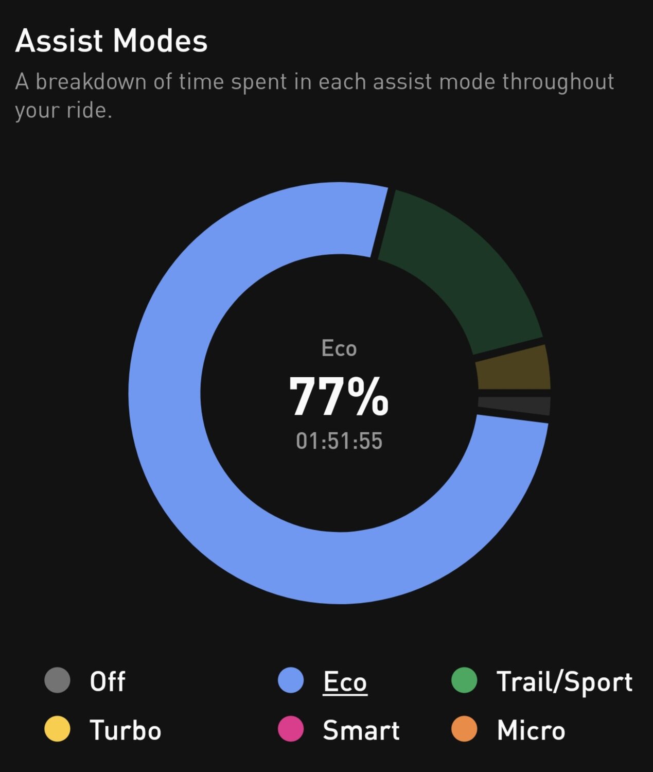

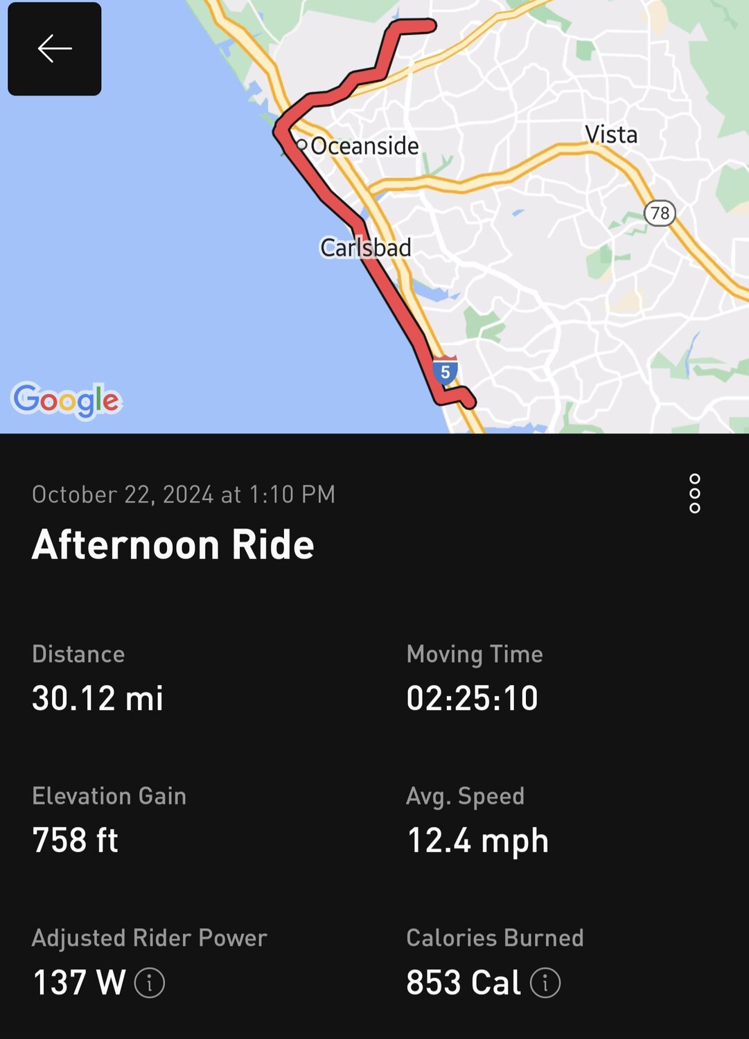

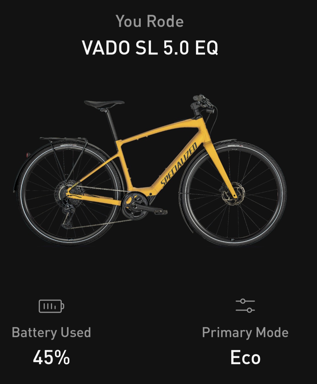

Tuesday's 30-mile ride up the coast and along the lower San Luis Rey River was instructive in this regard.
Only 45% battery used on this flattish ride done mostly in ECO. This can only mean one thing: No RE for the foreseeable future!

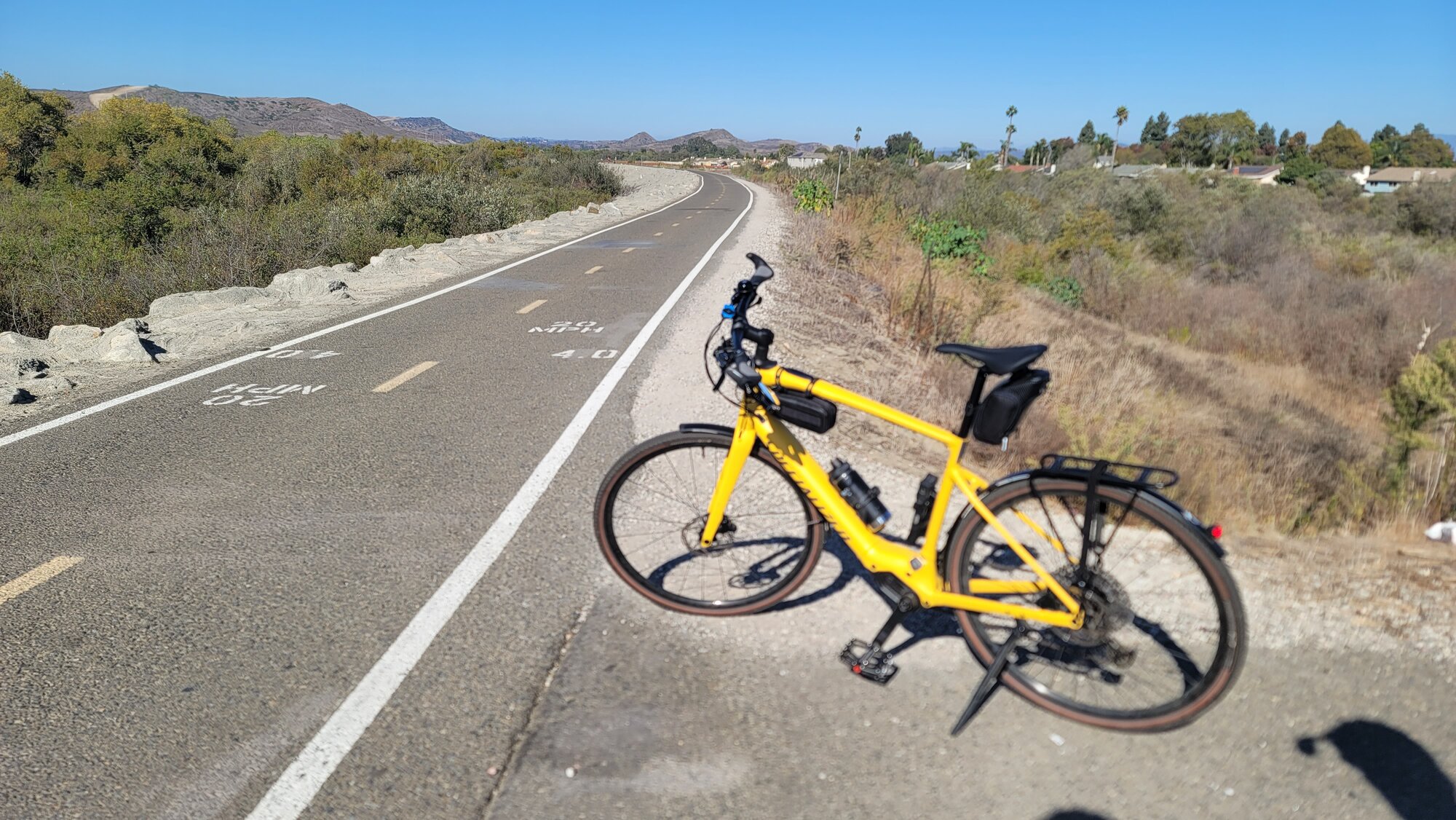

Will have more photos from the San Luis Rey Trail when we go back to ride a longer section next week. Very relaxing.

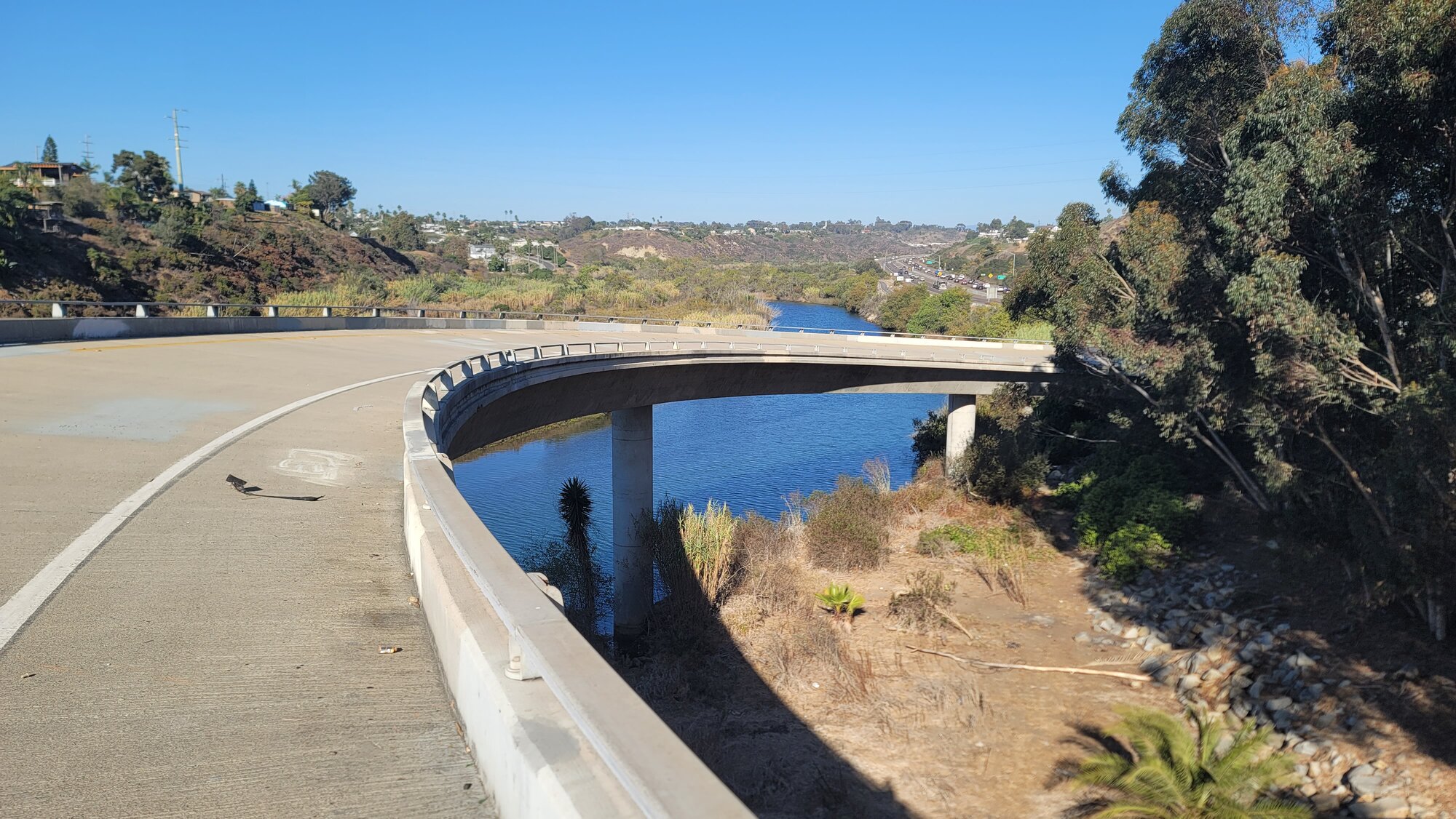

One odd highlight: An abandoned freeway ramp to nowhere leading up from the trail (off to the right) near the Oceanside end. For some reason, the ramp just dead-ends ~100 ft short of the San Diego Freeway. Looking east up the river here.

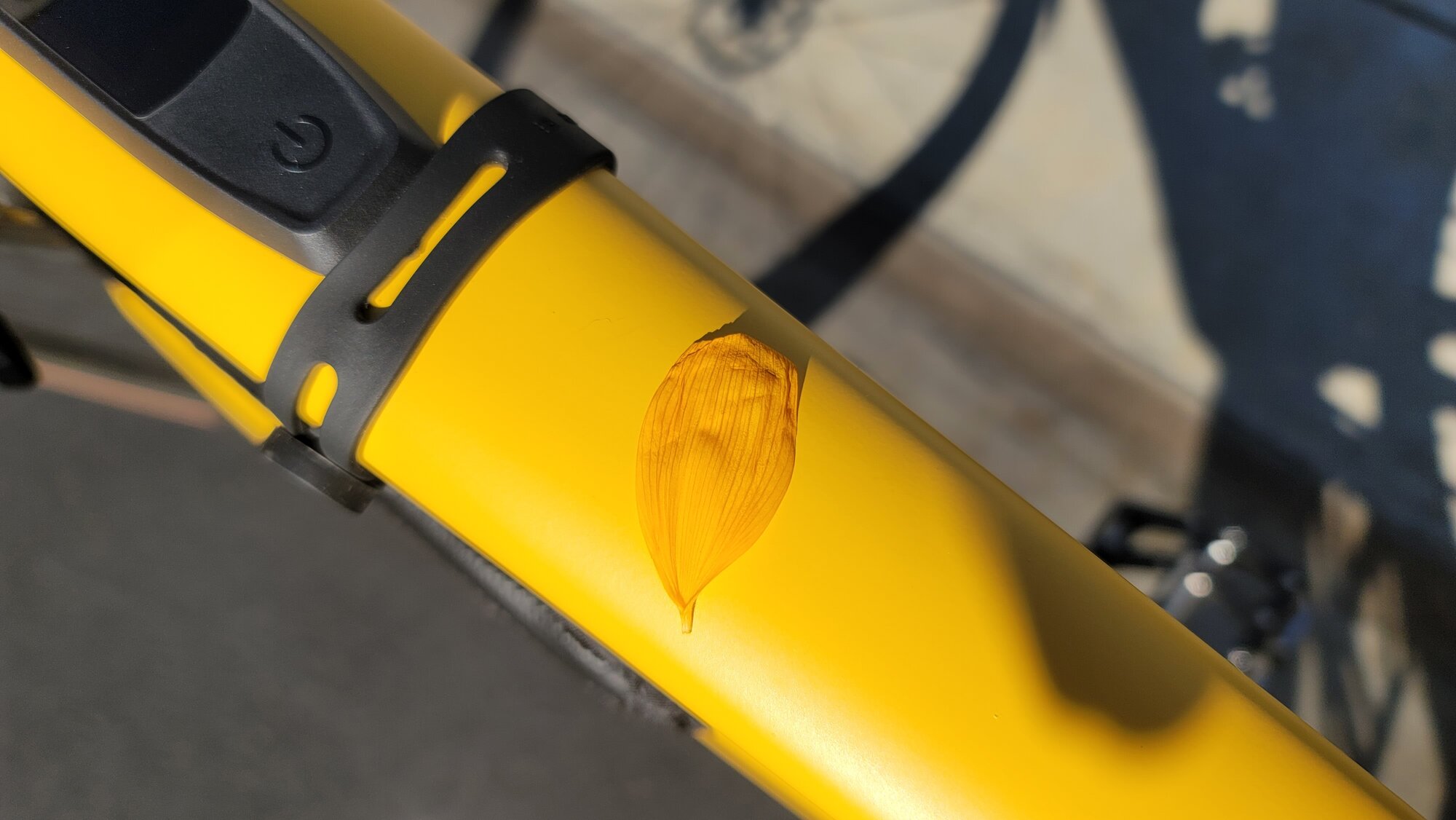

Gratuitous bike shot showing the difference between the SL's "Brassy Yellow" and the more golden yellow of a sunflower petal.
