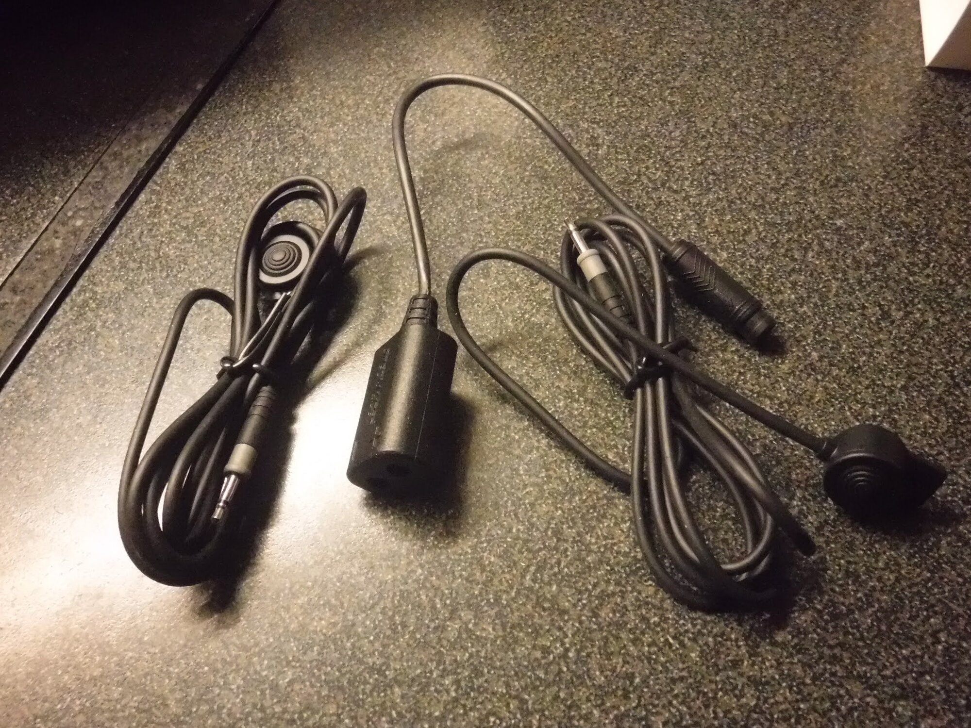

Also, is there a remote control for these bikes?

Yes, there are remotes for the Creo. Well, they are WIRED remotes. Don't have the part number but here's a picture
Mine are fitted under the tape near the stem. Others fit them near the hoods. There's a thread with a few pictures of locations. I had the bike shop install them while other did-it-yourself.
