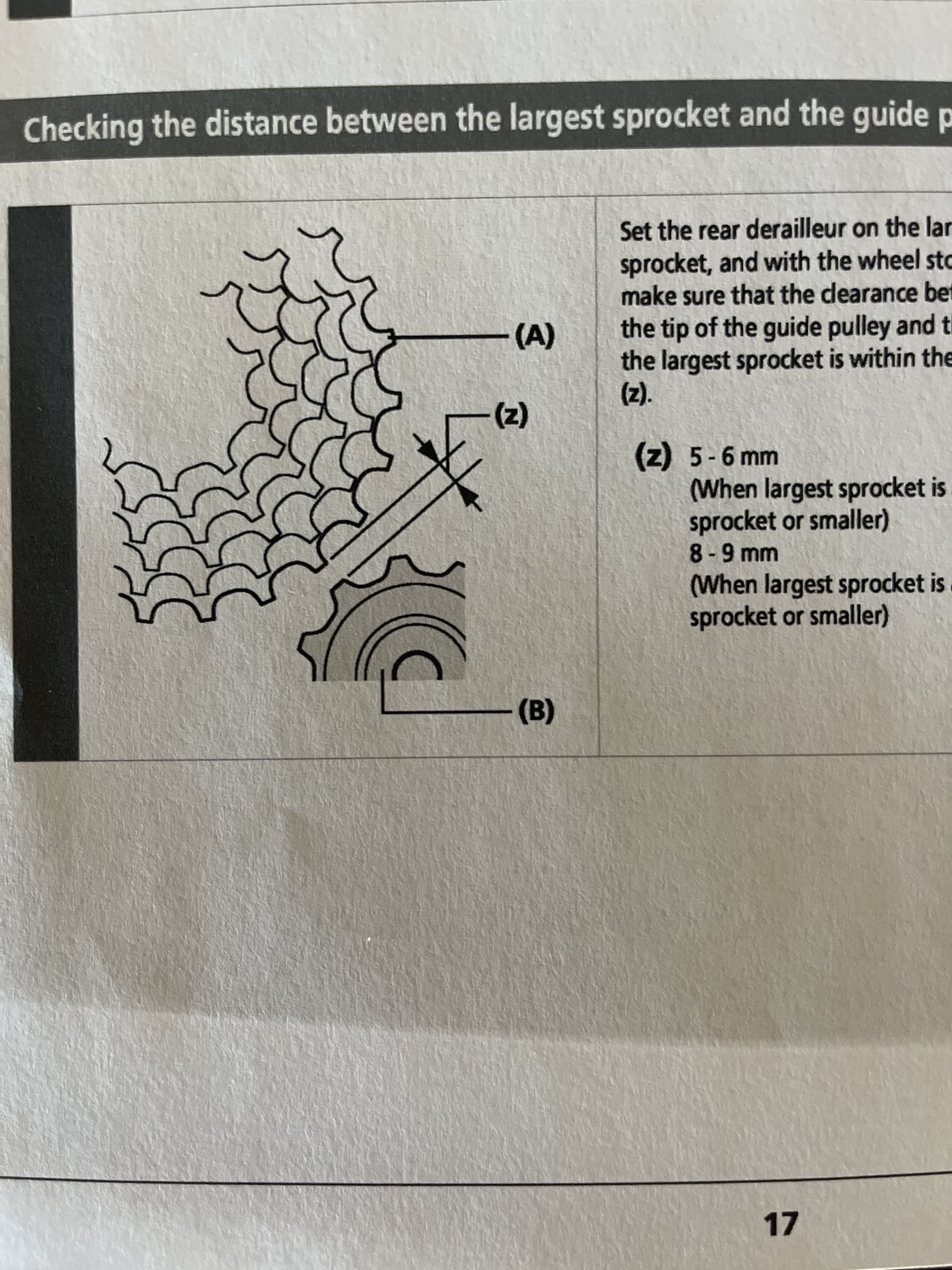

Next on my to-do list is to look at adjusting the 'B' screw. I know nothing about adjusting the derailleur, so a link to a good video would be helpful.
What really helped me more than the videos was the Shimano 8000 manual on the Shimano site. Very clear instructions on the adjustments.

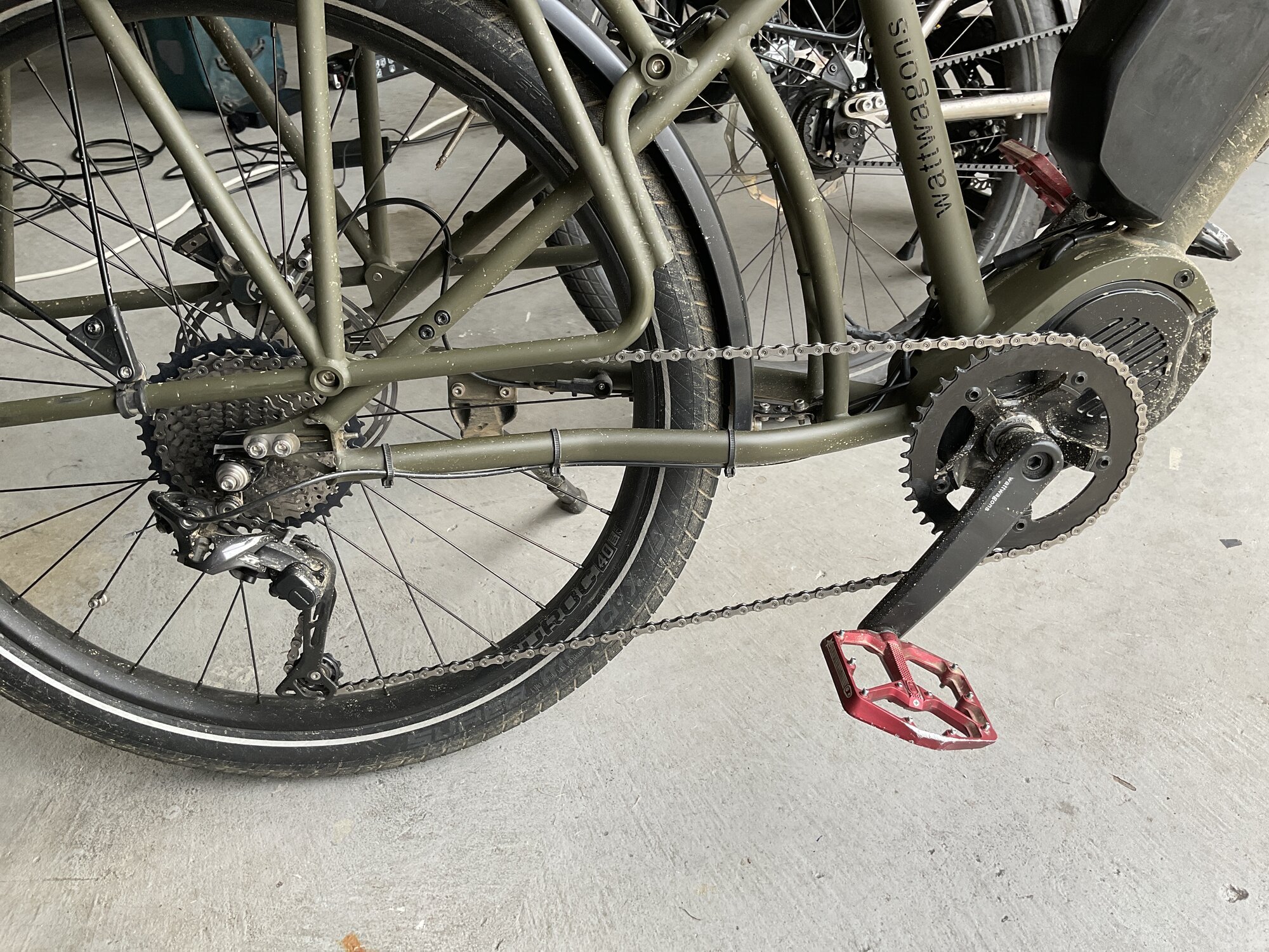

Let me bring this thread back up. I need some help with specifics on increasing the size of my front chain ring. I am trying to reduce the time between cassette and chain replacement and reduce my cadence in general.
The bike is a Watt Wagon cargo bike. Every 800 to 1200 miles or so the chain starts skipping on the 11 tooth gear. The 1st time I replace the actual 11 tooth gear and then the next time chain and cassette are needed. I have ridden a couple of of bikes in off road mode which can hit 32 mph and found a slower cadence for the same speeds on both and found them more to my liking. This bike’s lowest 3 gears are useless to my riding style and I will never use it to carry anything so I won’t miss those gears.
This will keep me from staying on the 11 tooth cog so I can still cruise at 28 mph and not wear out parts as fast . The top speed should be at least 37 but no desire to be there but keep me from clown pedaling at higher speeds then 28 on the occasion I do hit 32 to keep up the the others.
Things I need to know are which size ring makes sense to move everything up at least 2 gears. The bike currently has a 44 tooth ring. I assume I will also need a new chain but how much longer? The 1st question the shop asked me is what size the diameter of either the ring or the piece the ring attaches to was 130 something or 133 I think he said. The way he implied it was a choice of some standard size but didn’t know which one ( I am clueless just trying to go by memory)

To maintain the same top speed and avoid using the 11T and 13T sprockets, you'll need a 60T chainring. (44/11=60/15)
130 BCD is the standard spider size on the Bafang Ultra. I don't know of any high quality chainrings in this size but there are plenty of dubious quality on Amazon and AliExpress.
You'd need to add 8 links to the chain. (60-44)/2

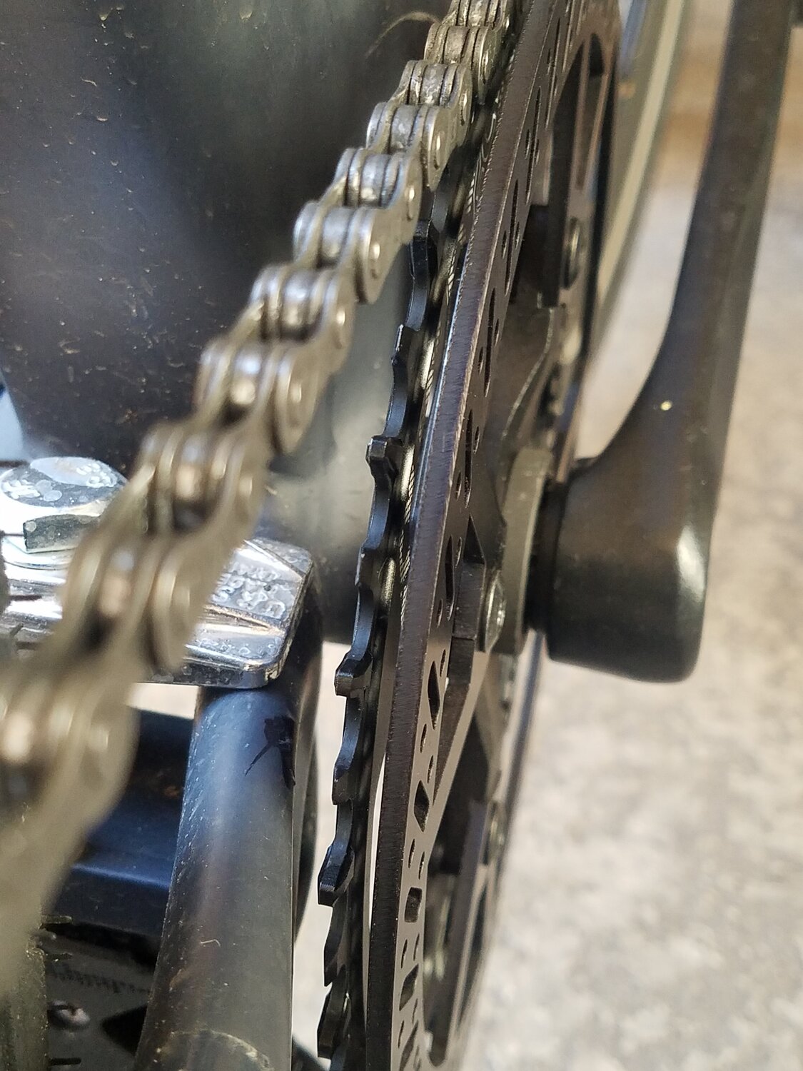

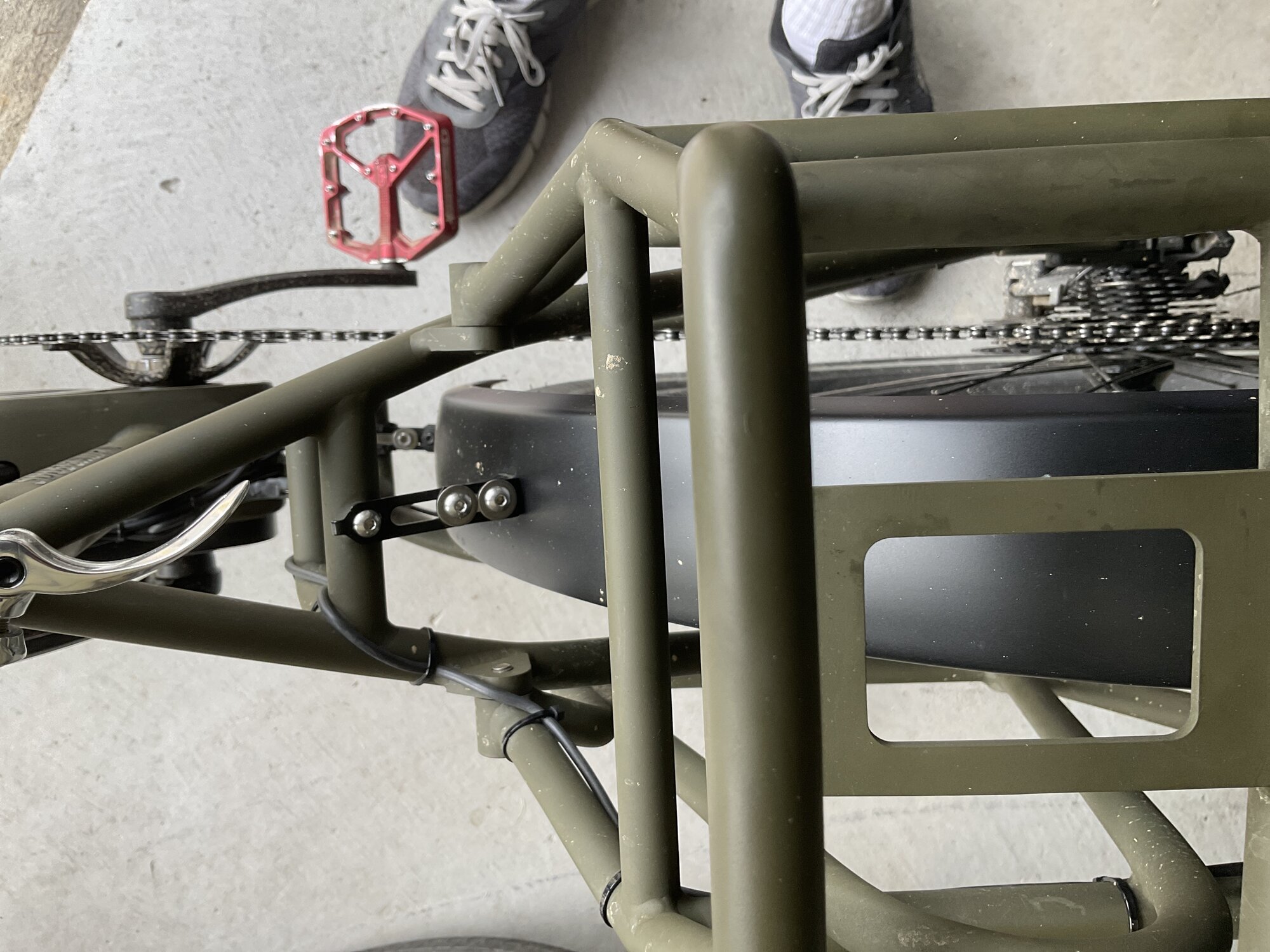

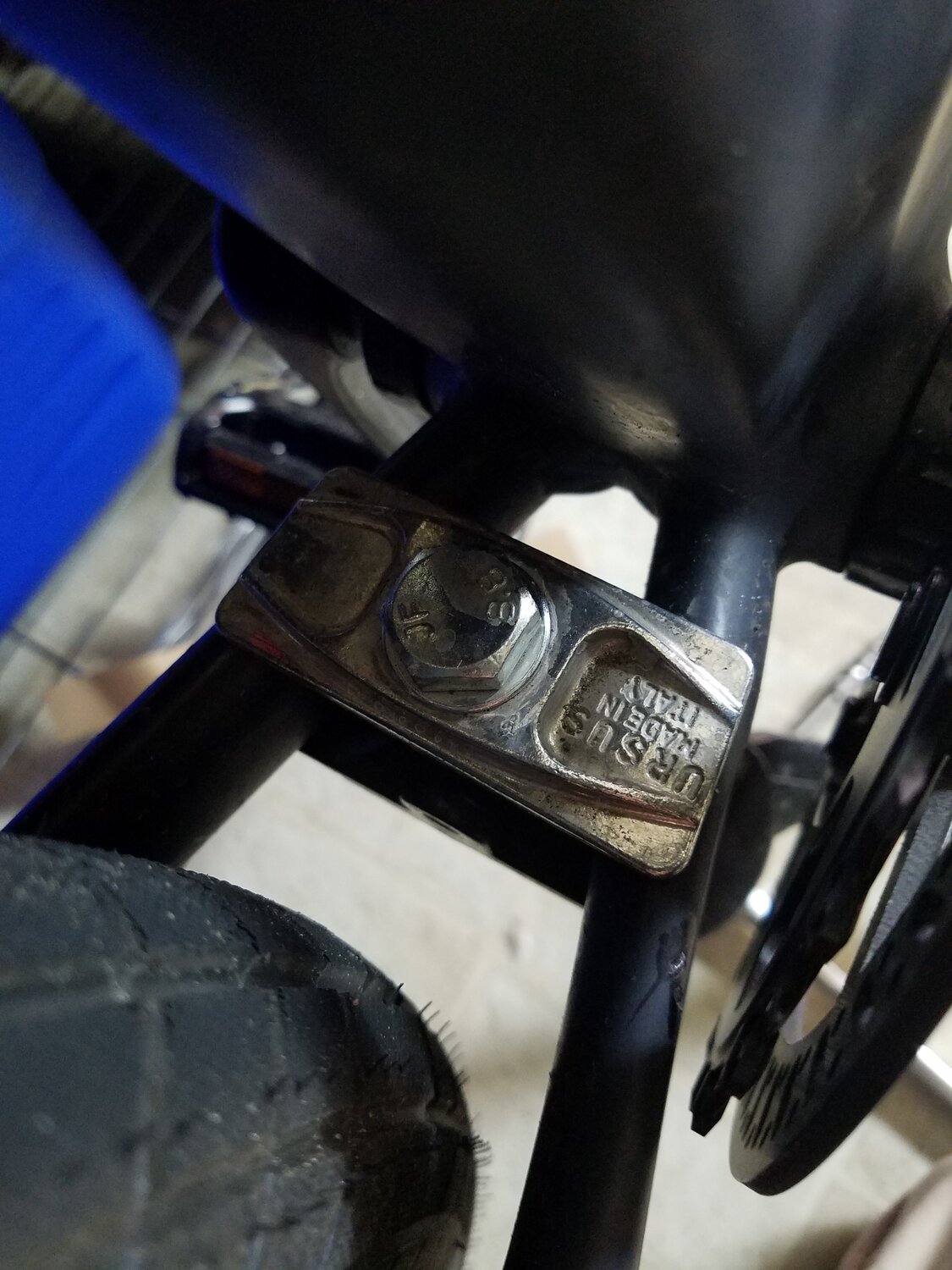

From the pic it looks like a 50T wouldn't clear your chain-stay. That's the limiting factor.

From my observations, road and gravel bikes have chain-stays that'll fit a 50T(+).
Look at how tight my fit was w/ a 48T in pics 442 and 307.

As I remember, photo's posted show you can't go any larger than a 48T because it will conflict with the chain-stay.
