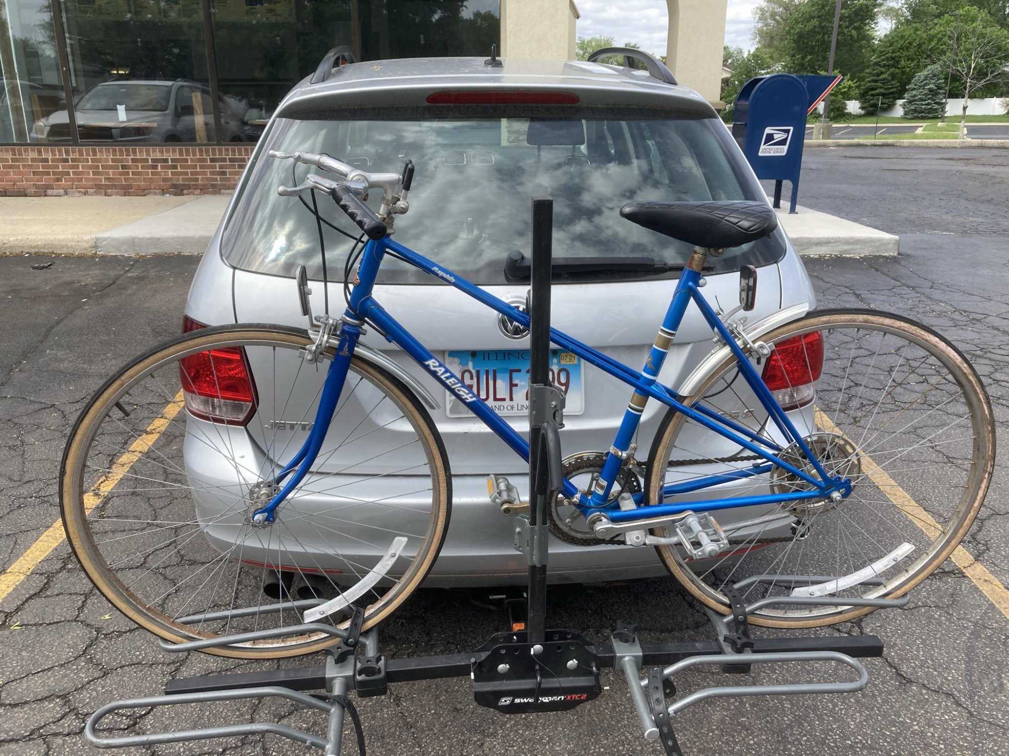

I take in strays, bikes that is. I no longer bother severely corroded bikes. It seems to be the life cycle of an inexpensive bicycle. It's ridden and loved for awhile, then migrates to under a tarp in the back yard, then the tarp rots away. Eventually the bike is freed from the bushes and ends up on the curb. Nicer bikes tend to spend their half life in the garage. So, when they again return to the light they aren't corroded, some barely ridden. Those are the ones to look for.
