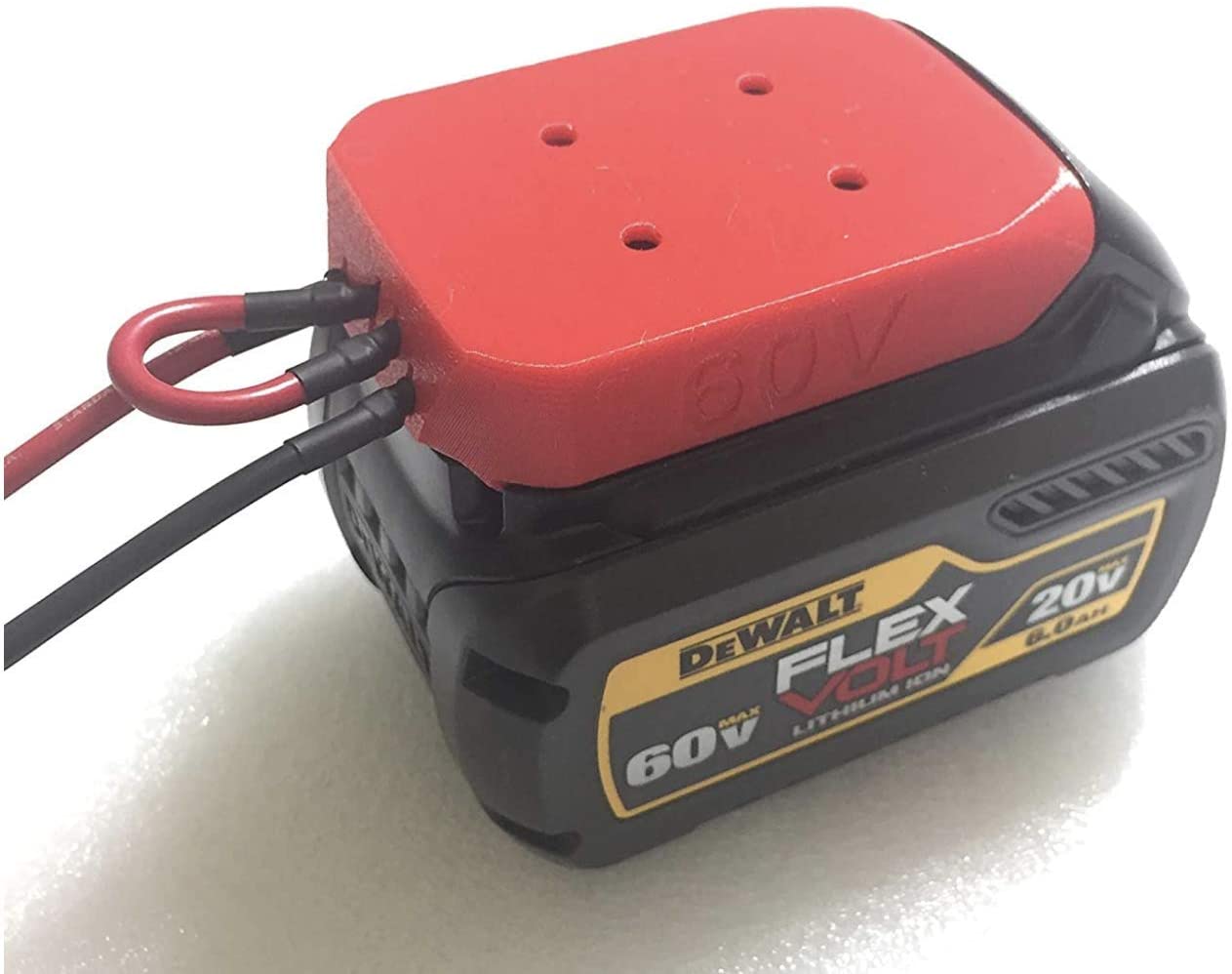

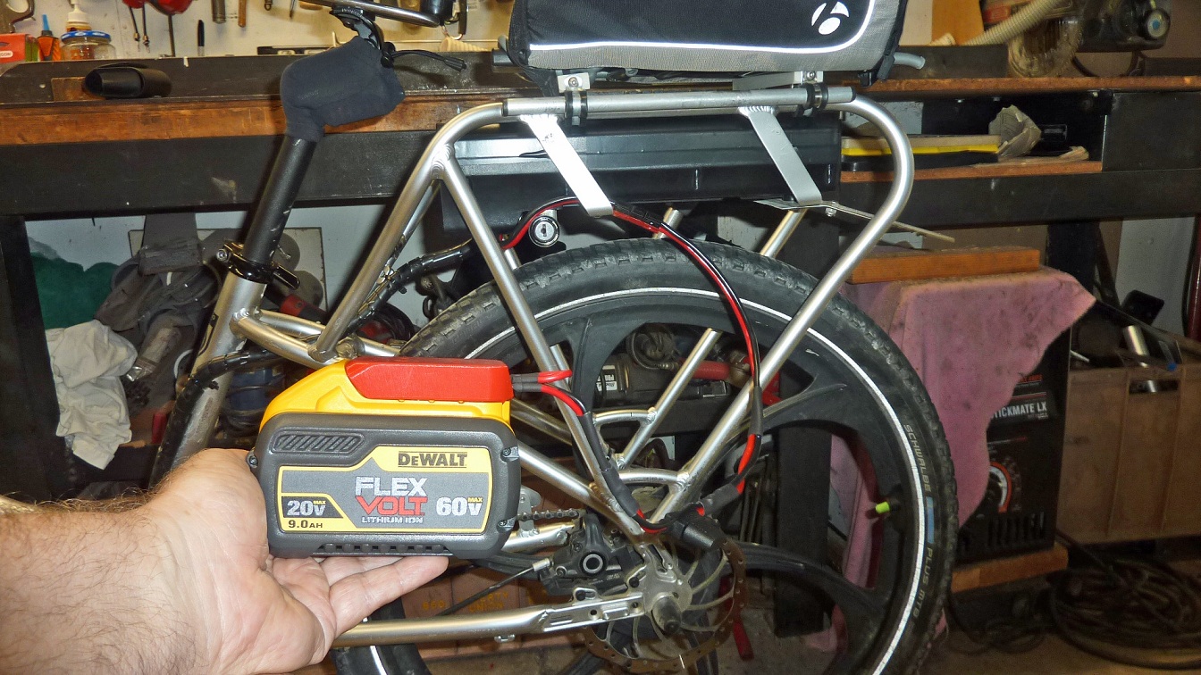

I assume you are talking about a conversion and aren't looking for a battery to fit the mount on a production bike. If you have a Bafang BBS02 48/52V motor and are a DIY'er, you can use a 60V power tool battery.
I use this one from DeWalt:
The rating is 9 AH when used at 20V but yields 3 AH at 60V. It gives me a 10 to 12 mile range in PAS 2 but I've stretched it out to 18 miles using ECO mode.

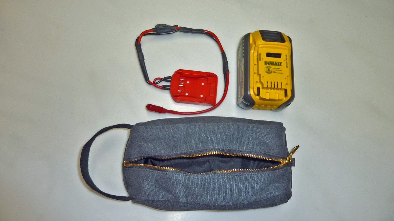

There are adapters available for many different tool batteries with leads you can solder to various connectors. I used Anderson Power Pole's to match the one on the bike. Many Bafang motors use Anderson's as well.
I use a small canvas bag to hold the battery & wiring harness and carry it in a rear rack bag or pannier.

Wow, that is pretty genius. I did not know you could use a power tool battery for a ebike. But it makes sense. It is so small I could bring a back up. Thanks for the info.
