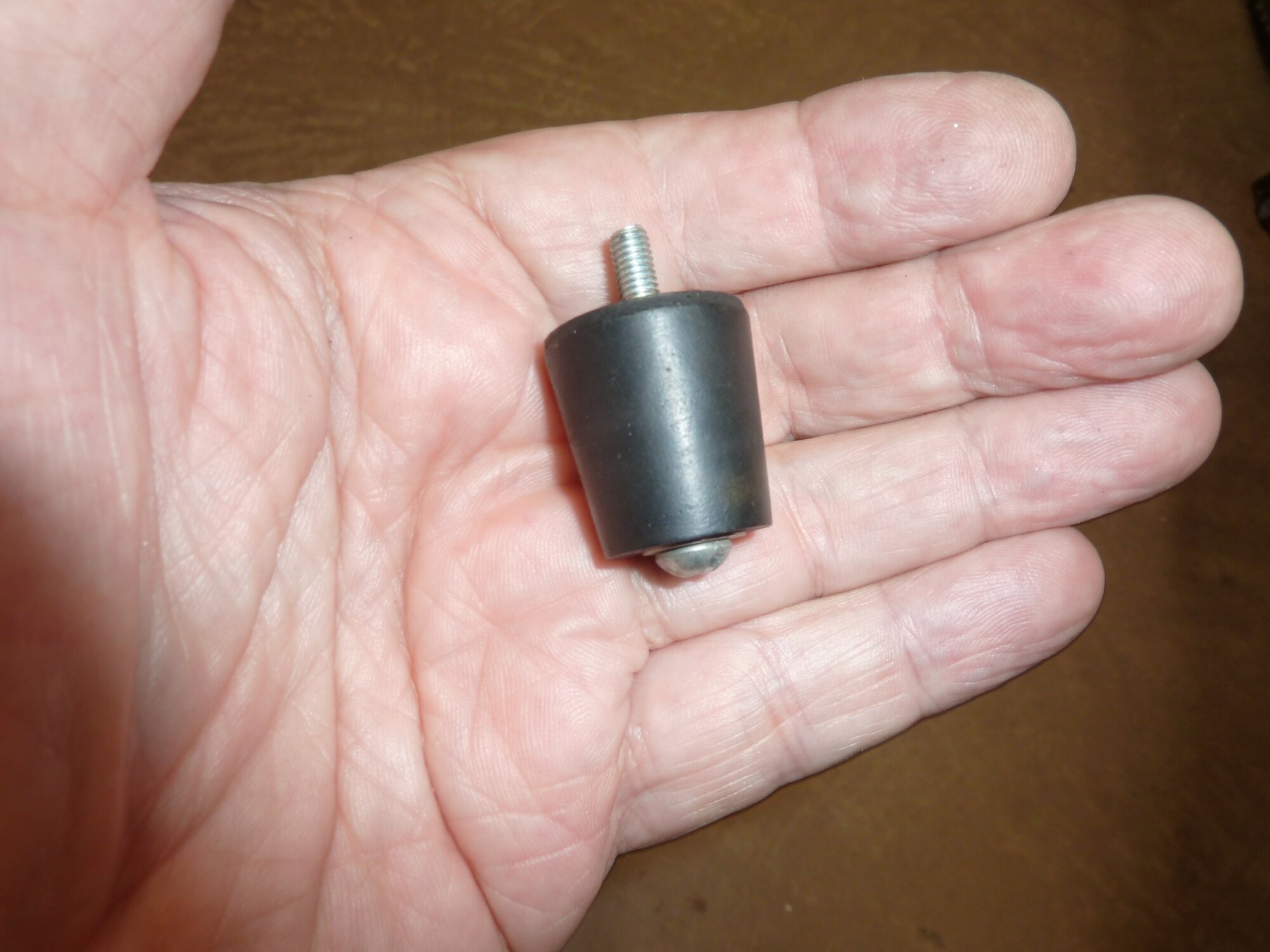

Last season, I replaced my worn suspension forks with a set of Rockshox Gold 35's. The swap went smoothly until I tried to attach the bike's headlight. The old forks had a tapped hole in the fork crown where the headlight bracket attached. The Rockshox has no such hole.
Drilling and tapping a hole was a possibility but I was afraid of weakening the fork crown. Instead, I came up with a simple fix using an expandable rubber plug which I inserted into the open end of the steerer tube:

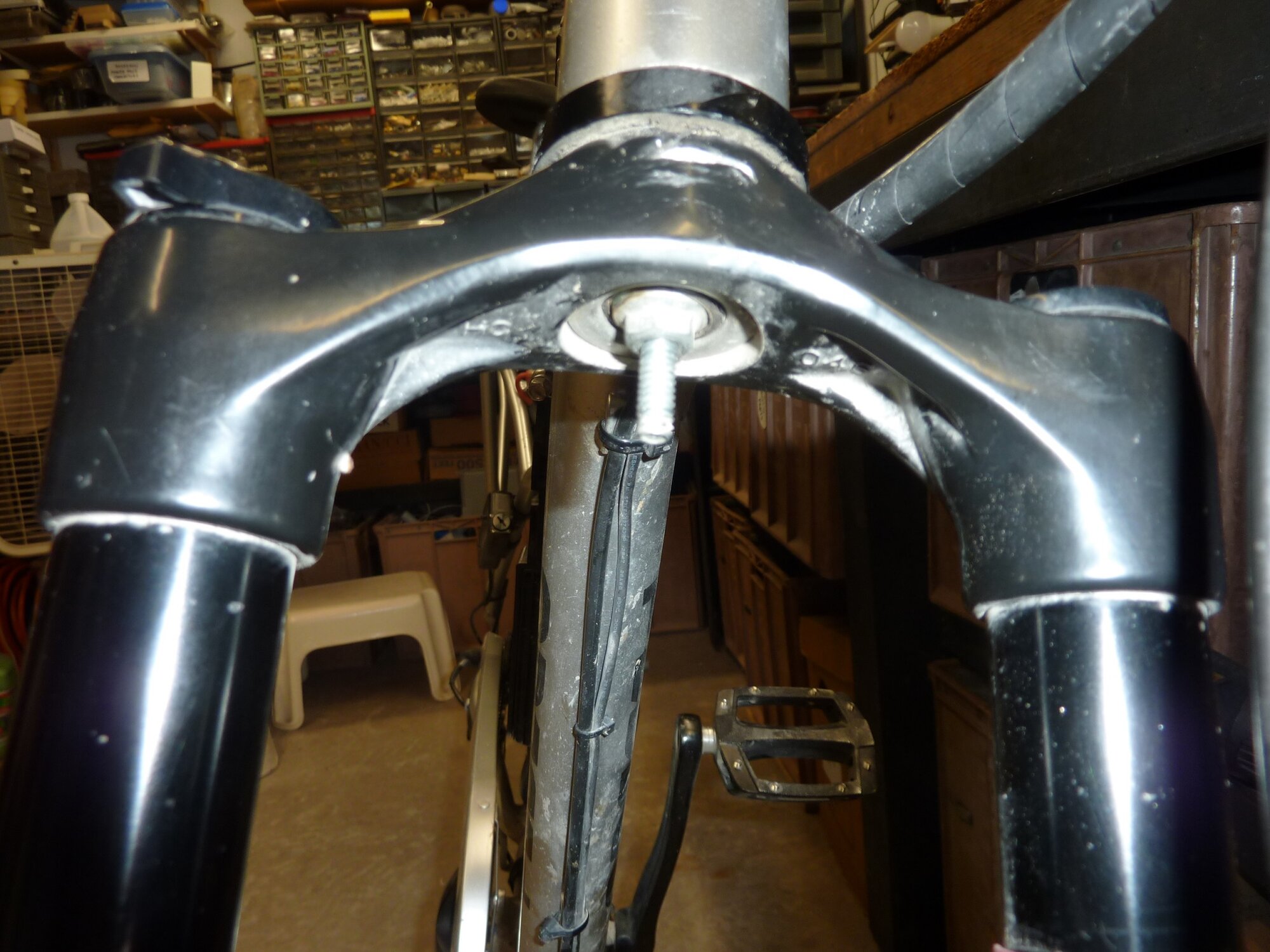

View attachment 129865 View attachment 129864

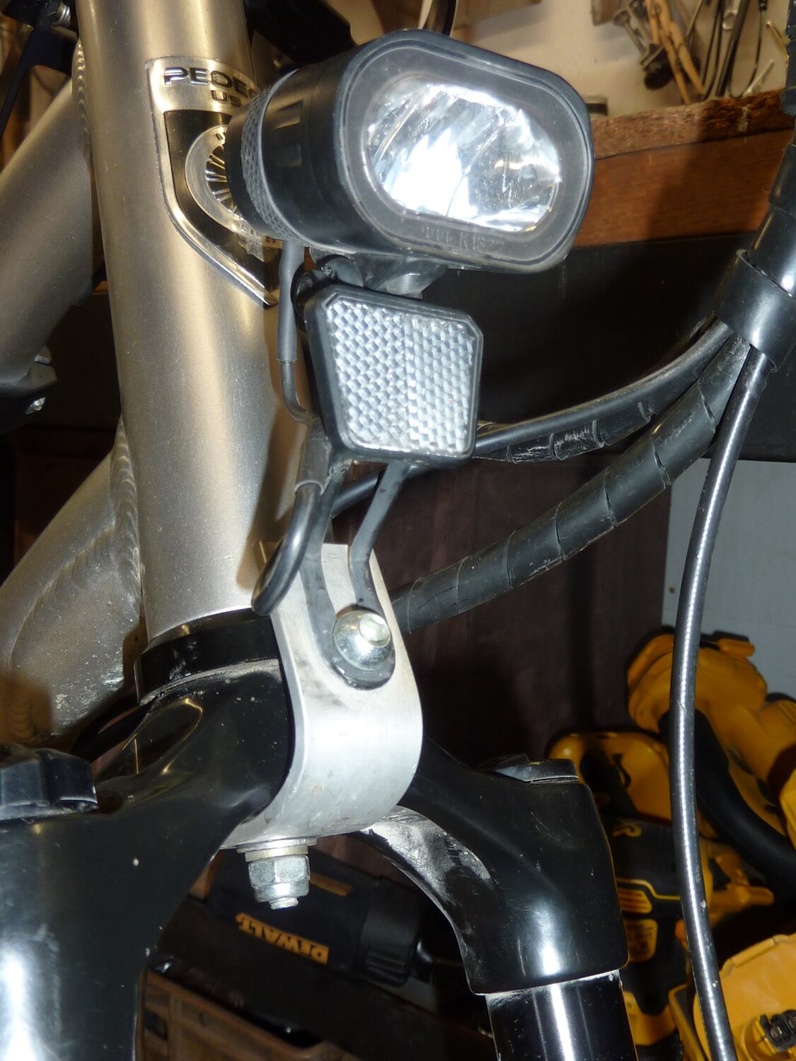

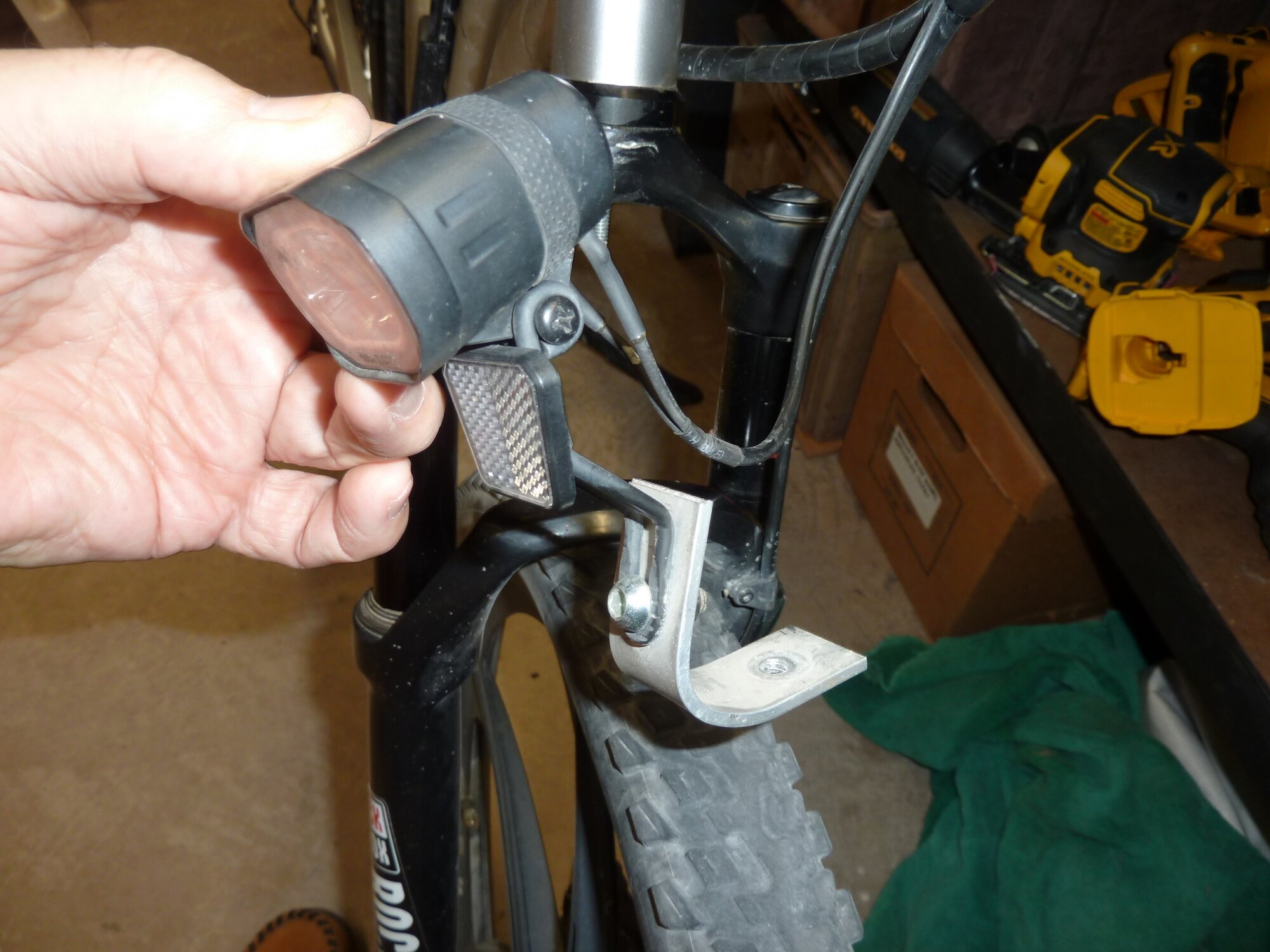

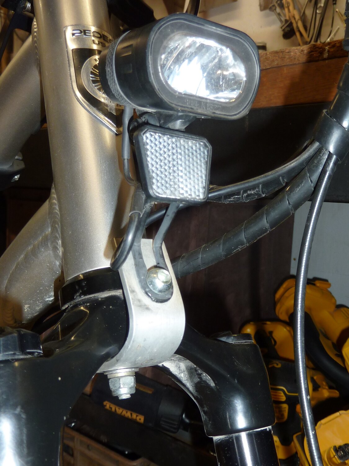

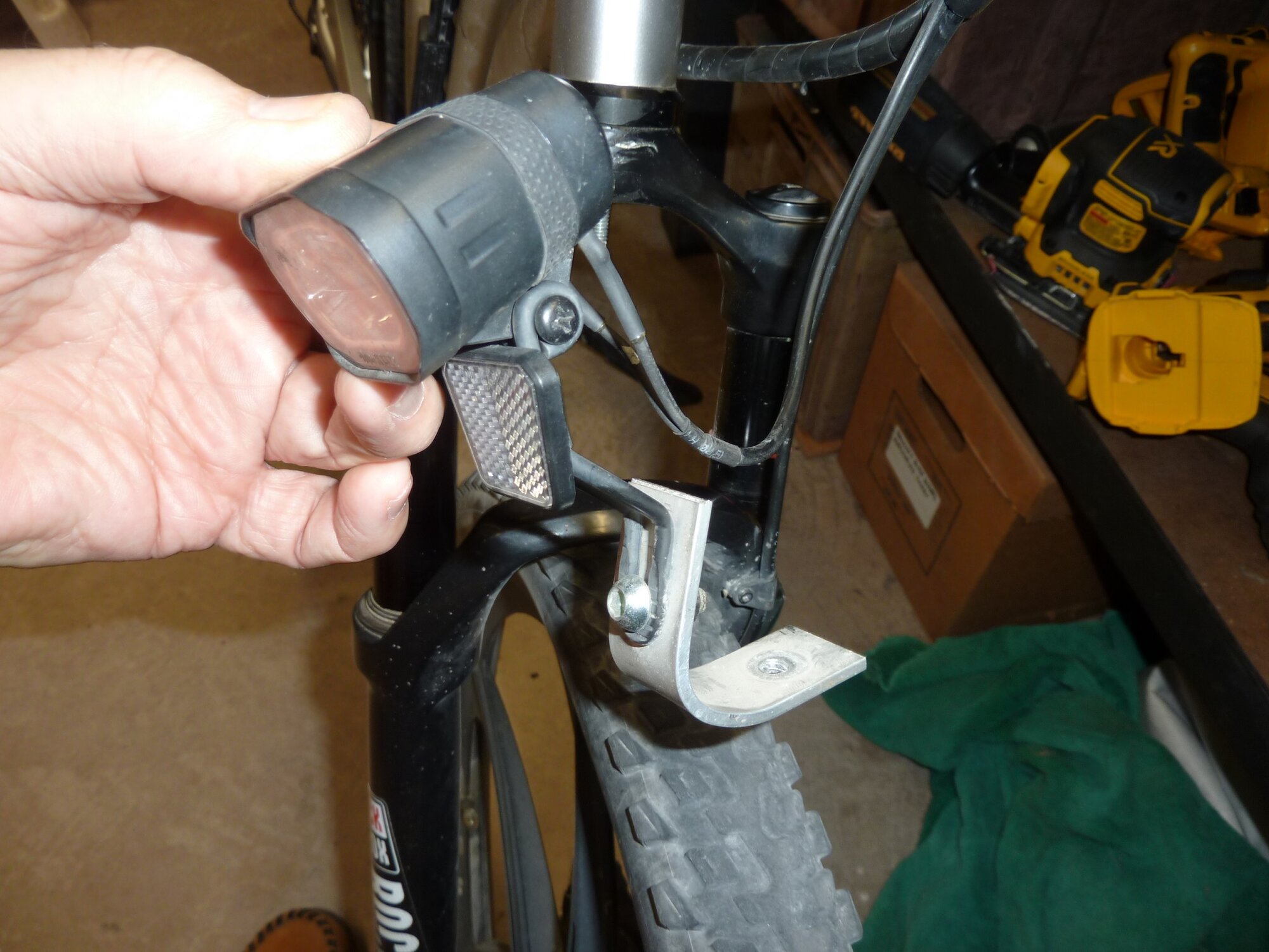

I then made a bracket from a piece of 1" aluminum flat stock, bent it into the appropriate radius, and assembled as shown:
View attachment 129863 View attachment 129866
I made this up last season but wanted to test it before posting. After almost 800 miles, the mount has held perfectly. The rubber stopper even provides a bit of shock absorption.
It isn't pretty but it does the job.
I have done similarly but instead of an expanding rubber nut I used a headset star nut that I had laying around. Insurted from the bottom it has worked quite well for me 👍
