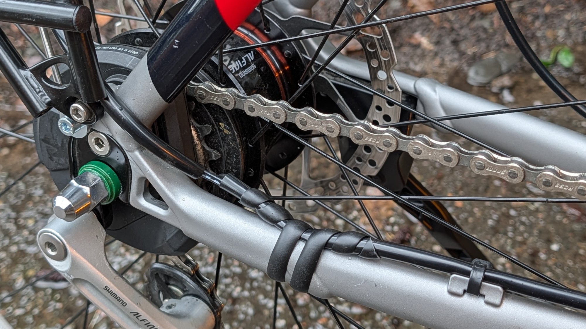

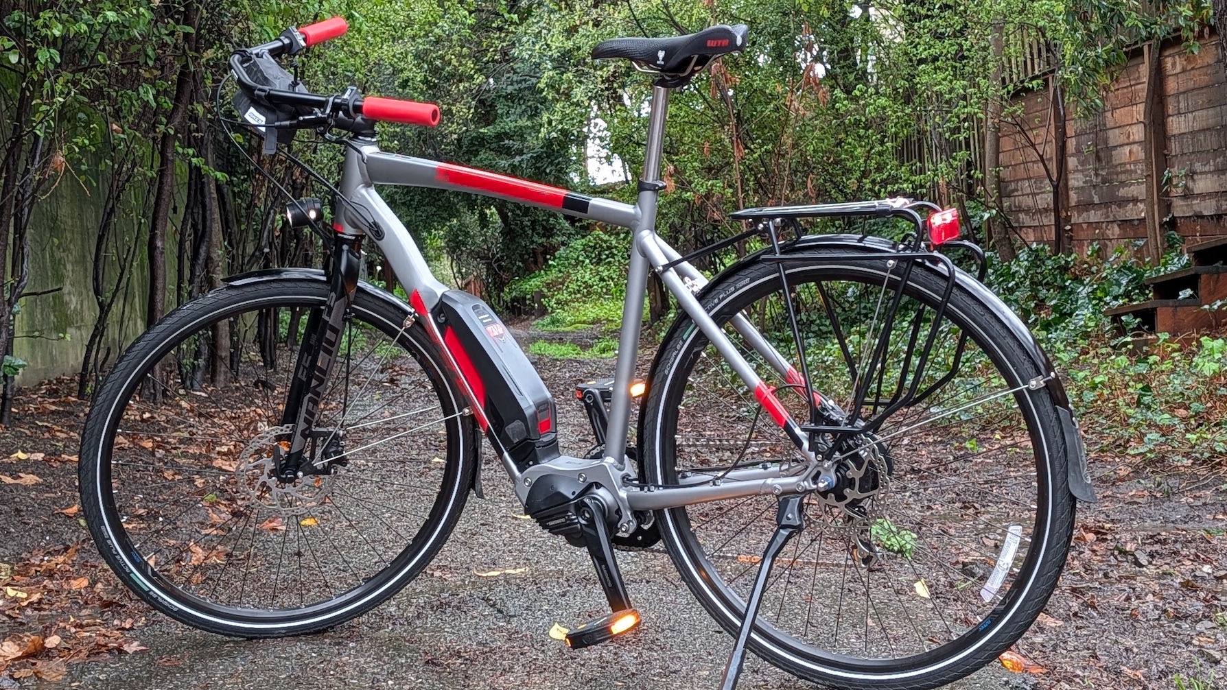

I retired my get-around street bike, a Raleigh Misceo ie with an E6000 motor and an 8-speed Alfine with electric Di2 shifting.
I kept the Misceo 's rear wheel & Alfine, and outfitted the it with a 9 speed derailleur prior to sale. It's gone.

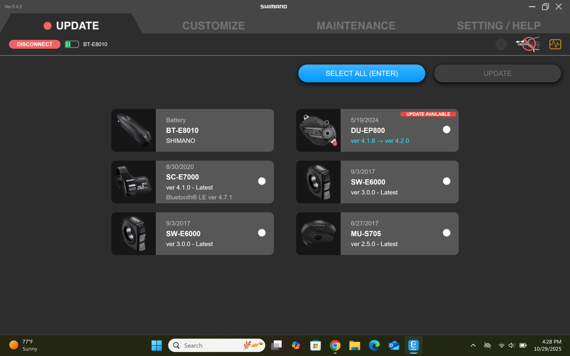

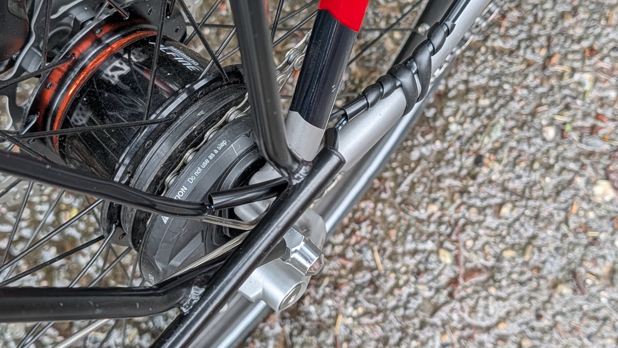

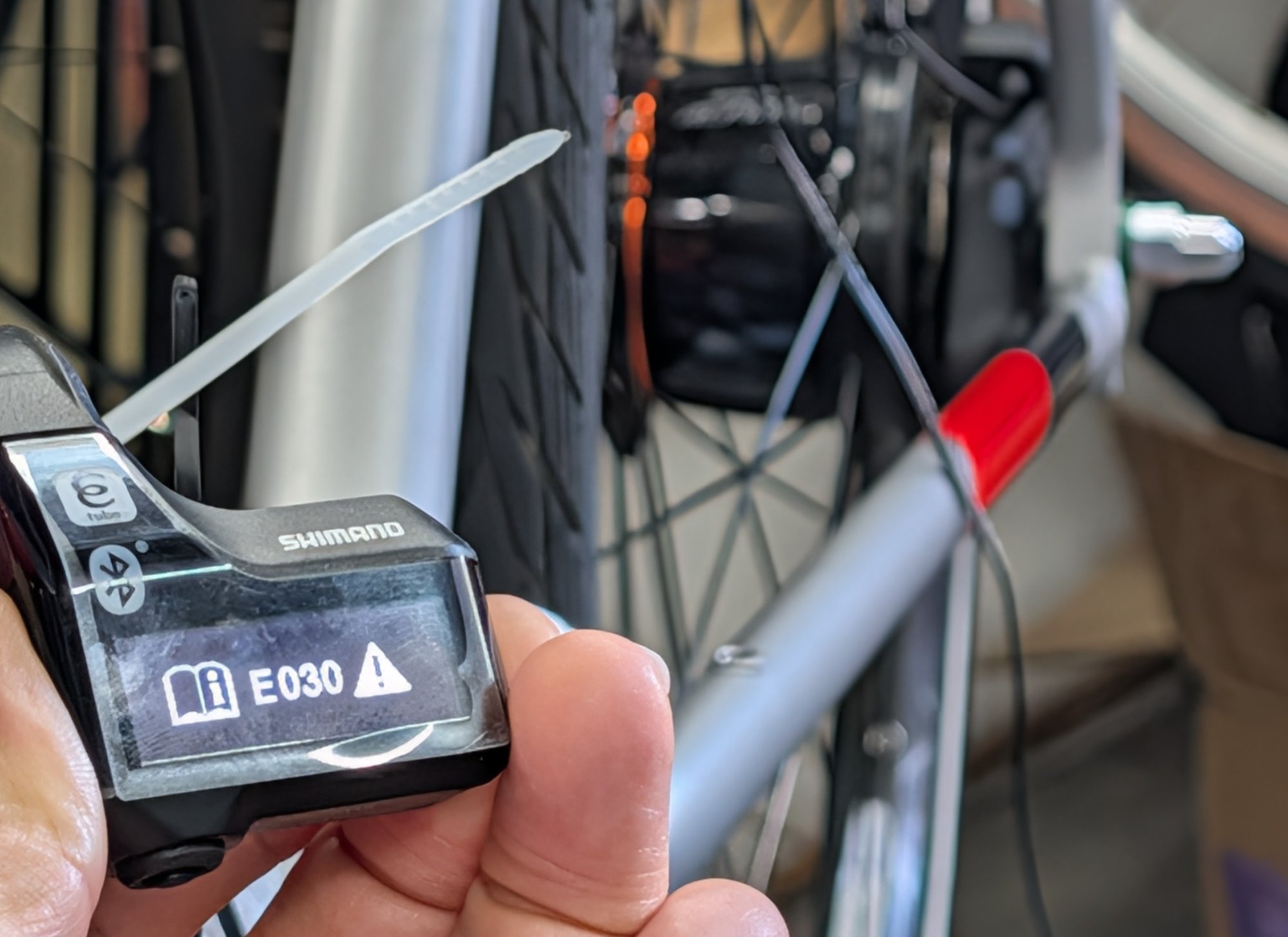

The replacement bike is a Felt with a torquy E8000 motor. Guess what? The E8000 isn't compatible with the Alfine Di2 shifting. Boo Hoo.
So plan B is (obviously) switch to manual cable shifting, no biggie. I even have a spare, brand new Alfine sitting around that I can just re-lace into that wheel, and put the Raleigh's old Di2 Alfine on the shelf to await another project.

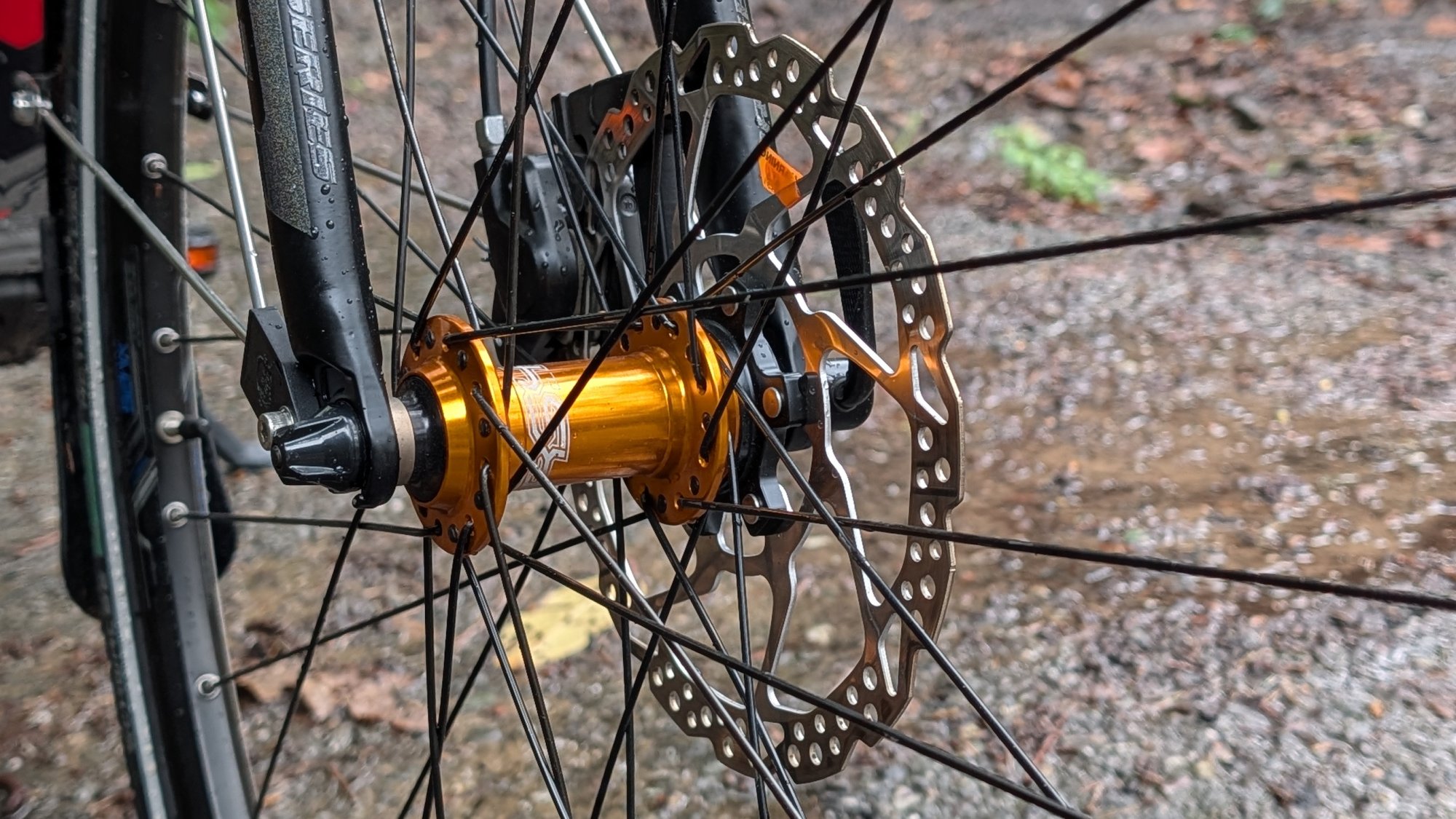

However... I've got this old mountain bike I'm about to sell. I built it with a Rohloff Speedhub. These hubs are bulletproof. I don't think I can sell the old mountain bike for more than the value is the hub, maybe $800 (given the current state of the analogue bike market, not to mention it's 20 years old).
14 speeds and 526% gear range are overkill for a lightweight commuter-type ebike, but shoot, I already own the dang hub. Should I just do it, or sell the Rohloff and stick with the Alfine plan?

It's not my time or money so here's a dumb idea: sell the Rohloff, use the $$ to get a EP8 or EP801 drive unit which I think are smaller and lighter than the e8000 but still use the same bolt pattern and support Di2?? Knowing Shimano and Di2 there's some dumb compatibility issue between their own products that makes this a non starter.
...get a EP8 or EP801 drive unit which I think are smaller and lighter than the e8000 but still use the same bolt pattern and support Di2?? Knowing Shimano and Di2 there's some dumb compatibility issue between their own products that makes this a non starter.
You don't say?!?
I just so happen to have access to an EP8 on a Yuba Mondo frame, which is the winter cargo project I'm formulating.
Since that cargo bike would get the Rohloff that's currently on my Xtracycle, I'm not in dire need of gobs and gobs of torque. Sure, nice, but I'd bet the E8000 (70 NM torque) + Speedhub on the cargo bike should be sufficient, and the Felt with an EP8 (85 NM) would be a rocket on the local hills.

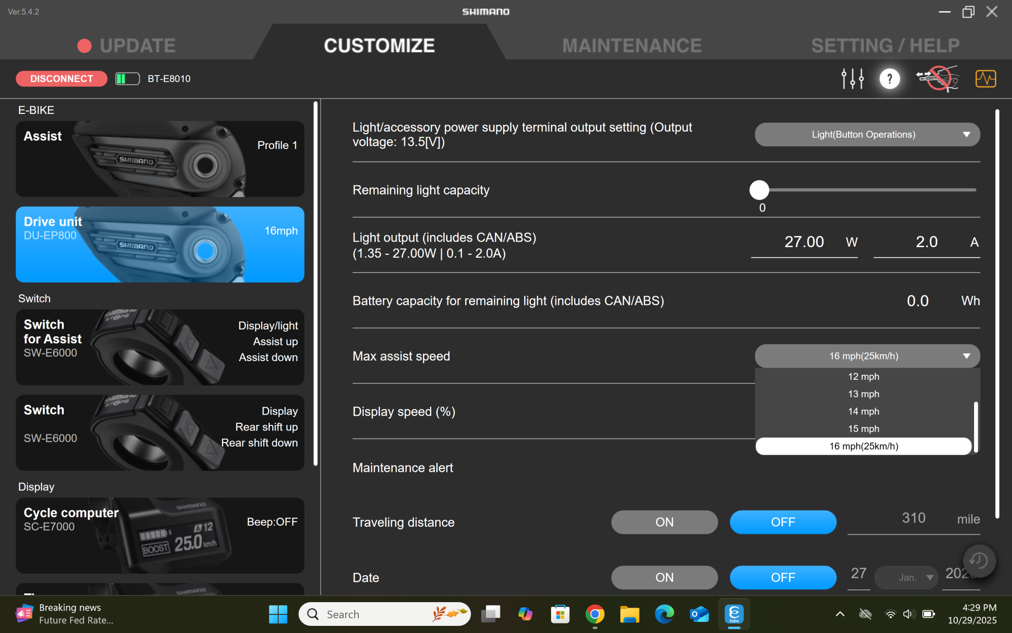

I'd want to do a 28 mph conversion on whichever motor the Felt ends up with. They're both 20 mph units.
