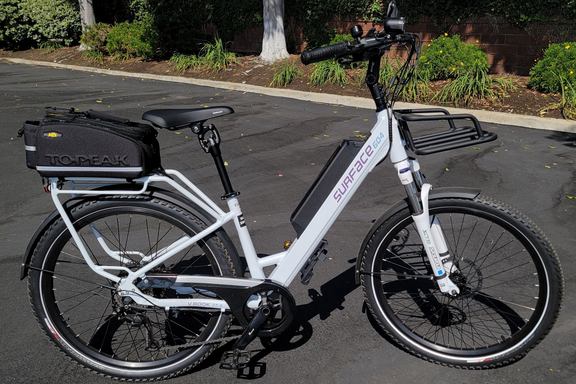

Like @Kayakguy, need for a safe foot plant puts an absolute upper limit on seat height. And at the limit of questionable safety (balls of feet barely on the ground), knee extension is inadequate for my long legs and dodgy knees. The larger V Rook frame was no help cuz all it does is extend reach, and reach is perfect as-is.
So, the only safe way left to get more knee extension was to move the seat away from the bottom bracket horizontally. Luckily, the stock seat's long rails allowed enough setback to get my knees onboard with ebiking at low assist.
Big win in my book -- provided the one-bolt Selle Royal Essenza Plus seat is strong enough for the job.

My regular frame's working quite well for me with the seat setback pictured earlier -- a good compromise between knee and butt comfort. But the pedal forward option could come in handy down the road.
