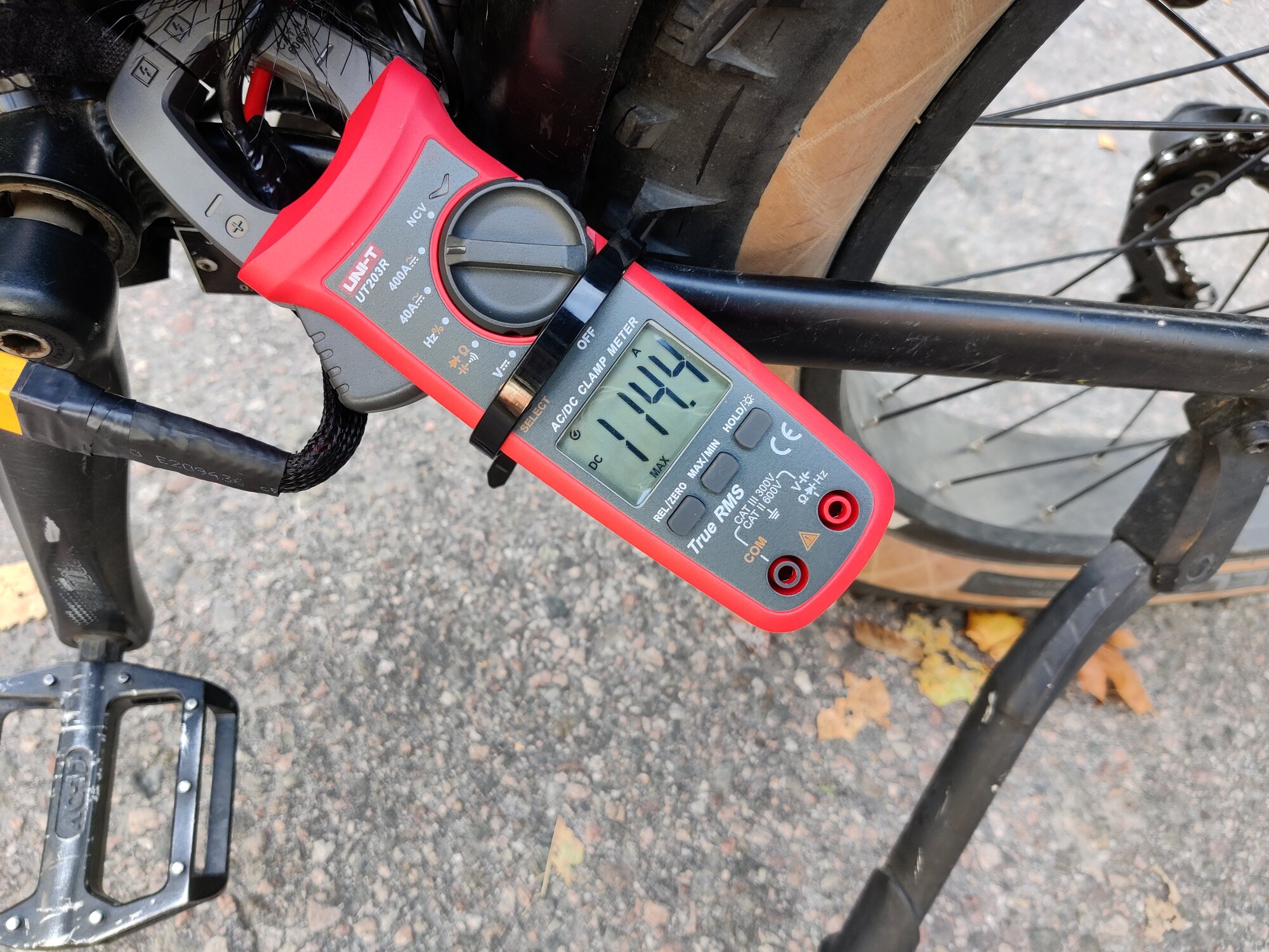

After latest upgrades the beast now puts out Peak 114A (battery DC) @ 60v leveling to 80A.

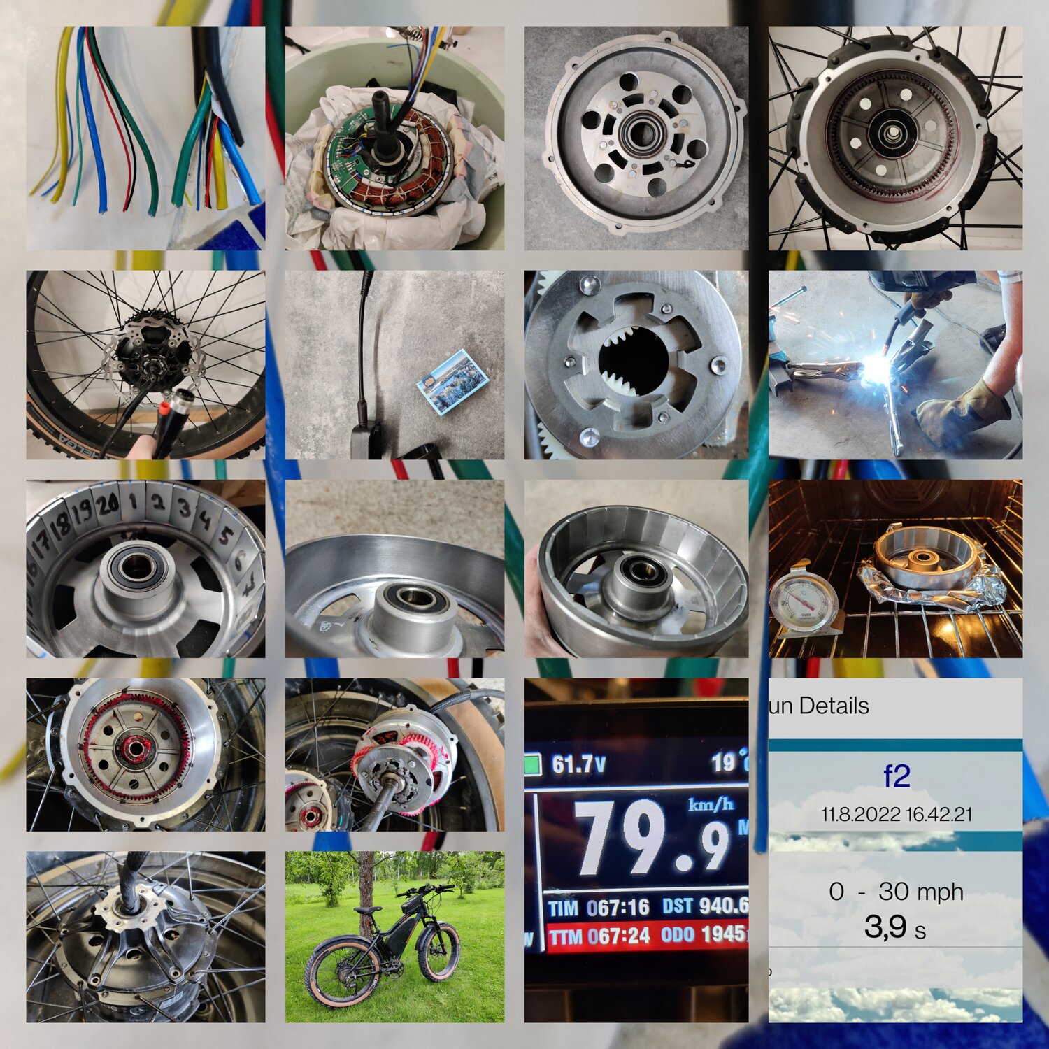

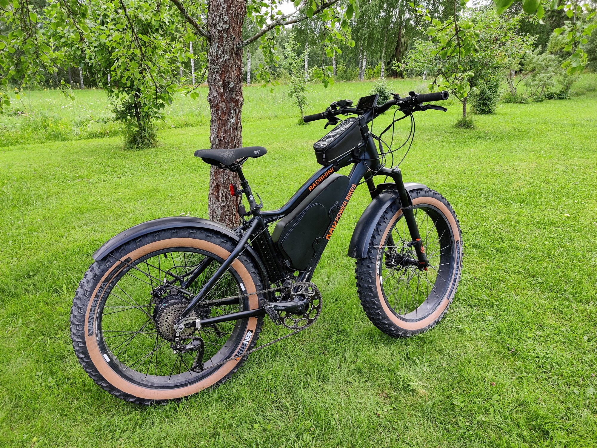

Mods list.
- Controller 60v 64A modded to 114A Peak (custom).
- Custom 60v 24Ah lockable downtube battery (16s6p Samsung 40T), 120A(continous) BMS Custom downtube battery
+ range extender fast mount rear rack G80 60V 17.5Ah = 60V 41.5Ah (2400wh)
- Vented high KV G062.1000.DC motor with real time BT temp logging system, higher gauge wiring and reglued magnets. Welded clutch.
- Magura MT5E brakes, Galfer f223/r203 rotors
- Shimano 8 speed trigger with 11-42t cassette.
- Derailleur Shimano 9s RD-M3100 + hanger extender (modded)
- 52t Deckas chainring (58t litepro on the shelf)
- XLC CR-A19 chainguide (modded)
- double heavy torque arms (modded)
- STD zero Pro pedals
- 780mm Pro Devil 30mm riser bar
- Wuxing 130X thump throttle
- full mountaingrips
- 3000 lumen bullboy headlight (12v 2.5A). Micro tail light.
- 120mm Air fork with rebound adj and remote lockout.
- Red smooth II suspension seat post
- custom kydex "carbon" skid plate
- Peak 6kw power.
- Over 40mph.

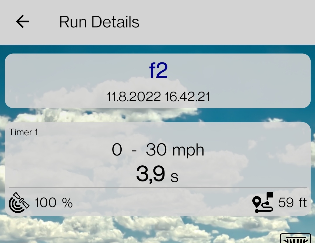

- 0-30mph ~3.9sec
+ Some other mods & parts
