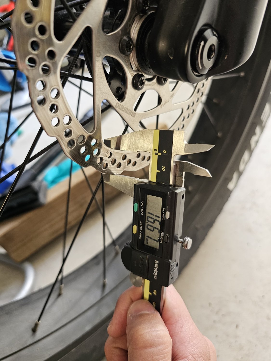

just had a look on the bikes in the workshop here. measured a few diffent makes and type of rotors. All measure between 16 and 17mm on the highest point. mix of 140, 160, 180 and 203 rotors from Tektro, Shimano, Sram and Magura.
what do you measure at you rotor?

Thanks for that. Do you mean 16-17mm between the inner diameter of the rotor where the big pockets are, to the outer diameter? In other words the contact area height for the pad?
If so, I just measured 16,7-17mm on mine (depending on how parallel I can get my caliper) but seems to be the same value. In other words the rotors you measured should provide the same contact area 👍
