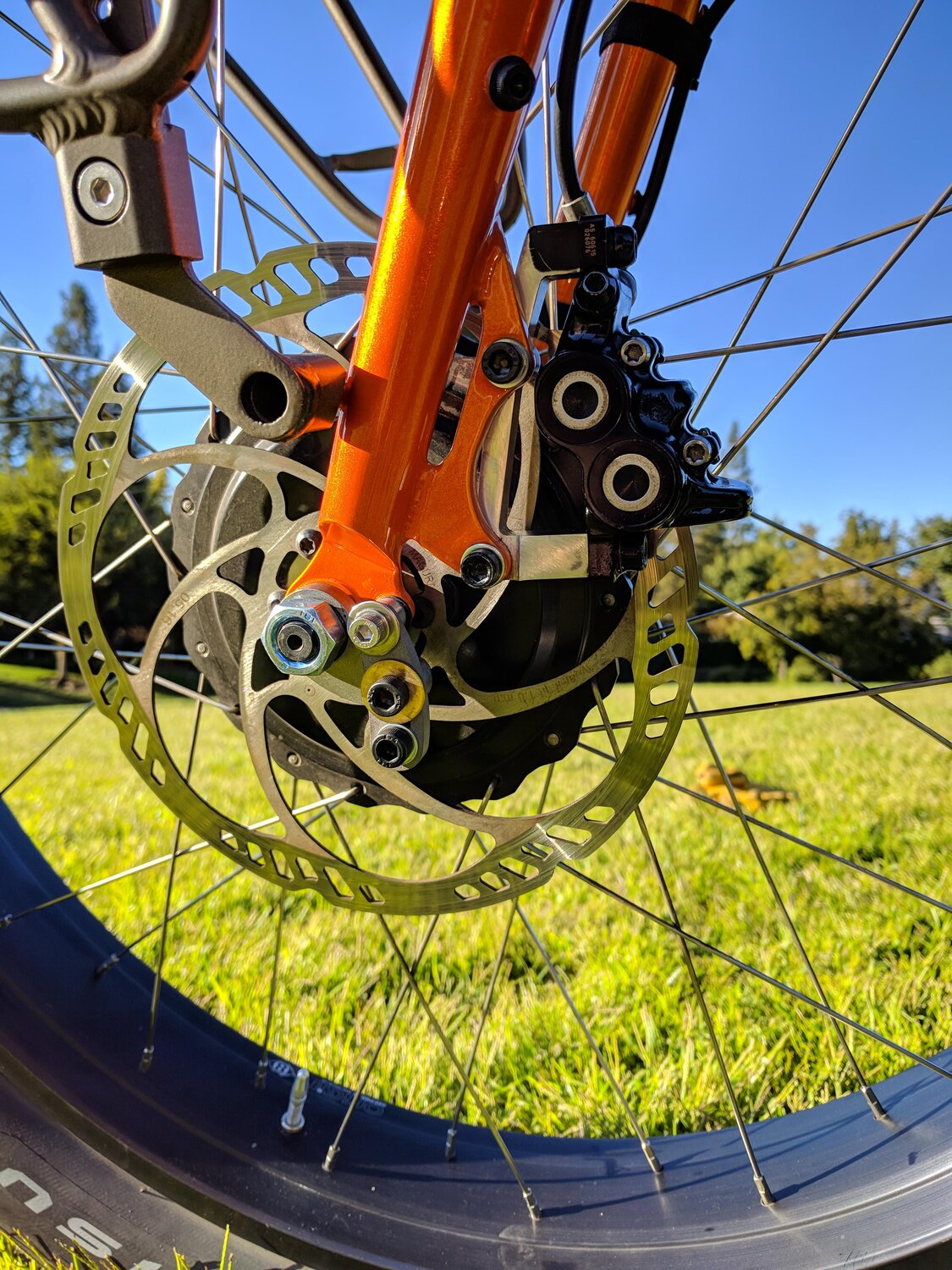

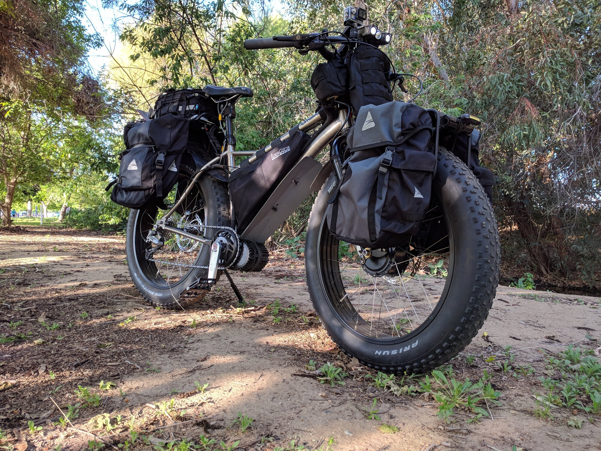

500w/45Nm motor. Steel fork. Two Grin torque arms. Just crossed 2000 miles in a little over a year.
750w/80Nm motor. steel fork. Two torque arms. Just over 7000 miles across 3-4 years.

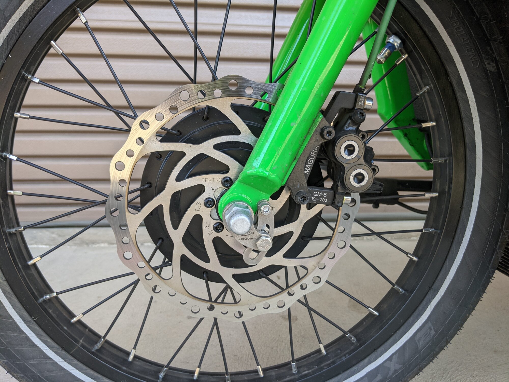

Same motor and dual torque arms as above. About 3000 miles on this one. This is actually a heavy duty alloy fork. I recently chickened out and swapped in a quality steel replacement.
