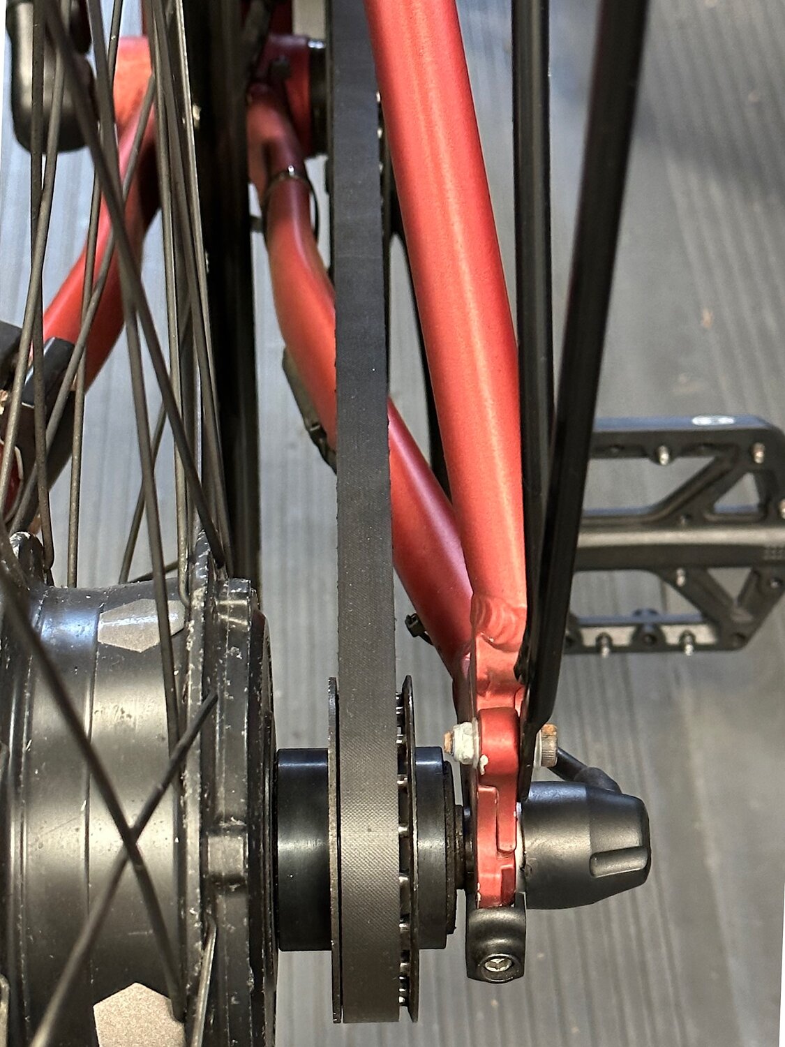

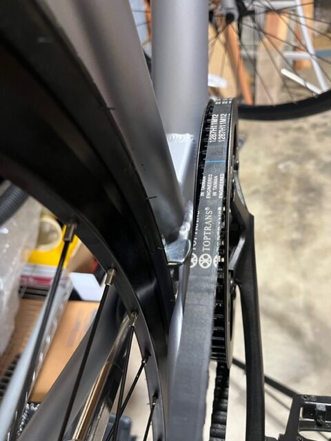

Has anybody had experience with doing belt alignment on this model?

How long have you had the bike and have you reached out to Ride1Up? They also have a lot of information and torque specs on their site. It kind of looks like your chain ring is off. Bent crank spindle?
Can’t tell from the picture, but are you sure the rear wheel is properly installed, and are the spacers around the axle in the right location (realative to the frame)? The Ride1UP support pages have the way the spacers should look.

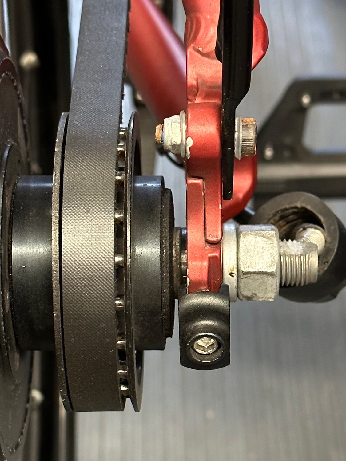

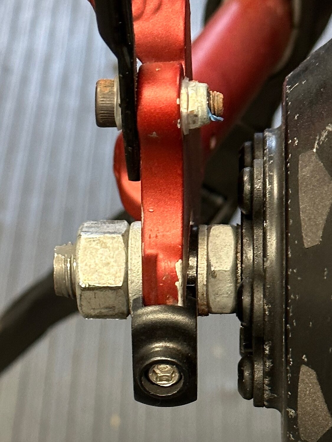

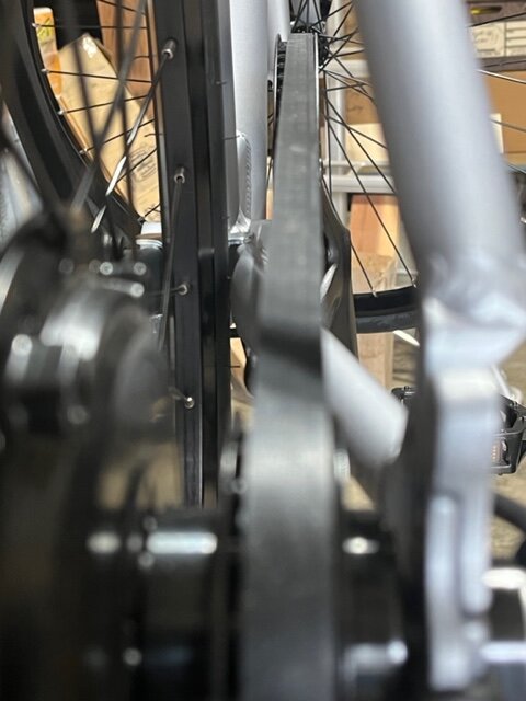

Ride1UP support has been pretty helpful and responsive, so you may want to send them an email. In the meantime, the attached shows what my Roadster looks like:
