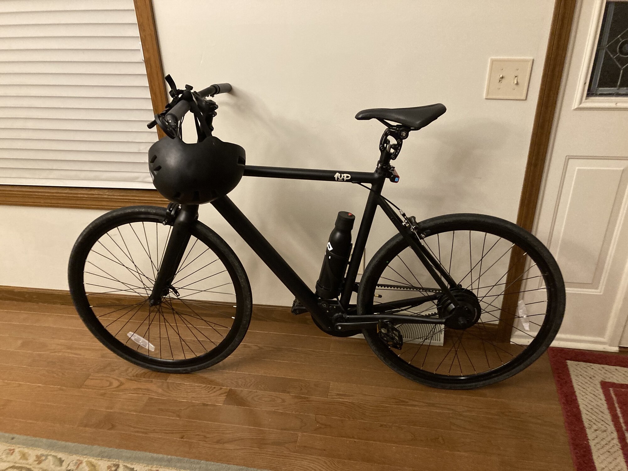

Thanks for the responses. I received the bottle battery and wired it in parallel to the internal battery. All wiring connections fit in the down tube. They are both 36v 7ah samsung cell batteries and I have been charging them separately. I charge them both to full when I charge them up. I would estimate that I get 40 miles per charge no problem but have yet to drain them completely. My weekend rides tend to go about 30-40 miles. No way that I could get that distance with just the original battery.
Small sample size but so far everything has been fine. No one can tell the bike is an ebike - complete stealth. The single speed belt drive is quiet and smooth. The brakes are fine and I weigh in at 225 lbs. 20 mph is easy to hit. So far the Roadster has been a great purchase. I do have some disappointment at times that I missed the gravel option by about a week but maybe it's for the best. I imagine the Roadster version gets more mileage. With the onset of winter I imagine my Ecotric Fat tire will still see a lot of usage. Still love that bike and have purchased a few upgrades. The Suntour Seat Post is incredible for us older folks. Best $80 I have spent on Amazon. Let me also suggest that the stock version of the seat post is fine for us bigger guys.

When I was deciding on this purchase my choice came down to the Roadster or the VanMoof. In the end the VanMoof scared me away because of my perceived inability to work on that bike if it bugged out. The high end components sure are cool but with the Roadster I was reasonably confident, confirmed by my work after purchase, that the Roadster would be within my meager skills to fix (with a little help for the nice people on this forum).
