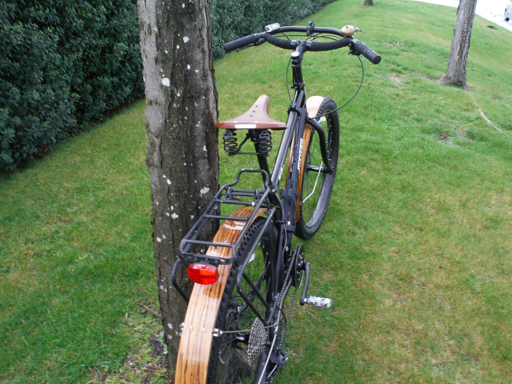

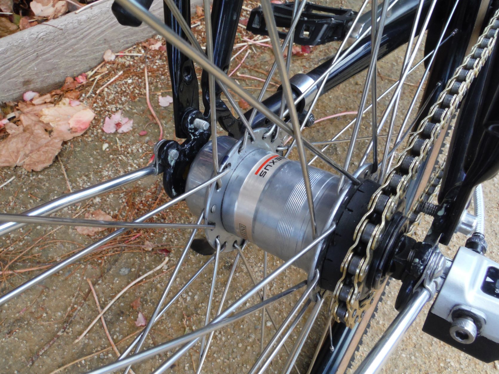

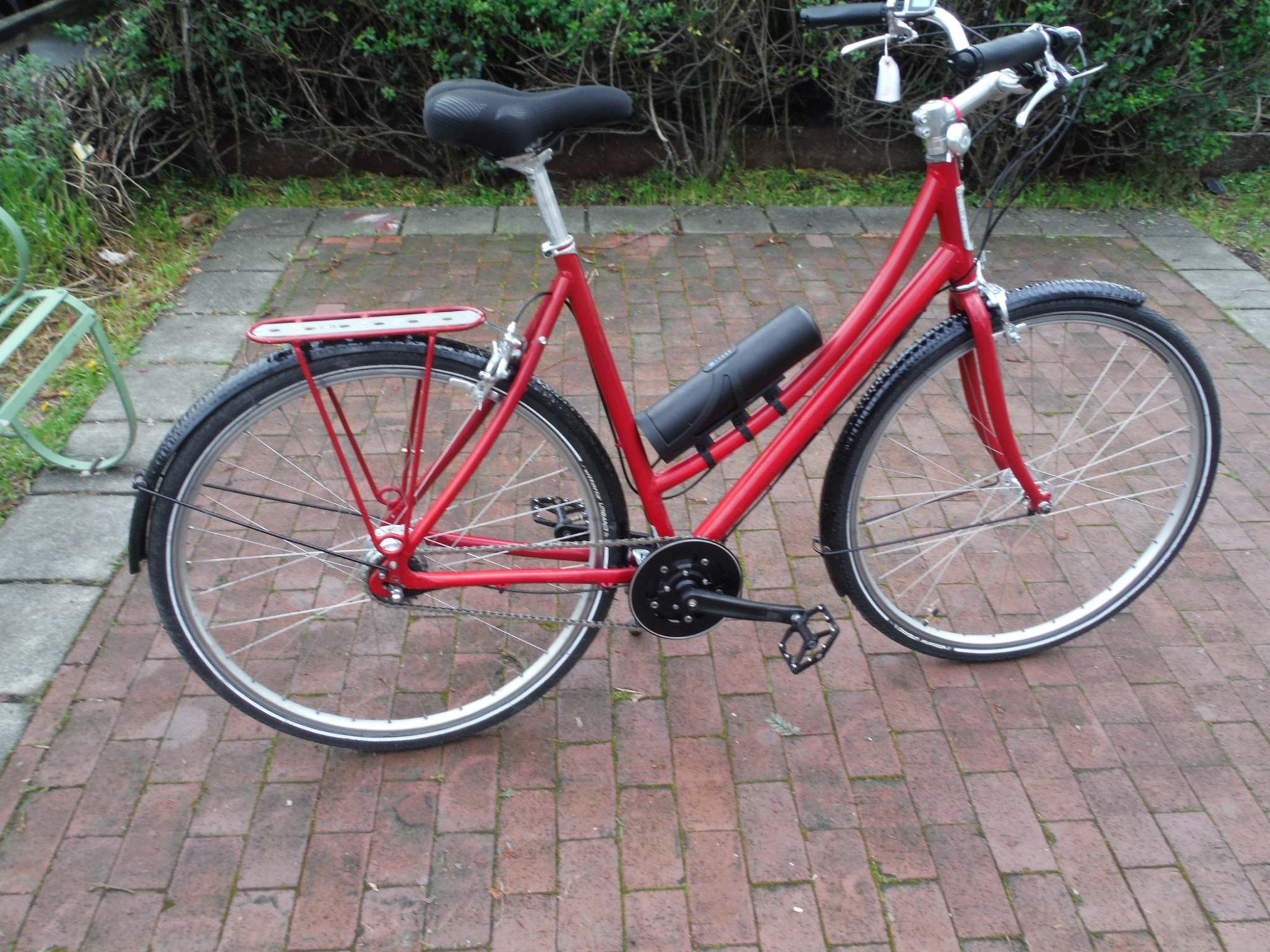

Thank you. It is so nice to have my art appreciated. I think that is why you find that Creme attractive. It is a three-speed with a coaster brake. That is the second one of those rare bikes I made electric. The first was called Union Jack and it had a gold half-link chain and gravel tires. I would put on a tweed jacket sip coffee as I passed roadies in Spadex on $4500 eBikes on climbs. I do not know Chemung. I grew up east of Poughkeepsie in horse country. FDR Jr.'s estate was on three sides and a 90 acre apple orchard on one. Lots of woods. Oh, read one review of the new book Forest Euphoria. Much of it takes place in NY forests. It is the best science book in a decade. You can still replace the saddle. Use lanolin under it to soften.

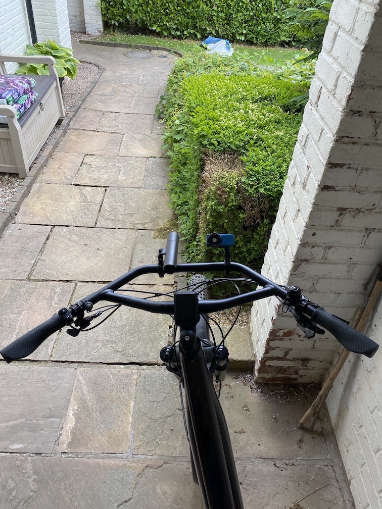

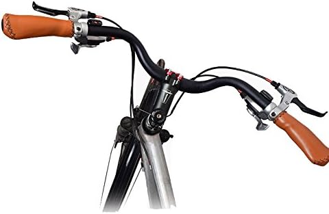

I didn't think I could change out the stem.
I had a Vado for a year, until the end of May. And assembled about one per week. One of the first things I did was to swap the bar. Yes you can easily change the stem. Just cover the display with a baby sock to forget that it has electronics.

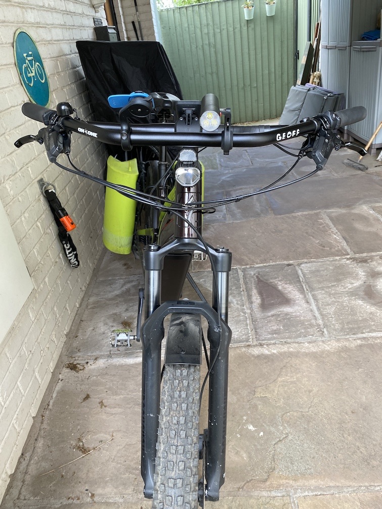

Nvreloader,
I see the stem, nice one, but not the reducer. I didn't think I would trust a reducer anyway.
As for changing the stem, I was intimidated by the way the computer is attached to the Vado. I didn't think I could change out the stem.
Advice? (I feel kind of stupid, having worked on regular bikes all my life. The electric and computer stuff intimidates me!)😰
BB
The handlebar reducers is the bottom Blue clicky link,
numerous styles/colors etc.
Under the stem...
tia
about covering the display
That is only while you move it to the new bar. It is humor, so you will forget that it is electric while working on it. I have purchased this handlebar 14 times. I put it on my Vado after trimming an inch from each end.
Ha ha on me; people who have known me a long time never cease to be amazed at my inability to recognize humor (I'm "on the spectrum"). Now that you explained it, I'm smiling.
BTW, which handlebars are those that you have put on 14 bikes?
