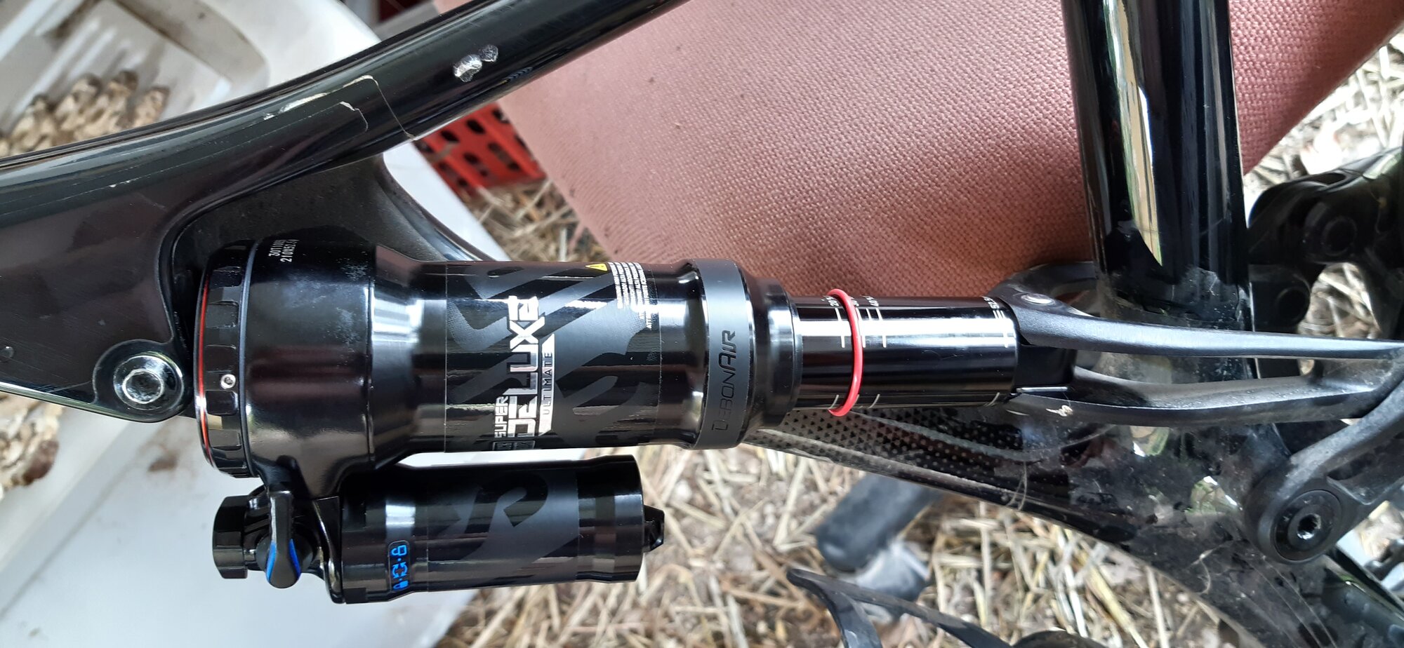

Time to brag....last week I replaced the fox dps on my levo sl with a rockshox super deluxe ultimate. Next level mind blowing experience. Now I know what people mean by " buttery smooth" , this thing redefines amazing . It's like the first time I replaced mid 80's jap crap suspension with an ohlins. WAY more than I need or deserve, but there is no going back now. As well as the 3 position lever, it also has low speed compression and rebound adjustment. The internal dampening ctack / shims can be tweaked to provide different high speed compression and rebound characteristics, AND the positive / negative air chambers can be tweaked. But that's not all.... for a few extra $ you can replace the air chamber with the meg neg chamber to adjust the midsttoke suppirt!

Try just adding some internal spacers / tokens to ramp up the air spring progression - it's a really easy thing to play with . You might get lucky and be able to borrow some from the lbs to see if they help
Aha! Good suggestion, cheers.
