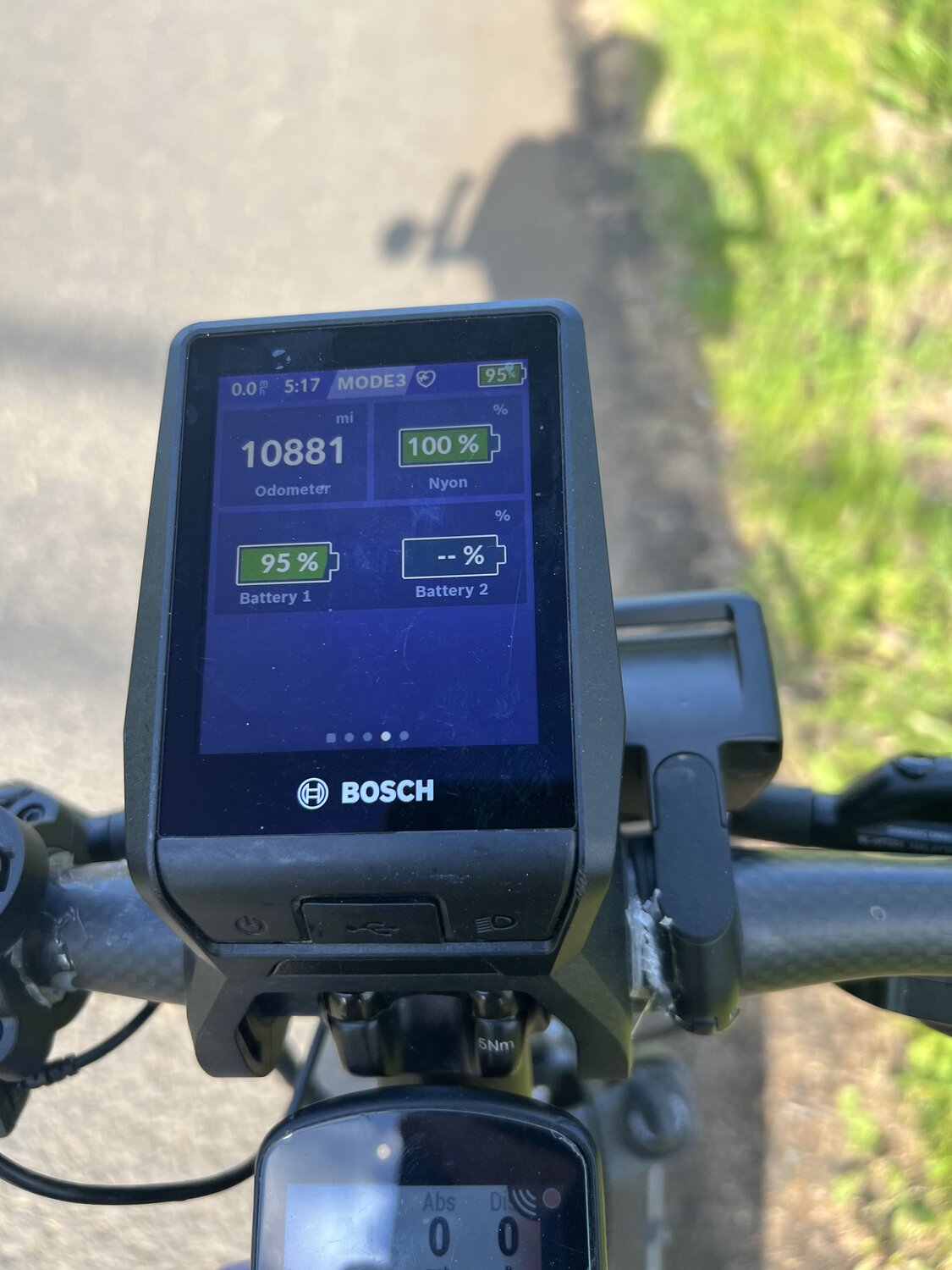

ok I think its a nyon bug. I put both batteries in turned it on. when it booted it shows one battery like so

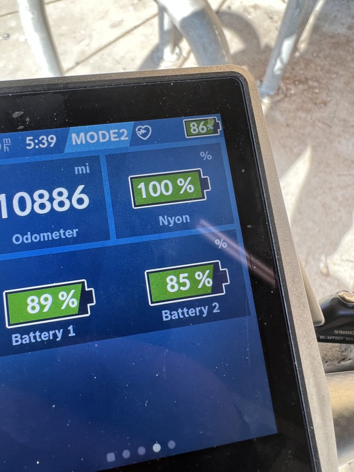

but the range looks right for 2 batteries so we ride and I stop and check still shows one battery. so I take one out the nyon aisle ike there is no battery then sees the battery and acts normal put the battery in now both show.
so the motor knows there are two batteries and operates right then nyon display just does not show two batteries if it boots up with two batteries.
