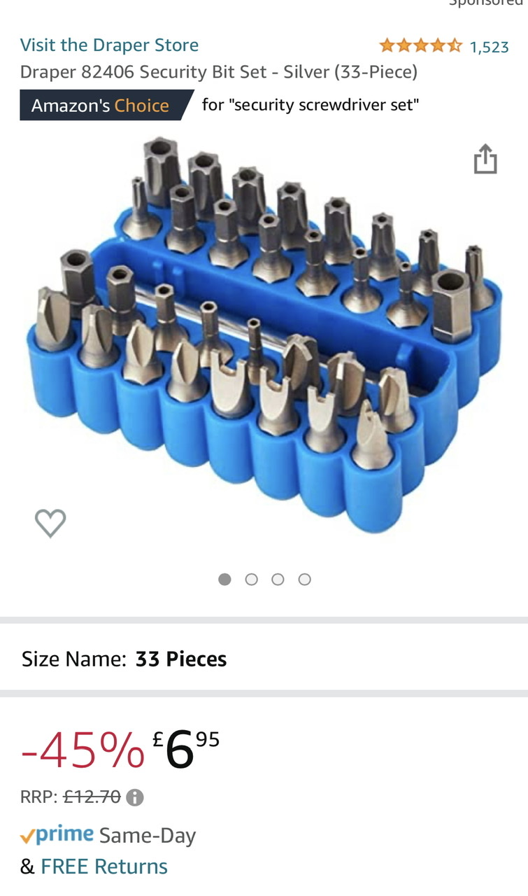

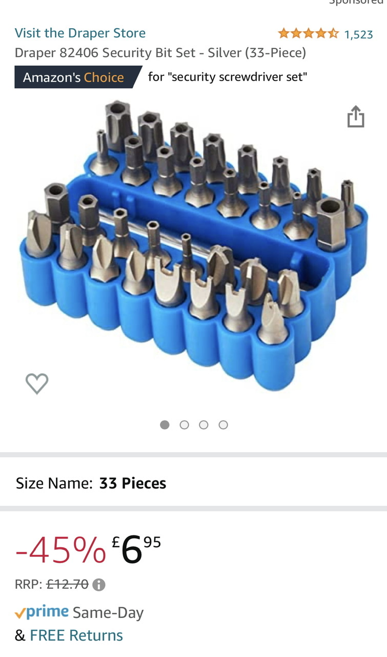

For my seat post, which can not use Hex Lox because the allen screws have internal threads designed for a rear rack, I use 3 mm security allen screws which has a pin that sticks up in the center of the hexagon and the screws are rounded so that no plier can gain a grip to force it open. I use this screw to close the hexagon opening on the seat clamp and to attach a rack when needed. It would be a VERY rare thief that would have that tool as it's not a tool that can be easily acquired, typically. I use the Hex Lox thru axle for my front wheel and leave it that way if I will have my bicycle out of my sight for not more than 10 minutes (i.e., going to the bathroom). If it's long than that I will take my front wheel off and place it into my alarmed D lock along with my rear wheel and frame, all attached to an heavy duty external anchor.
These type of Allen Keys are readily available on Amazon and at other sites and, cheap.
Like all bicycle theft defenses, I'm playing the odds. Even in your example, the thief would have to know what to look for even though few people actually use hexagonal security screws on their bicycle, look for this set on Amazon and buy it, not to mention carry it around even though 99.99% of the time they won't run into the need to use it. In fact I'd guess that a bicycle thief is more aware of Hexlox removal methods than having a 3mm security hex tool on them. As it is, though, in my particular case, in using a Specialized seat post clamp designed to be attached to the forward clamps of a trunk rack I have few alternatives though I could purchase a round headed hexagonal screw and place a Hexlox into it also. I can also purchase the expensive (more than $150) and far more bulky Thread Lock.
Note, too, that the tool you found is of VERY poor quality with the center holes not centered well at all. That tool set also is comprised of cast metal, not machined, and the tools there either may break easily or not fit, incredibly. However one can get a better tamper proof kit than that one on Amazon.
So, with your reply, I edit my initial statement to substitute the "not a tool that can be easily acquired" into "not a tool that most any thief would have acquired".There, better now. ;)
