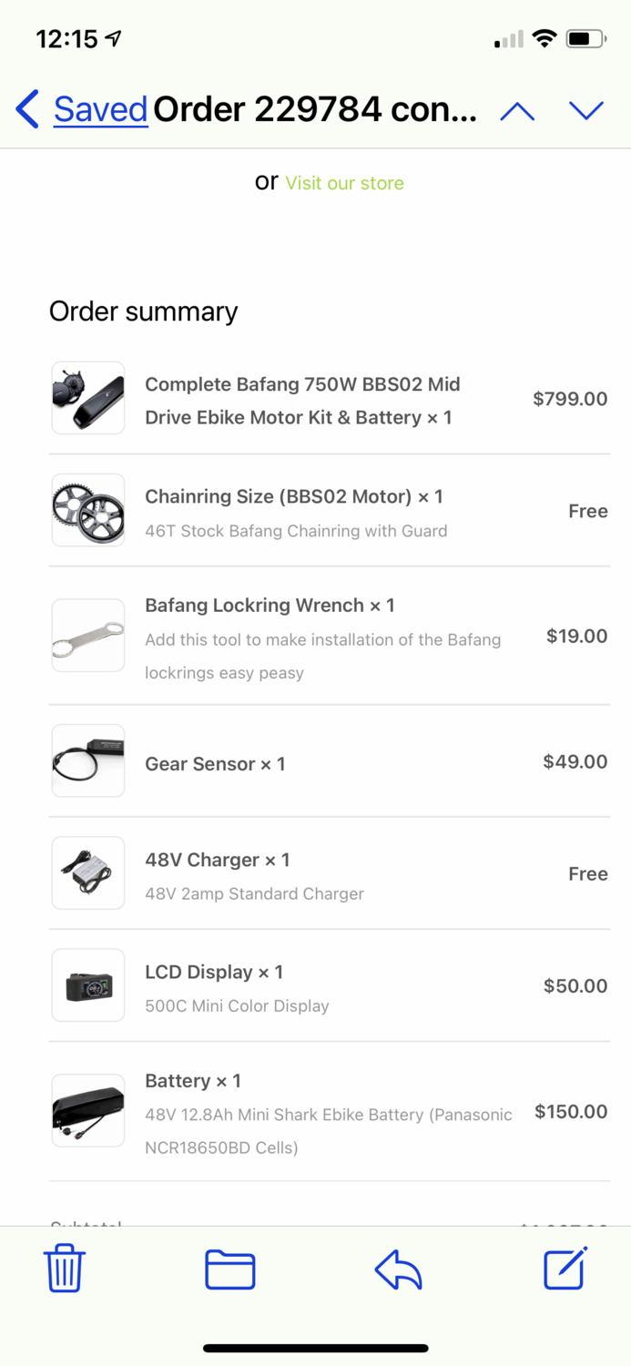

So I just ordered a bafang mid drive conversion kit! And as many of you know the Bafang customer service has a lot to be desired! Won’t answer simple questions like 1- what type of chain do I need for my conversion
2- Are the teeth on the ebike chain ring and sprocket the same size as the teeth on a mountain bike( chain ring supplied need th know if I need to change sprocket) Hope you all can give me some good advice

1) That depends on how many speed you have on your bike. Chain size are different, as you may no...6 speed chain are a lot bigger than 12 speed chain.
2) Yes, ebike are basically bicycles, chains, sprocket, chainrings, etc.. are basically the same thing.
That is the answer I was looking for!! They’re the same. But you brought up a good point. My bike is a 24 speed but the three cassette chain ring comes off need to install Bafang single ring which makes the bike an 8 speed
