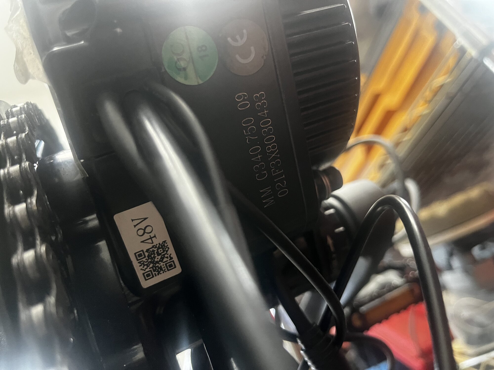

Hello, I’m building a e-bike conversion from a mtb using what I hope to be a BBS02 750w mid drive motor. After installing the motor I notice that the sticker that’s included in the kit which gets affixed to the bike frame shows it to be 250w. Judging by the printed numbers on the motor itself I’m guessing it is in fact a 750w. There is no other documentation included in the kit. I’ve seen other posts asking similar question, and likewise would like to know if I’ve received what I ordered. Thanks for the help-
The serial number and 48v controller indicate to me that it's a 750watt.
The sticker for the bicycle was probably just to get around import/use restrictions. A lot of that going around.
The 250w stickers are supplied for the European market that don't have permission to play with adult toys. 🙃
