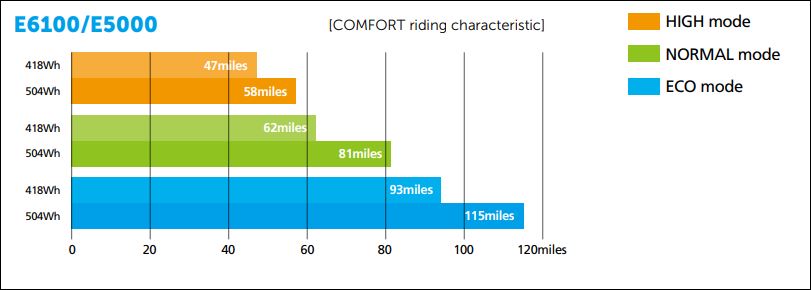

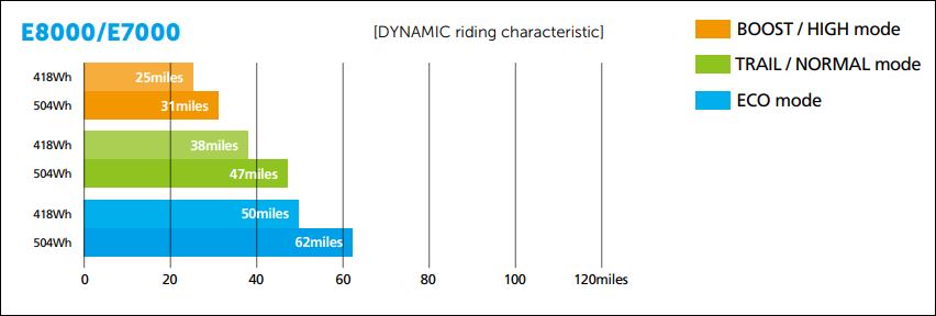

I have found these range estimates to be very close to reality when I am cycling on and off-road.

As long as we've revived the thread, thanks so much for this! These estimates seem to be for a 510 Wh battery, or that's what I'm guessing. And it's worth noting that BD/Motobecane even puts the 40 Nm E5000 on an MTB! I own the ULTRA eAdventure which has the E5000, and fortunately, weights only 49 pounds in a 48cm frame.
I find that the E5000 has no problem with 15% grades on pavement, and is fine on over 10% on gravel, though I plan to test it today for the first time on 15% dirt with some rocks.
The E5000 is still a bit underpowered, which is fine because I like a good workout-- I was wondering if the 6100 would have a slight range penalty in comparison, and apparently it does. I'm really glad I did not get the E8000 and E7000 because where I live they would be nearly useless.
My real world experience is that the E5000 has a range of 40 miles including 4,000 feet of vertical with a 418 Wh battery. It may well get 93 miles on flat terrain, but where I live, I will never find out unless I drove down to Sunset Blvd. and just drove back and forth all day.
