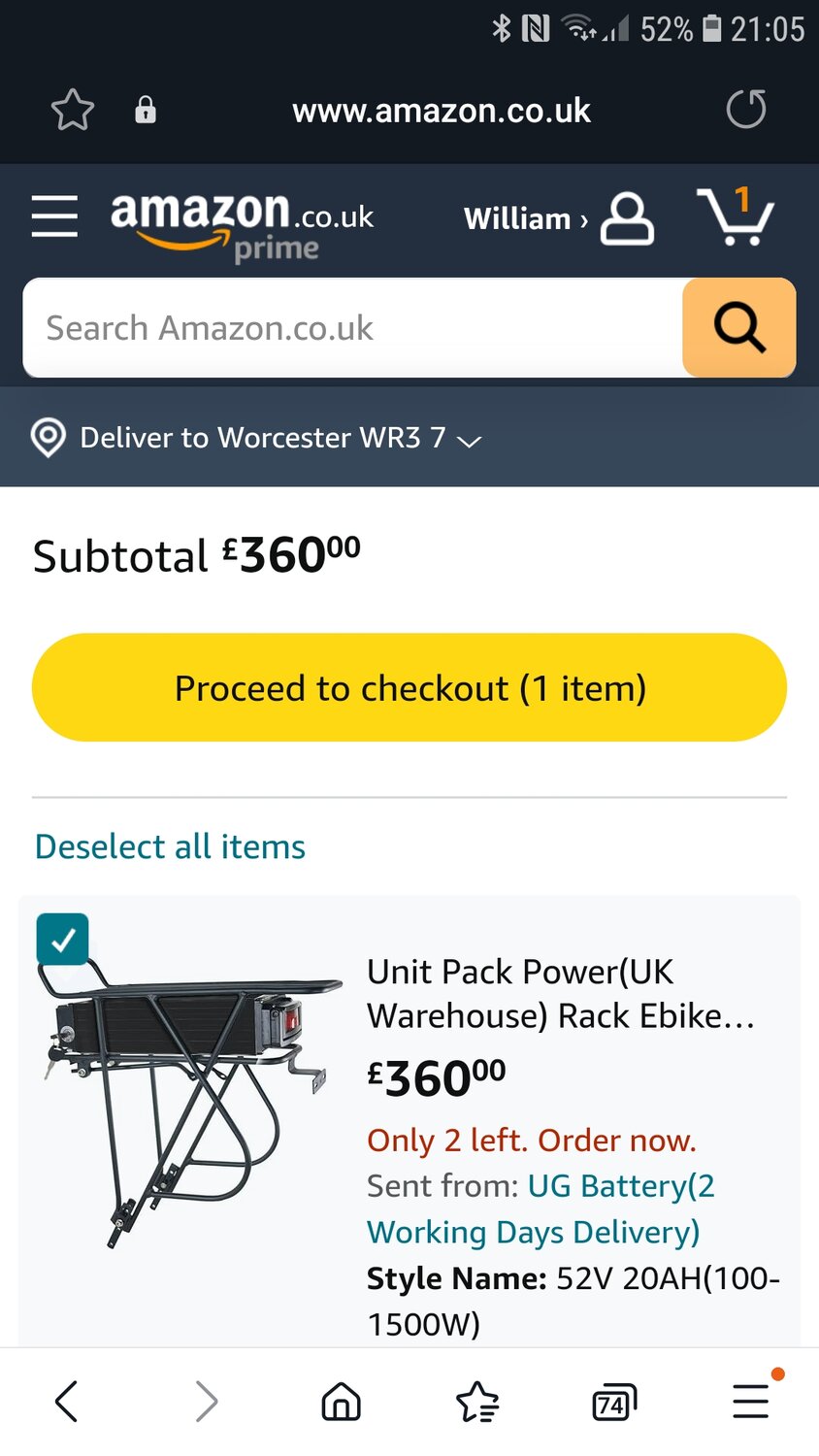

I need advice regarding purchasing a new battery and will I need a motor controller or it's that part of the battery pack?
Would this battery work?
Than you in anticipation for any advice.

I couldn't find a manual online for the Outlaw 1200 model but there is for the Outlaw SE and the Outlaw SS models. Assuming similarity, look on page 26 and it says the controller "is located in the battery base which is attached to the bicycle. The battery base is the box where the key inserts for the ignition. The bolts holding the cover to the base can easily be removed within a few minutes. Once the cover is off of the battery base, the controller can be disconnected." On page 29 the specs indicate the SE model came with a LiFEPO4 51.2V 9Ah battery, so your suggested battery should work, provided you crimp on matching Anderson power connectors, and you'll have to find some other way to remount the existing controller, maybe something like a waterproof controller bag with grommets for the wires.

You should choose a controller that can be programmed to lower the current drawn to match the current to which the battery's BMS is rated. Either that or buy both controller and battery from Woosh. You won't need the throttle as they're not UK legal. But now you mention it I recall some Prodecotech US models were Class 2 with no pedal assist, so depending on your model you might need Woosh to supply a new controller plus a pedal assist kit (wheel speed sensor & crank/axle PAS disk), new display with PAS selector switch, and a main wiring harness with matching connectors to make all the components work together. It might be cheaper and simpler to buy from Woosh a new rear hub motor wheel kit with battery.
