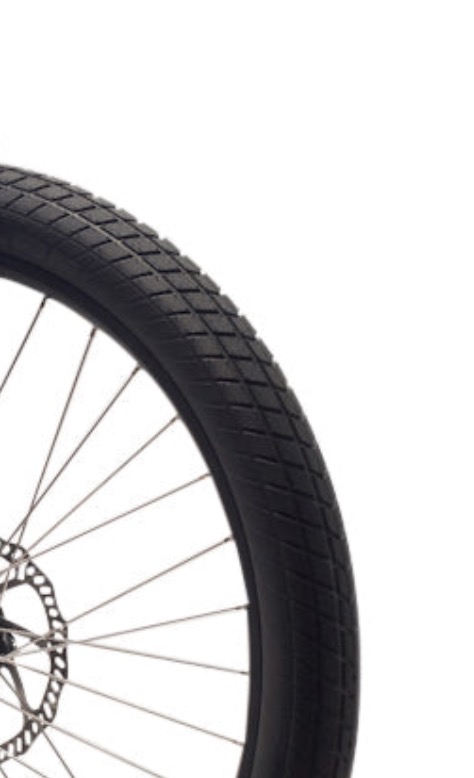

Innova Tire

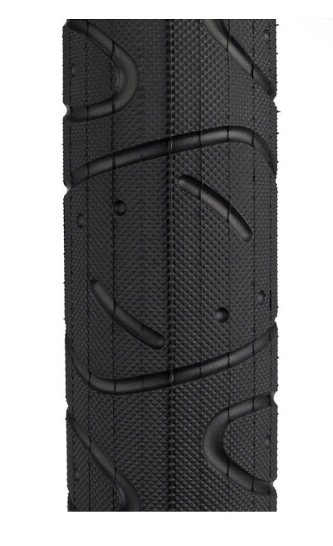

Maxxis Hookworm

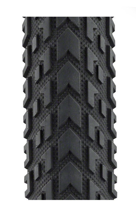

Surly ExtraTerrestrial
