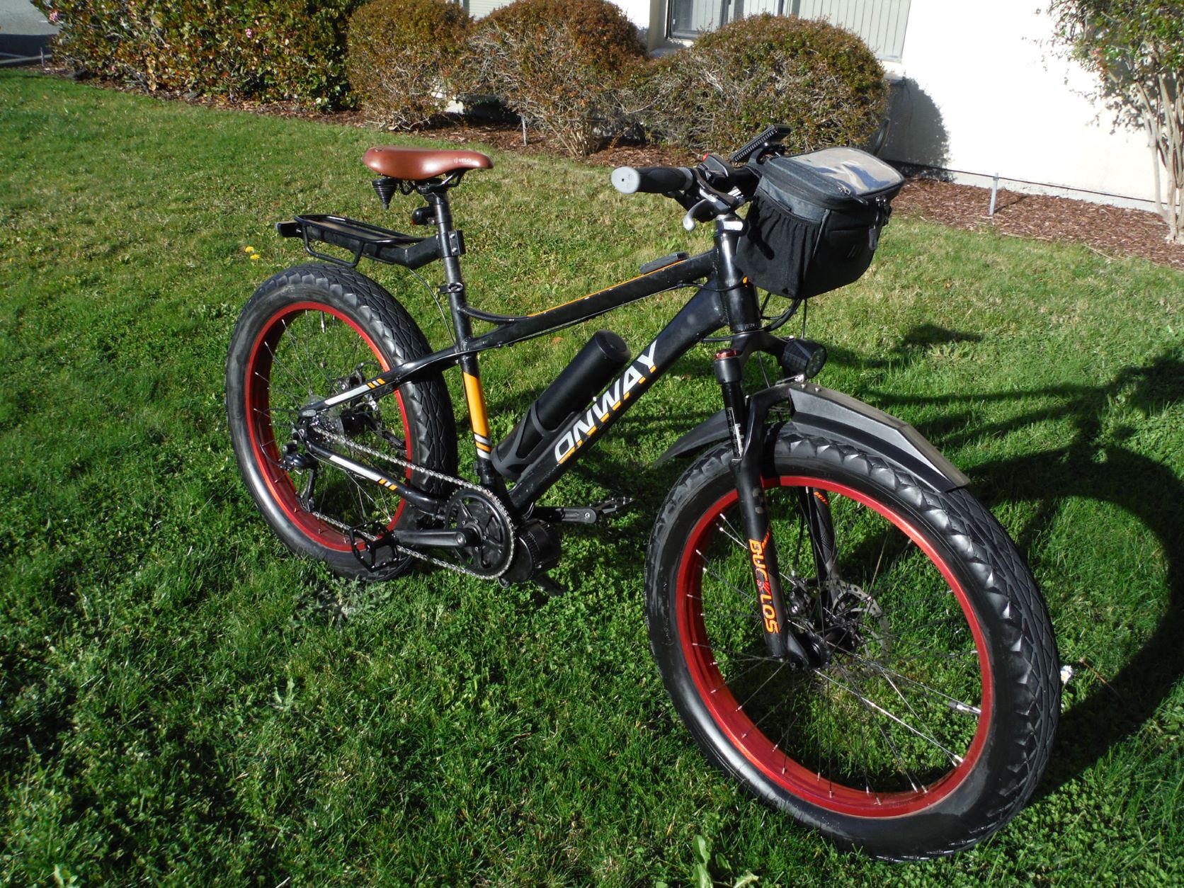

I have never heard of 112 BCD, it must be the 110 standard. New ring = new chain. Go for a 10mm offset chainring. That will bring in the chain line so you can hit the low gears without cross chaining. This bike came in with the offset flipped the wrong way. I fixed that and gave it the thru frame treatment.
