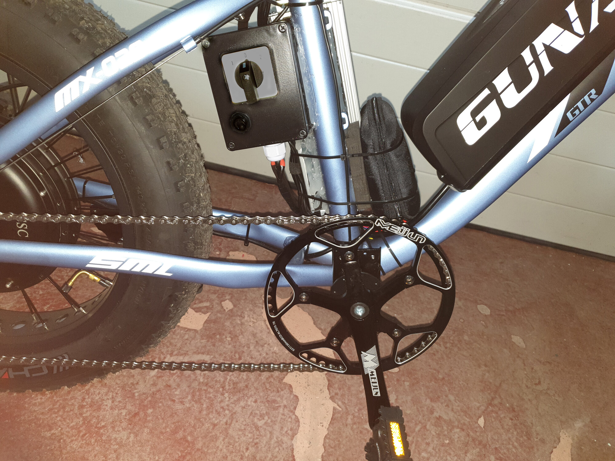

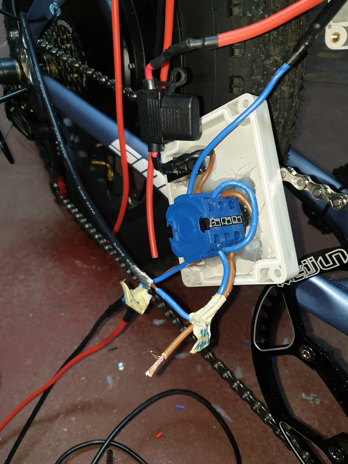

The real reason for asking for advice is on how to connect them so I use one and once it needs recharging I flick a switch and I connect the other; they will never work together.
In the market I see many 3 pole selectors and the way they are connected is to have a common negative, joining all three negatives (BAT1+BAT2+Controller) and the three positives connected into the selector where you have three options (0 or no connection, BAT1+ or BAT2+)... My doubt is if having the negative poles all joined together permanently, can affect the operation of this system.

I would do it that way. Common negative does not make a circuit. Paralleling two batteries with two different bms boards leads to uneven charging. bms board evens out the charge in multiple stacks of cells during the monthly or quarterly full charge. A two way plus off switch keeps the batteries from being in parallel.
Make sure the 2 way center off switch is rated for the current your controller will deliver. My best controller delivers 30 amps. 500 watt controllers are 10 amps at 48 volts. I've never seen a 30 amp rated 2 way center off switch. Only single pole ones.

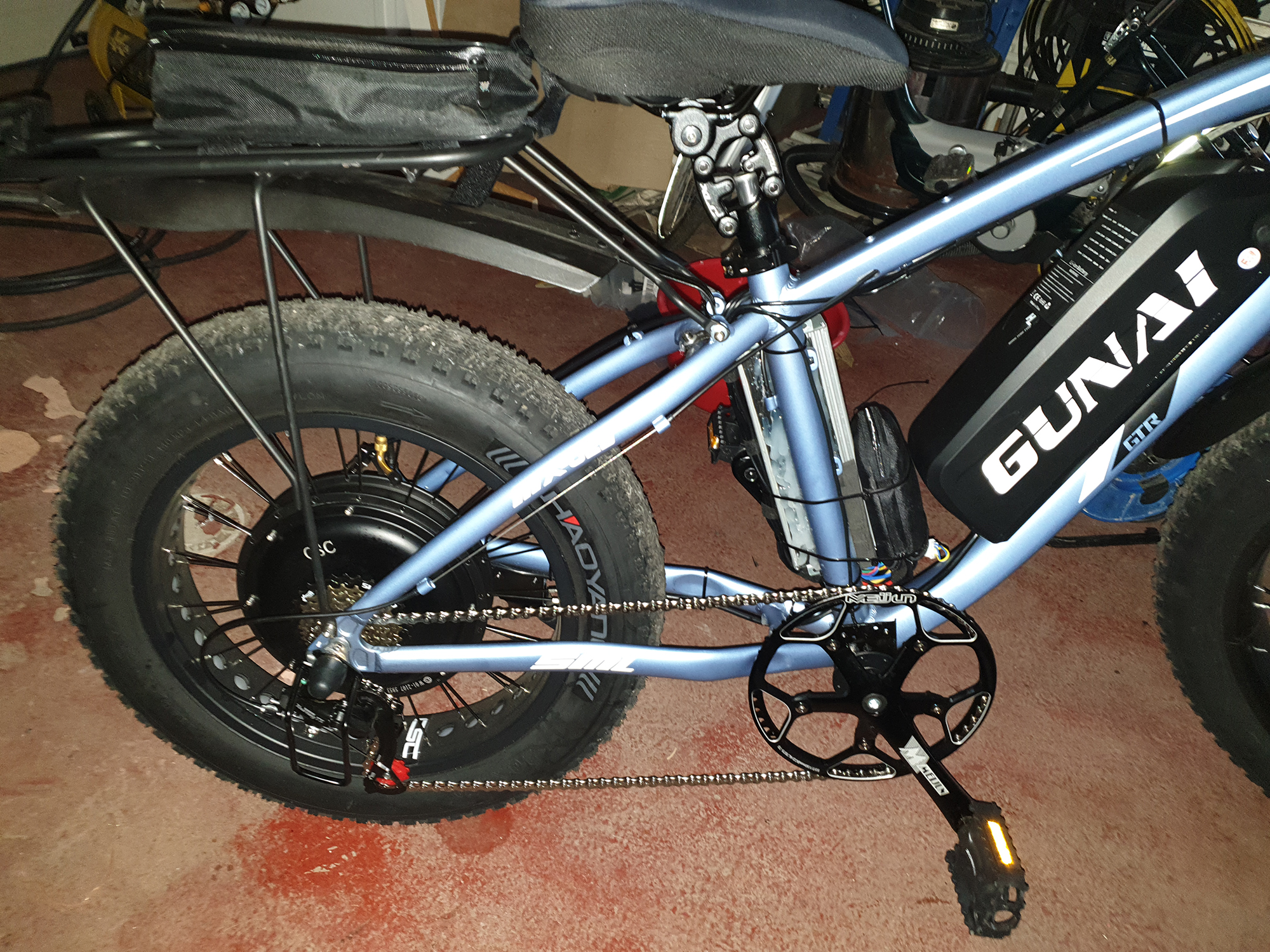

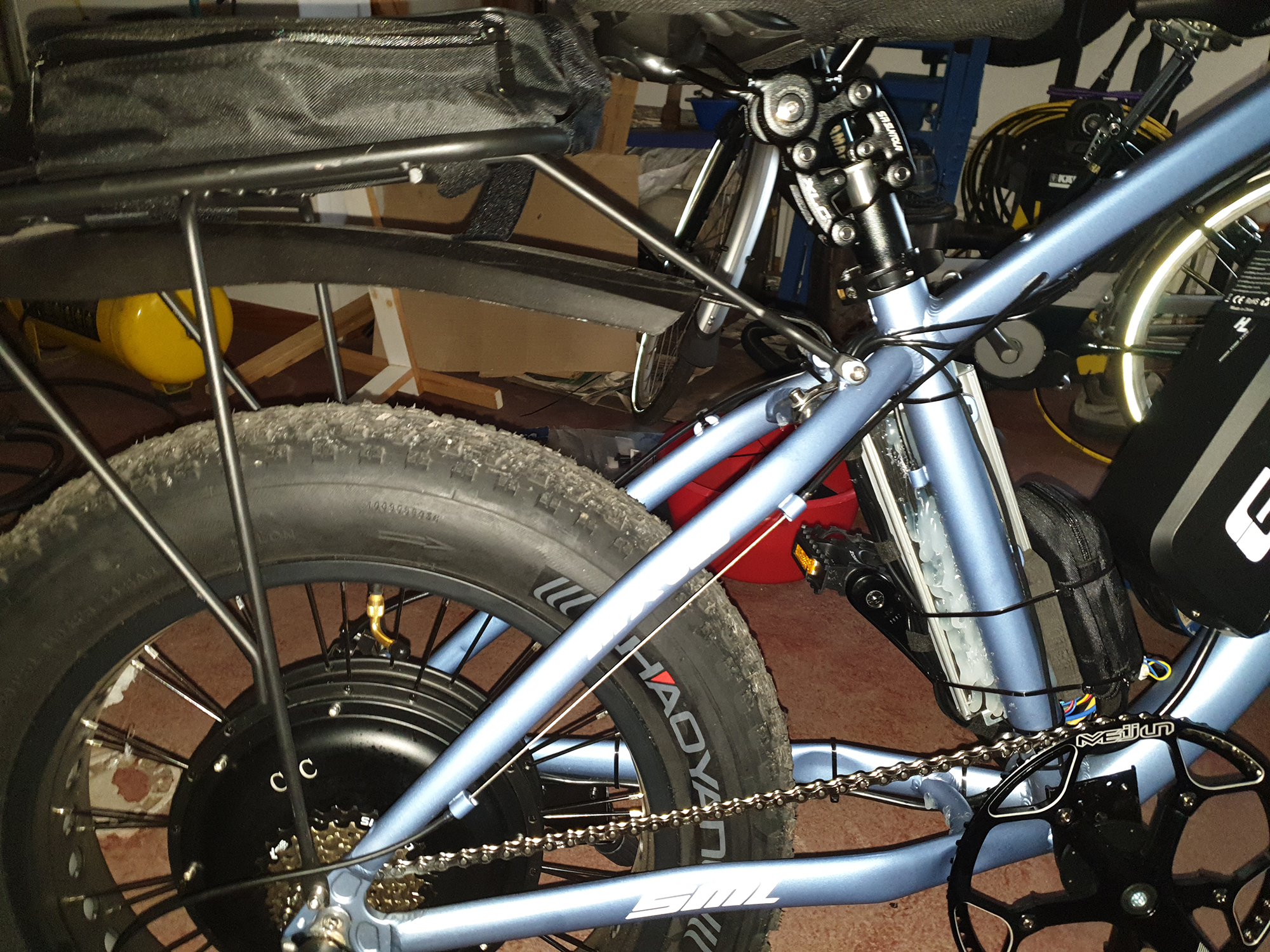

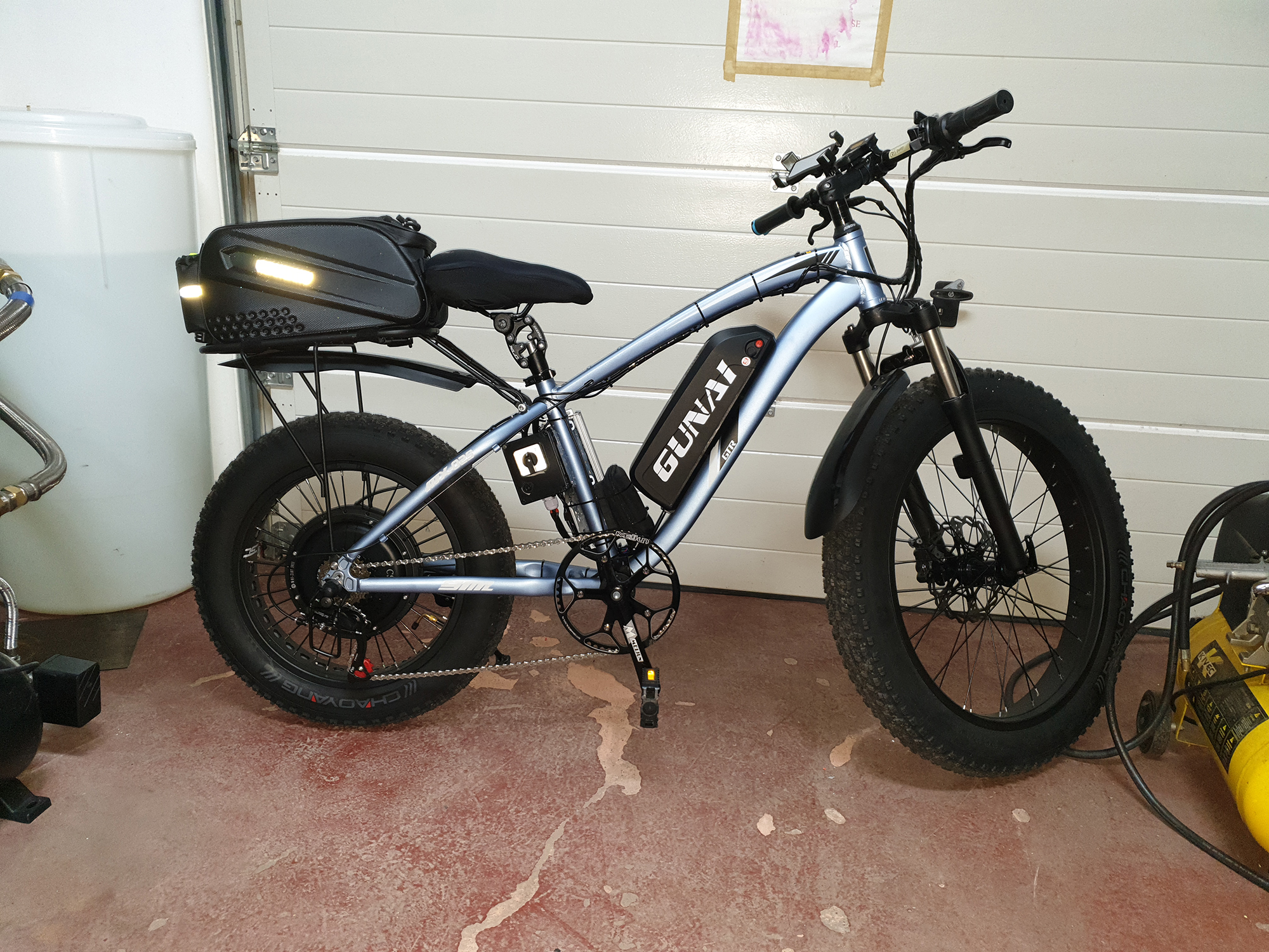

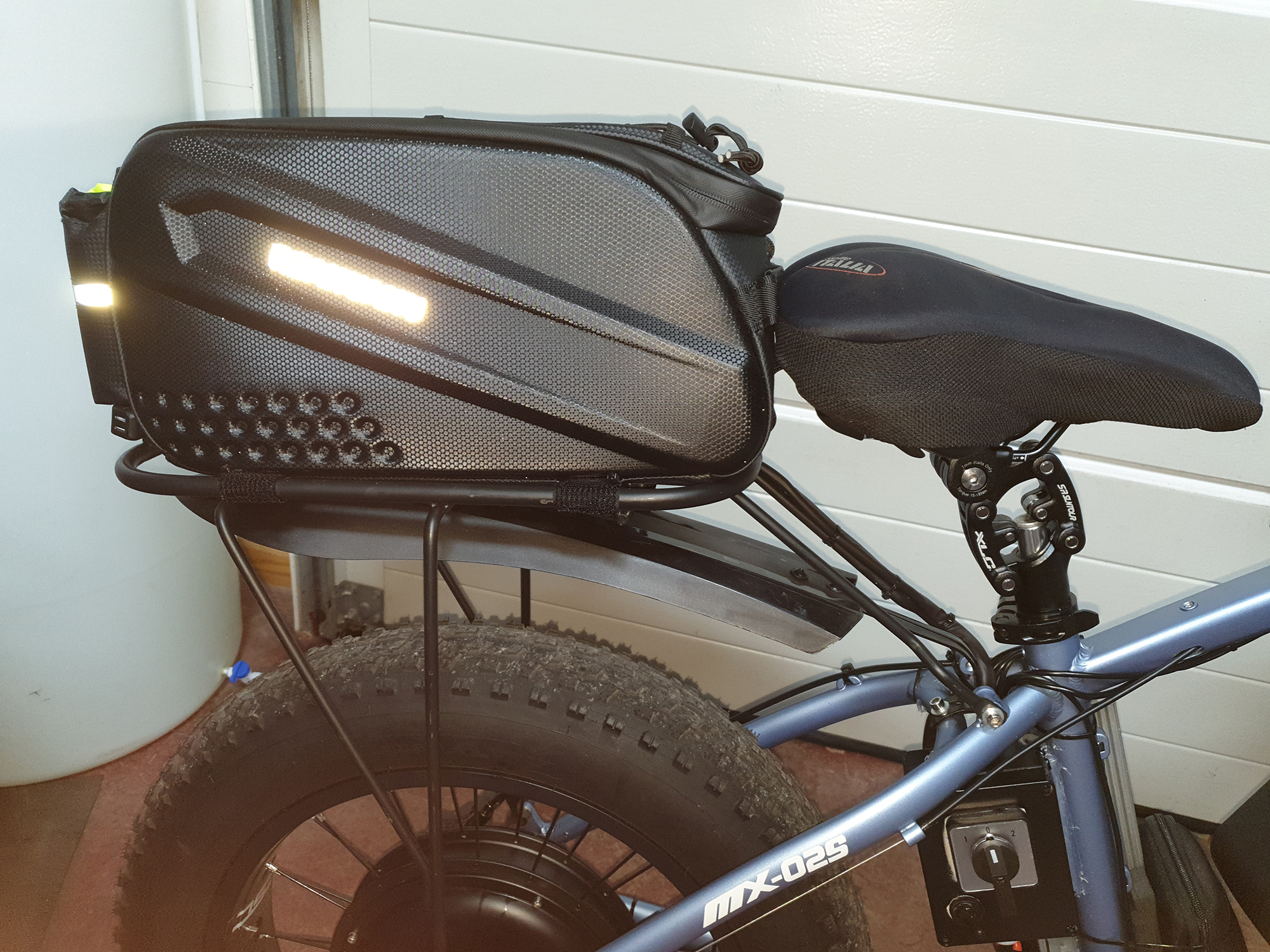

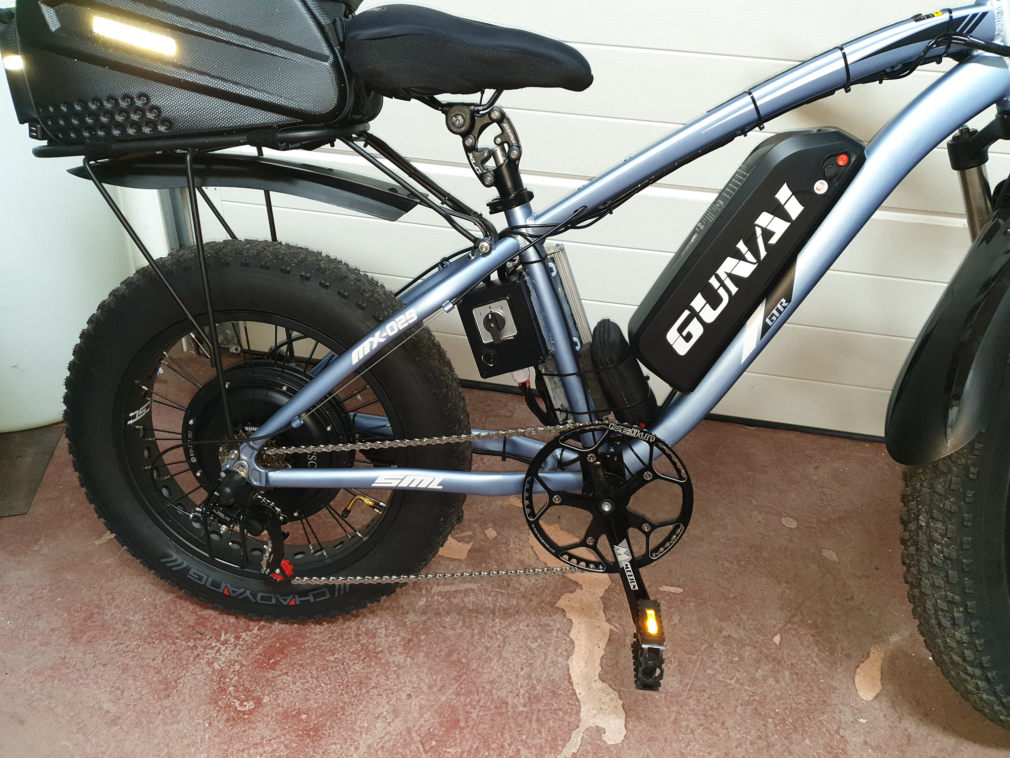

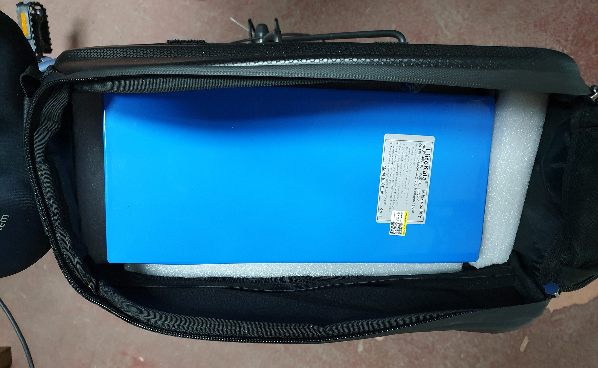

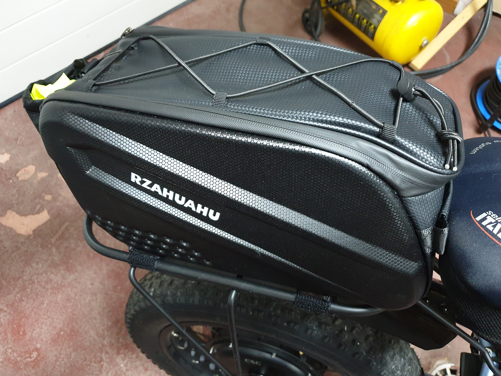

Anyway the battery is a LiitoKala 48V 30A that I have fitted to a rear bag. Have added a switch box so I can select 1, 0 or 2, being 1 the original battery (a 48V 17A) 0 means all batteries disconnected and 2 makes the new battery do all the work. Have also added several fuses for protection. A month ago I replaced the rear wheel for a 20" and added a few more watts to the hub motor (was 750 originally and now it is a 1500W and that was the main reason to add another battery), I have mentioned this before, but just in case someone hasn't read it. And the 20" wheel is so I could firmly put both my feet on the ground; I'm 5.7 feet tall, but have an incapacitated left foot after a bike accident in 2009, and have an external prosthesis that makes me very clumbsy walking so just imagine riding a bike...
Have added a few photos so you can get an idea of what I have done.....for the time being.
