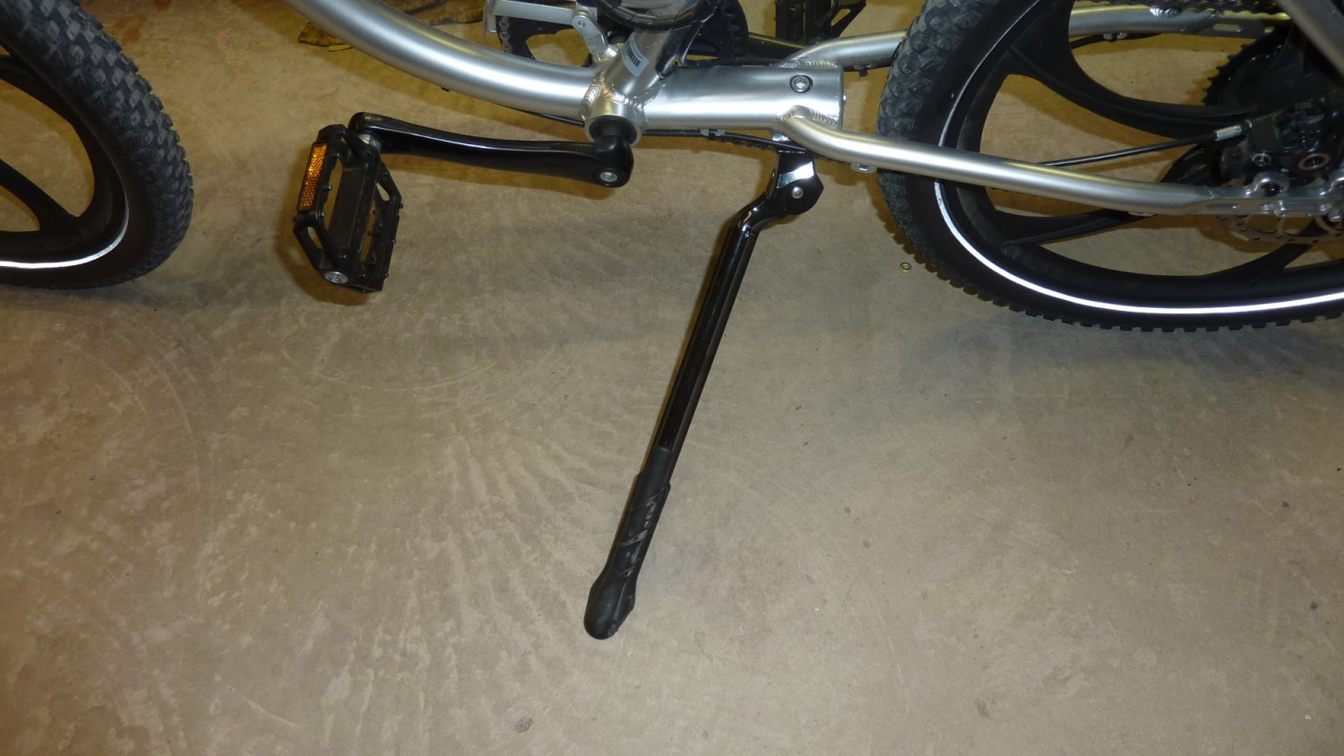

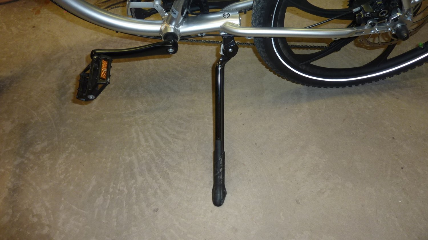

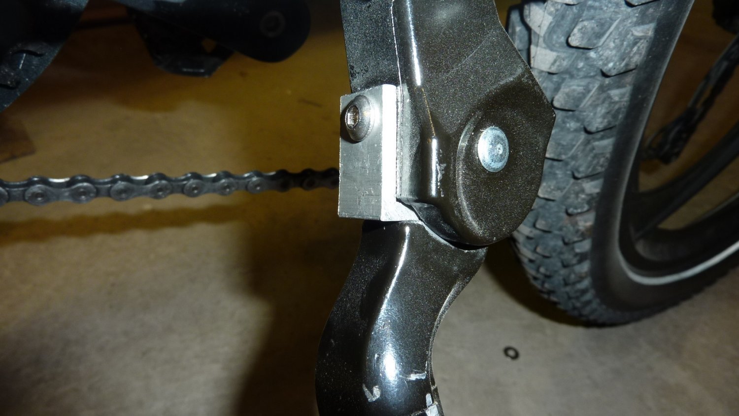

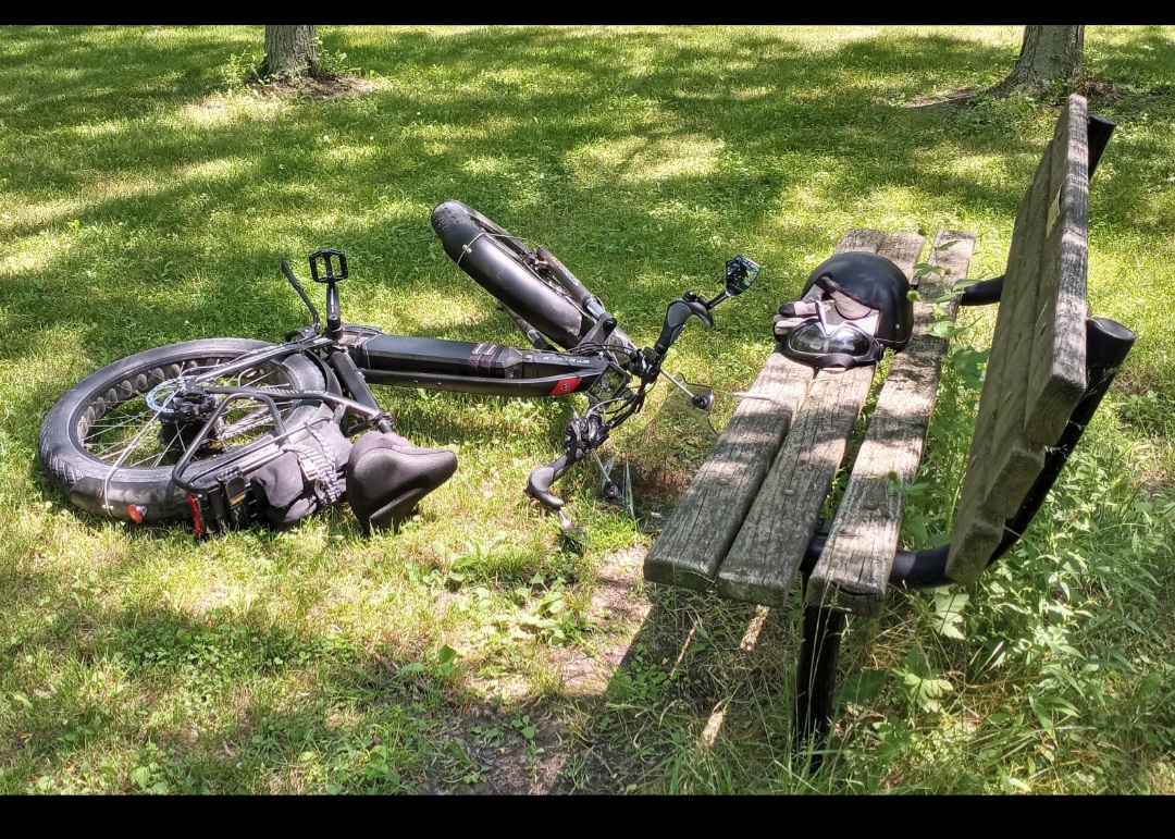

The problem with the OEM kickstand on the Pedego Interceptor is, the ground contact point is too far forward. This makes it unstable, especially with weight on the rear rack. I solved the problem on my Interceptor by adding a shim:
This moves the ground contact point about 5" to the rear, making the bike much more stable
This solved the instability issue for me, even with 30# of gear on the rear rack.

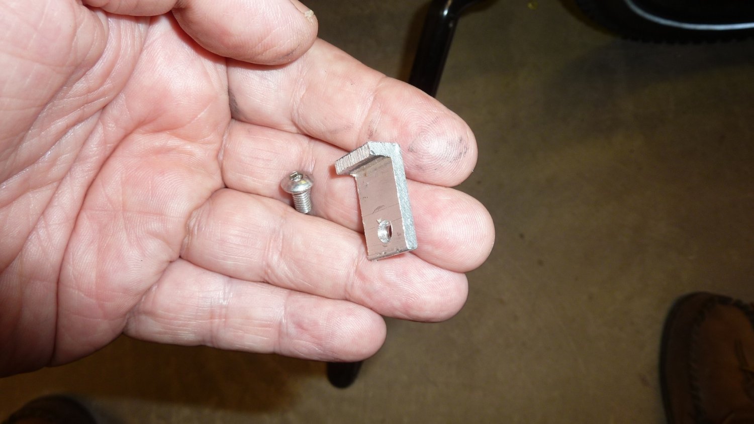

The shim is made from a piece of 1" x 1/8" thick aluminum angle, available at Home Depot:
https://www.homedepot.com/p/Everbilt-1-in-x-3-ft-1-8-in-Thick-Aluminum-Angle-6410/332733242
I used a screw to hold the shim in place but a metal rated epoxy works just as well.
