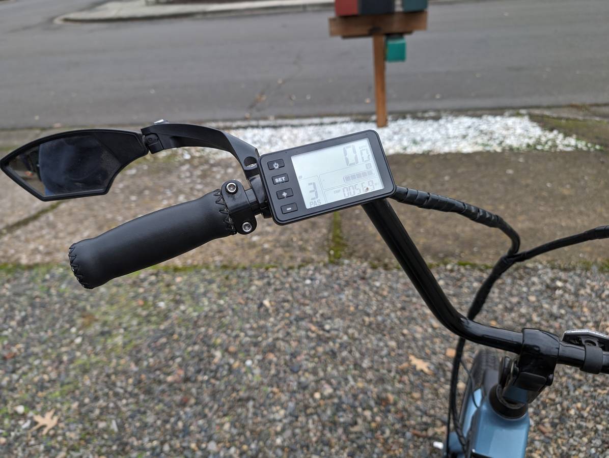

Pedego etrike controller C500B, Would like to, Switch out. Controllers. (, And upgrade it). With another controller. C500B. With more options
I assume you are talking about an aftermarket controller and not one from Pedego.
It is unlikely you will find a new controller that is plug & play. Considerable DIY skills will be necessary.
A controller swap can be done but you will most likely have to cut & solder wires since the connectors won't match. You also need to make sure the new controller is compatible with other bike parts like the motor, display, brake lever disconnect, PAS and or torque sensors, etc.
