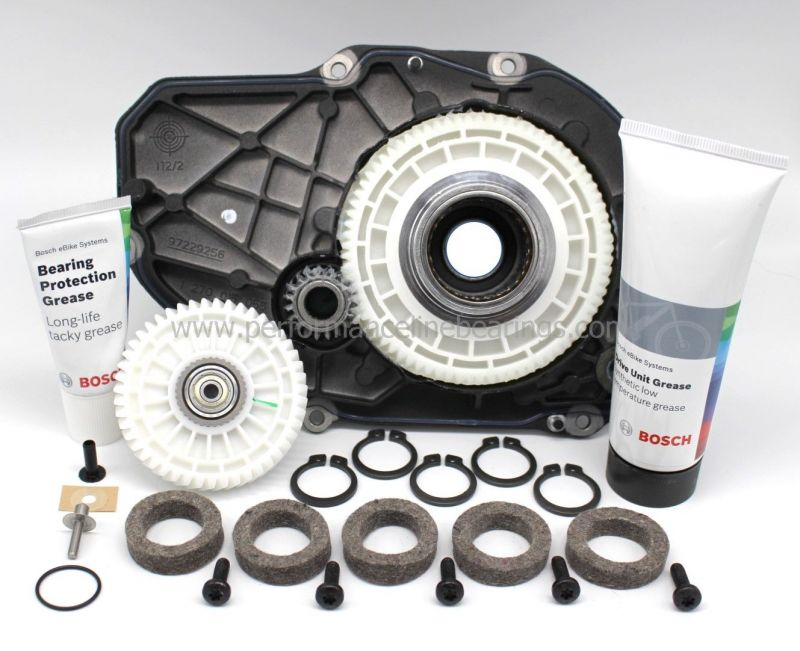

bearing overhaul kit would be this one for the Mahle DU

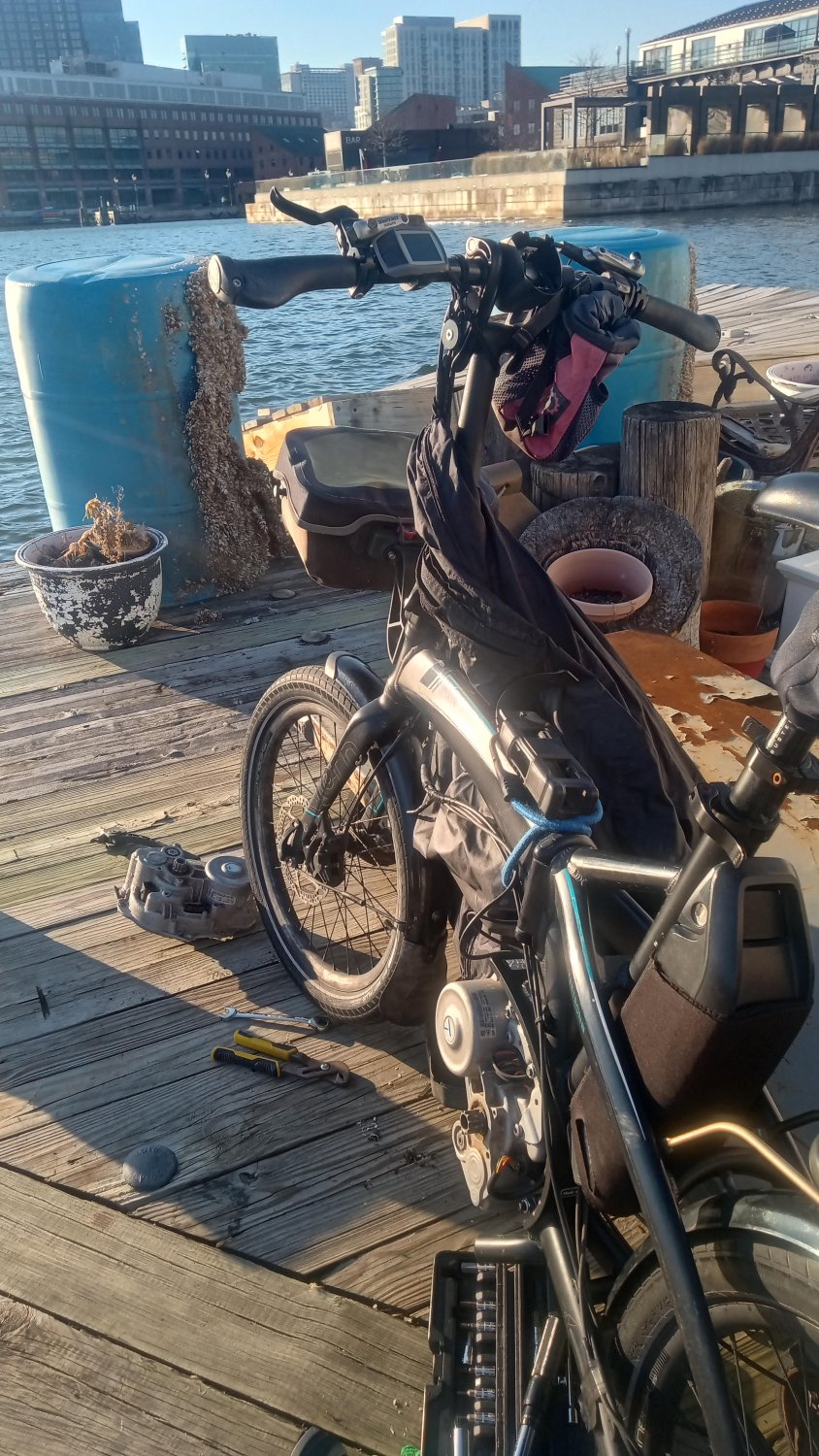

And I priced the overhaul kit on eBay. The motor cost me $50 more, but well worth it. The engine failed near my boat in Baltimore. I walked it back to the dock, where I landed up doing the work on Feb-10 outside. It was a quick job on the first day above freezing. Totally worth it. And the engine failure was not premature -- I got an additional 1500 miles or so on it after the bike fell in the Chesapeake Bay.
