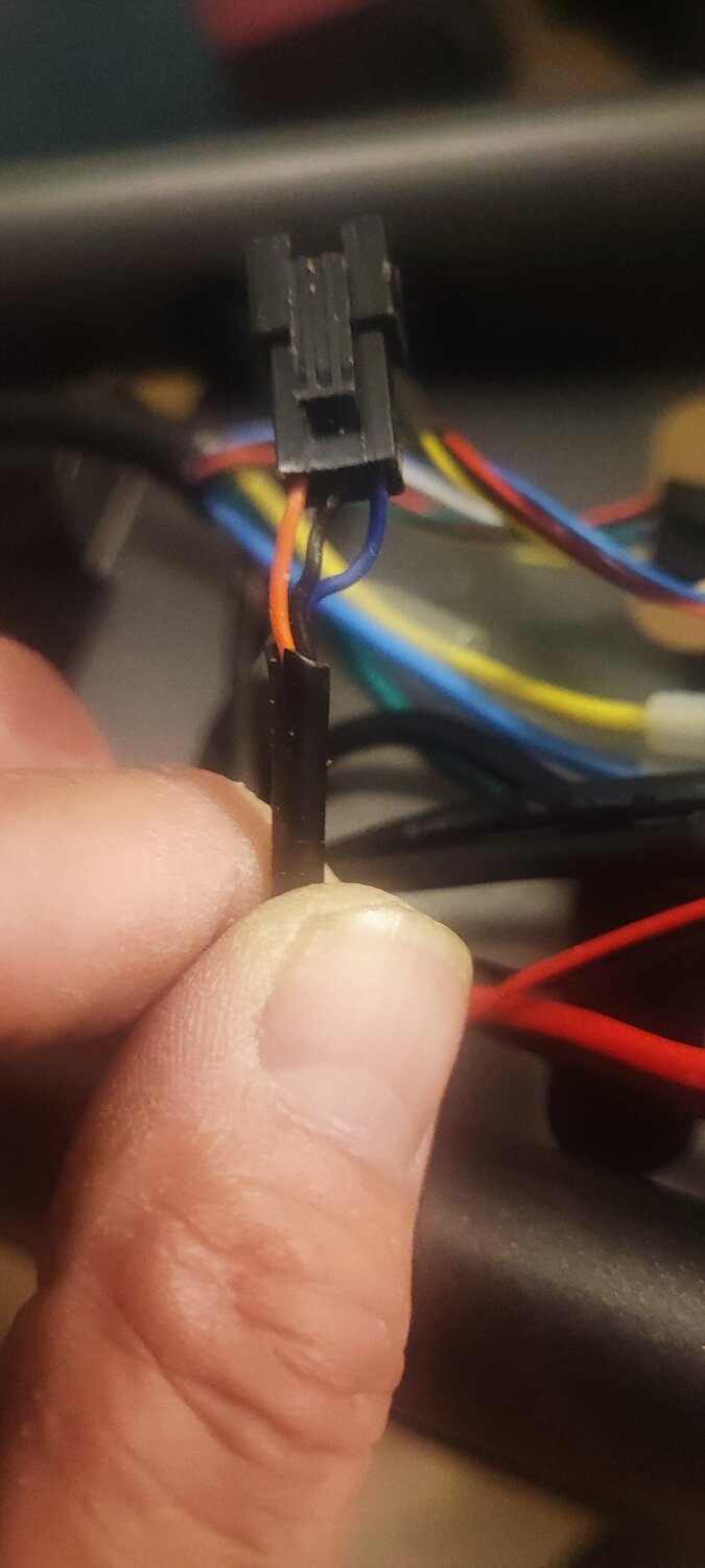

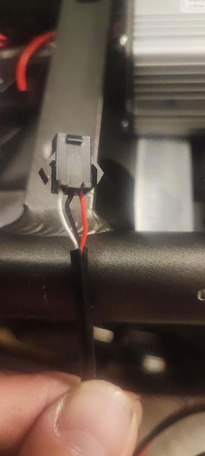

So my pedal assist connector is orange black and blue coming from my bike,my problem is that coming from my controller it is red white and black,I'm not very electrical I'm 14 but does anyone know what would be the correct combination.im guessing black will go to black any help please
