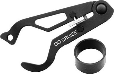

The PAS speeds on my bike aren't programmable either. Instead, I use this cruise control device which clips onto the twist throttle:
It holds the throttle at any speed you choose. You then pedal to assist the bike rather than it assisting you. You can apply as much or as little pedal effort as you want. I find it actually improves range by eliminating current surges caused by variations in pedal pressure when using PAS.
Setting the throttle like this describes the power based PAS systems to a "T". It takes your speed right out of the picture. Power based PAS let's you assign a power level much like you are doing when setting the throttle with the "cruise". Each PAS level would have it's own throttle setting. You want/need more assist, go to a higher PAS level with power based PAS, or with a higher throttle setting using the "cruise". End result is the same....
