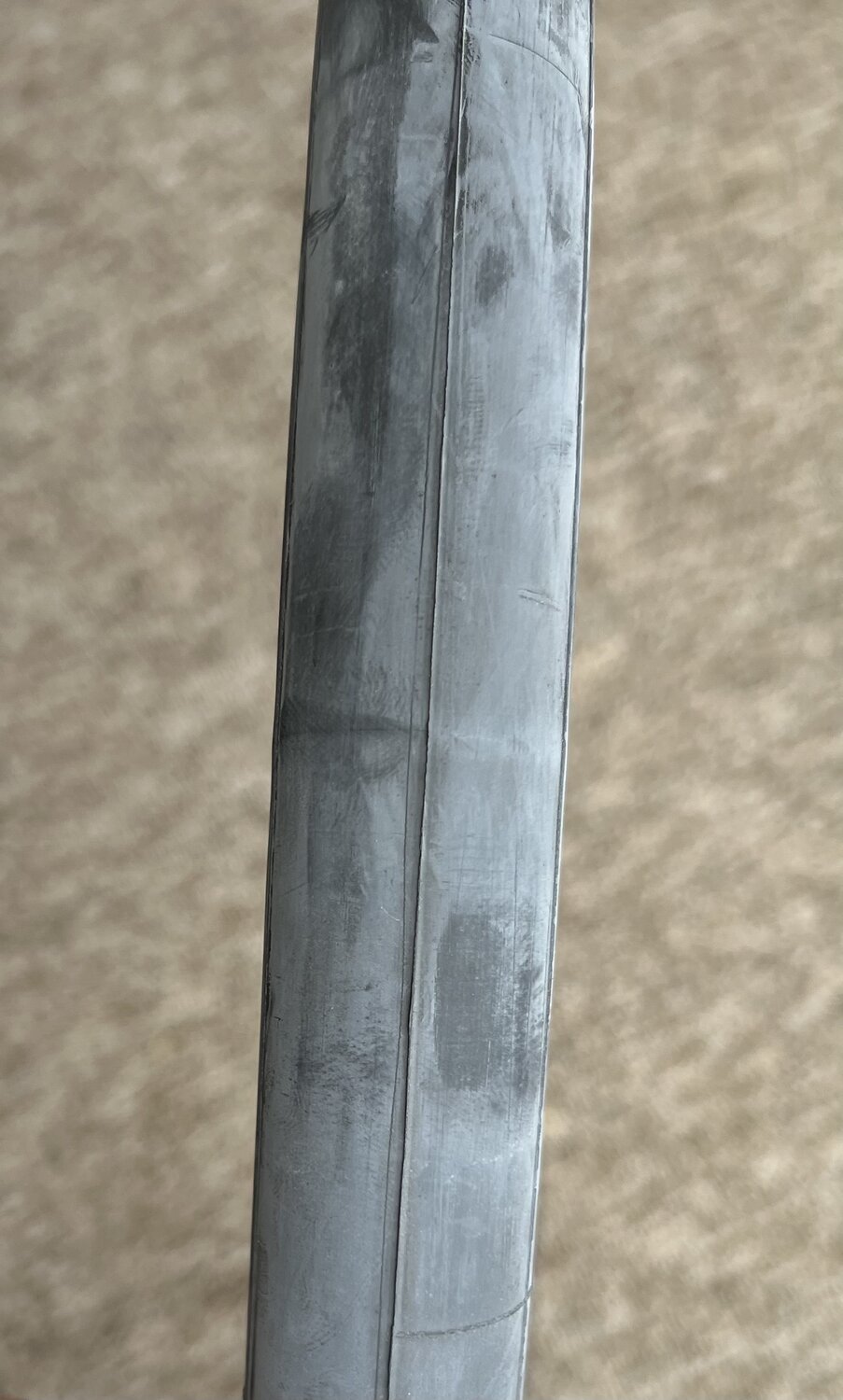

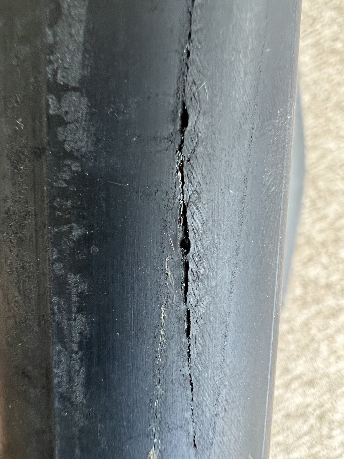

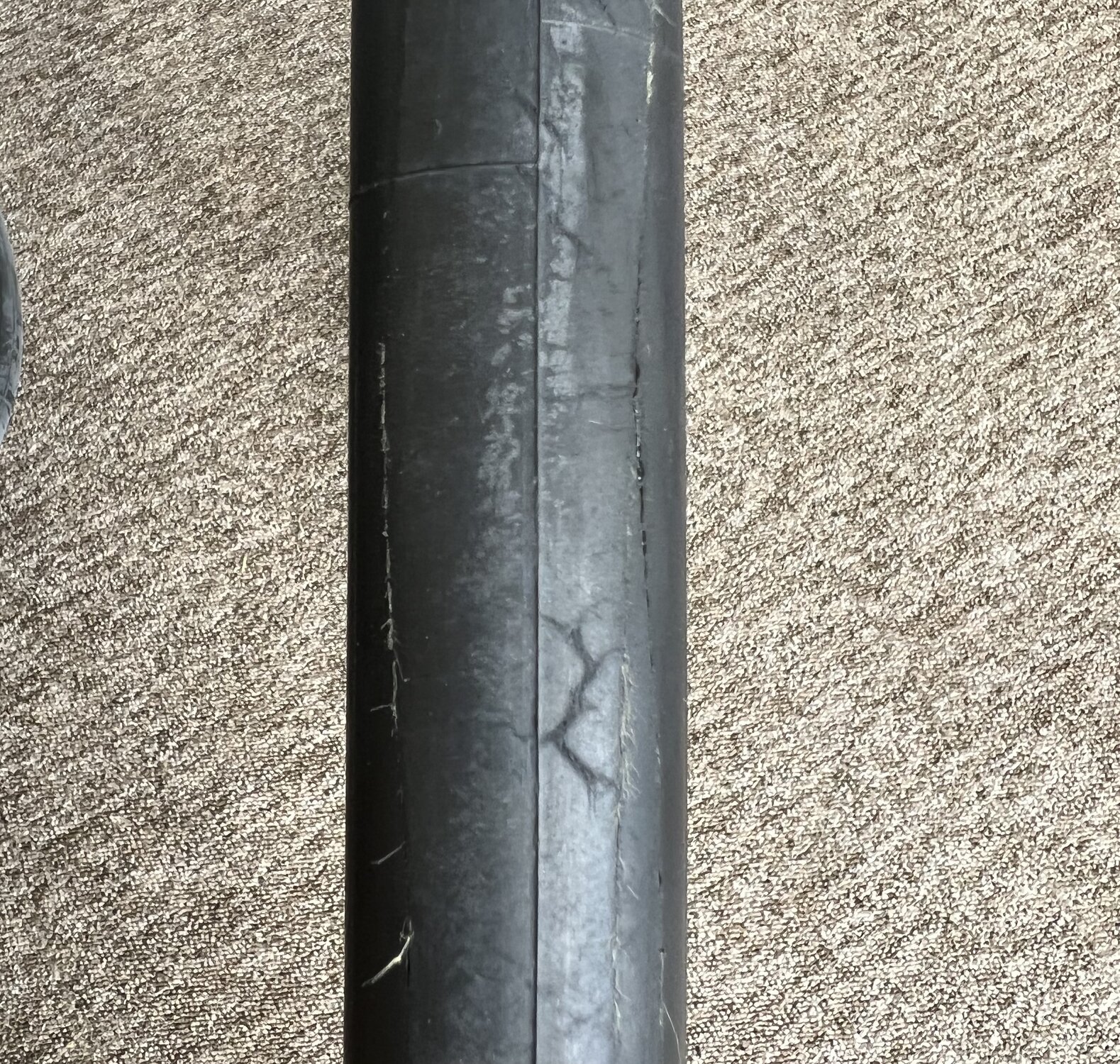

Got the bike home and started to repair the puncture and found something very strange. There were two equidistant grooves on the entire length of the inner tube, matching up with the edges of Panaracer tape. I found the puncture and it wasn’t a normal puncture, but a split along one of these grooves.
Essentially, the puncture resistant strips had actually weakened inner tube and caused the puncture.

Thanks for the prompt reply. There is no photo of the tyre. The inner tubes are partially inflated to show the damage.
I've had a Slime liner fold over and slice the tube. I found it a bit funny that the liner sliced the tube.

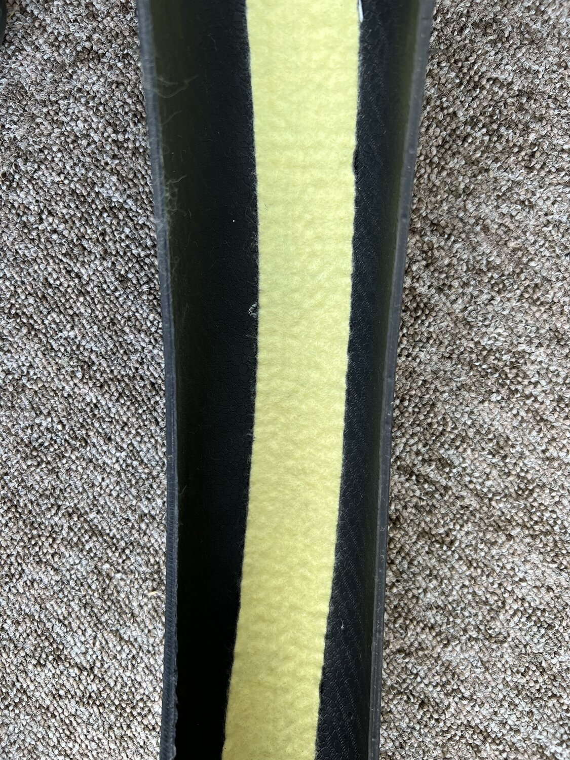

After further examination of the inner casing of the tyre after taking off the Panaracer strip, I found that it had also damaged that. Some of the rubber has been eaten / rubbed away and exposed some of polyamide / nylon casing material.
The marks are equidistant and correlate with the Panaracer strip.

Good report. Looks like a solvent degradation to the rubber compounds to me. I've never used any kind of puncture fix product, just ride on Schwalbe.
