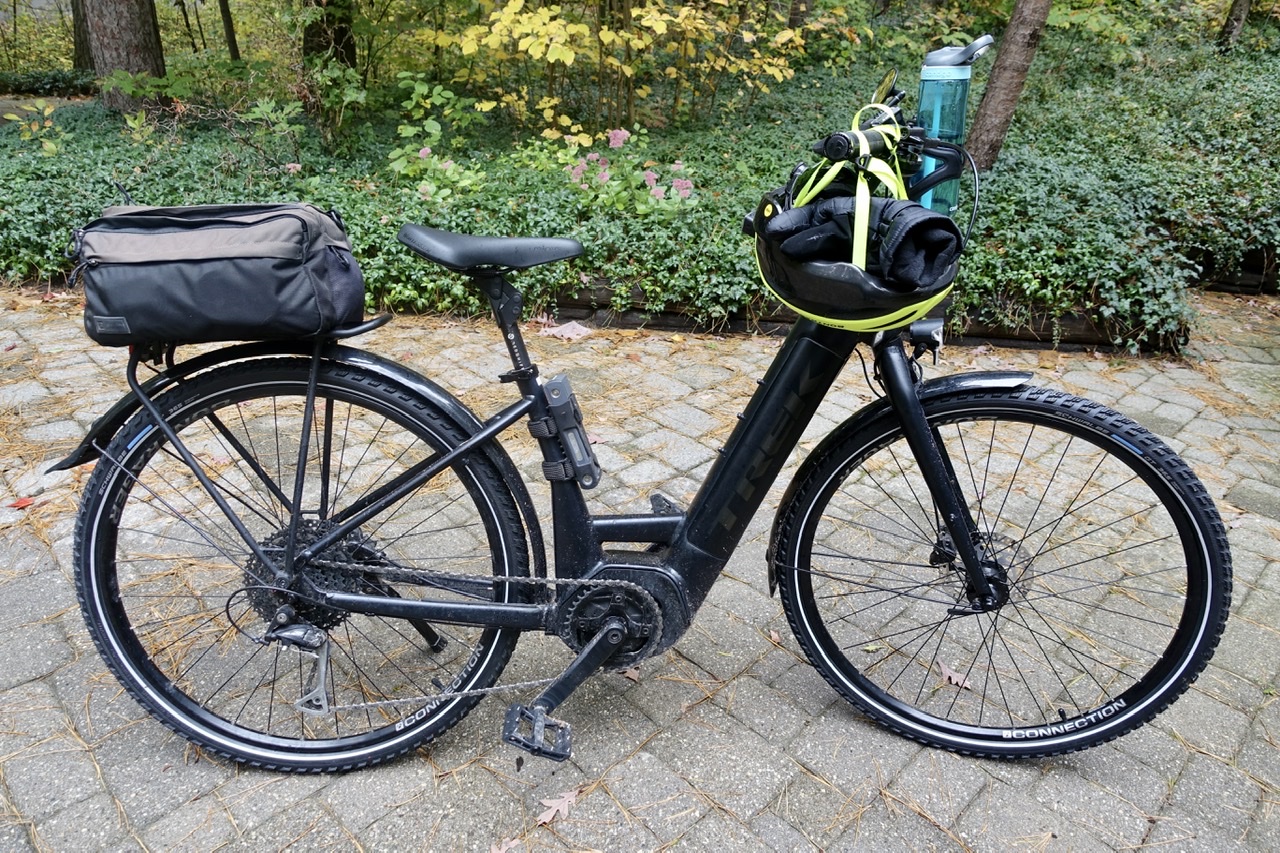

Just installed my new Marathon GT 365 45x700 all-season tires. They look good, have inflated to 45 psi. Quick trip around the block and I am blown away... they are absolutely quiet on pavement! Will update after the first real ride; fall is in full swing here now and the weather is cooler and wetter by the day. Looking forward to getting a better grip on the trails.

Just installed my new Marathon GT 365 45x700 all-season tires. They look good, have inflated to 45 psi. Will update after the first ride; fall is in full swing here now and the weather is cooler and wetter by the day. Looking forward to getting a better grip on the trails.View attachment 69124
Lookin good and yet aggressive. Let us know how they ride!😎👍
BTW, it’s already snowed twice here!🥶

I’M a SCHWALBELIEVER!! Took a longer ride on pavement, gravel and some grassy wet trails. The tires are completely quiet, not as loud as the Bosch engine, which is very quiet. No apparent extra effort needed over my semi-slick Bontragers. Very good grip on some wet/muddy/sandy corners. Very happy with them!
Now for the bad news. A stick destroyed my rear derailleur, beyond repair.

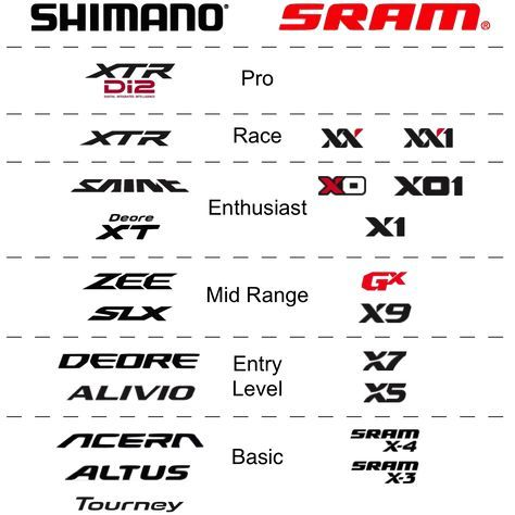

I recommend upgrading to Shimano Deore derailleur (it's a step up from Alivio) and you will be pleased.
I called my Trek dealer and they only have Altus 9 speed in stock or available I believe Ravi. Do you think I can get a Deore? I haven’t looked into it, but would be happier to go that route. I could even just get a $40 Altus tomorrow to hold me over until I can upgrade. Not sure the Altus will handle 46 teeth? Still have my original 36T.
This is a comparison chart of Shimano components. As you can see, Altus is a bottom rung component and found on $1000 Chinese bikes.
Alivio is ok but Deore is a good compromise between decent performance and cost. I have used Deore on Haibikes and it held up very well even after 4000 miles of use.
