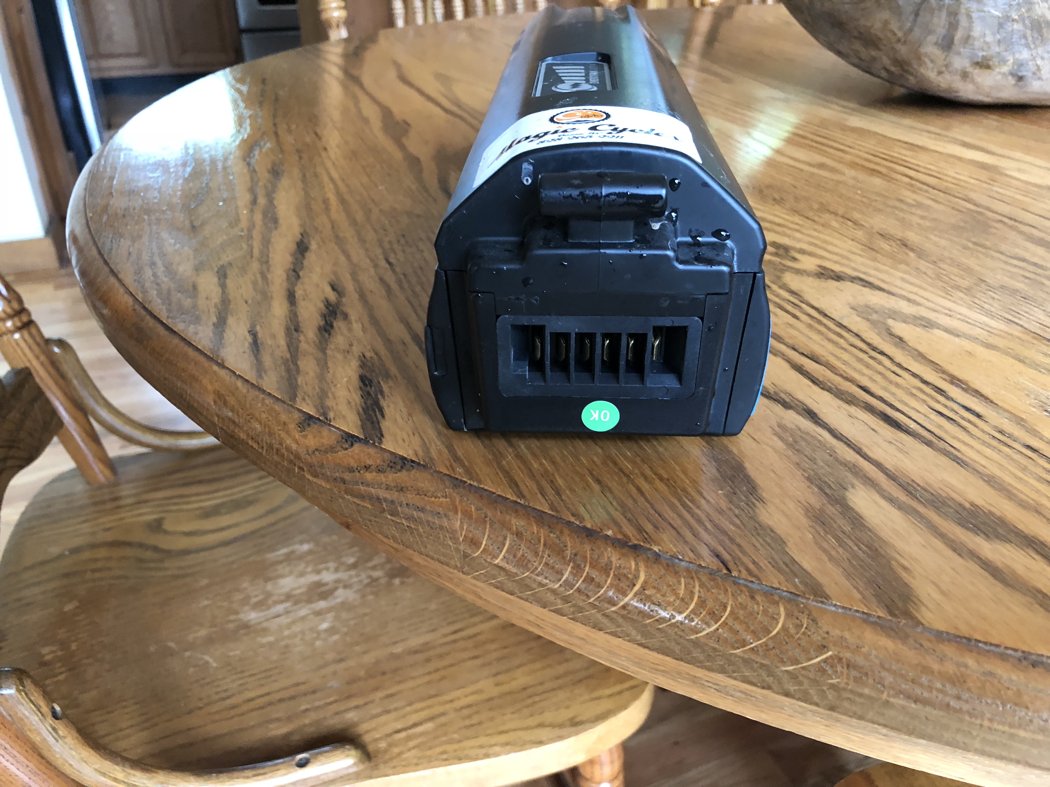

I will take the picture of the 500 next to the 400 when I get it I will send the the picture of the 400 in the meantime

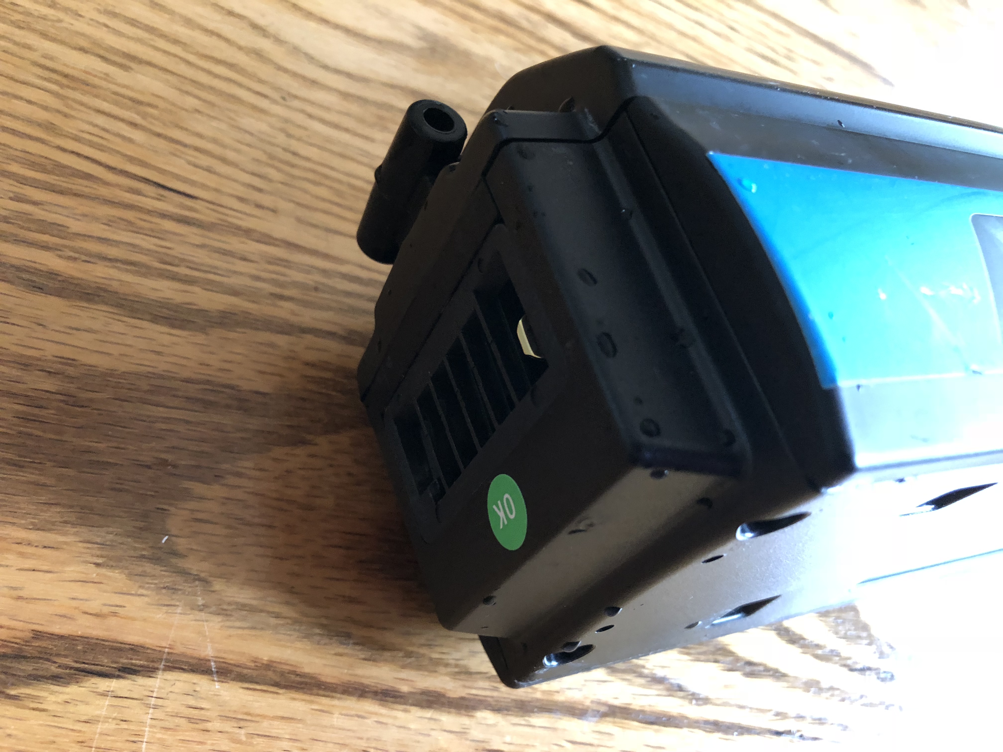

Thanks for the photos, it'll be interesting to see the two side by side. For what it's worth, this is mine
I've tried to give you an idea of what the bottom cosmetic plate looks like - it seems to line up with the left shock link ( yours looks to be more central?)
BTW, I notice you have the blue shock adjuster on the full open setting ( I think - we have different shocks) - try setting it either central or to the right and see if this helps with range ( Sorry, I don't mean to harp on about this)

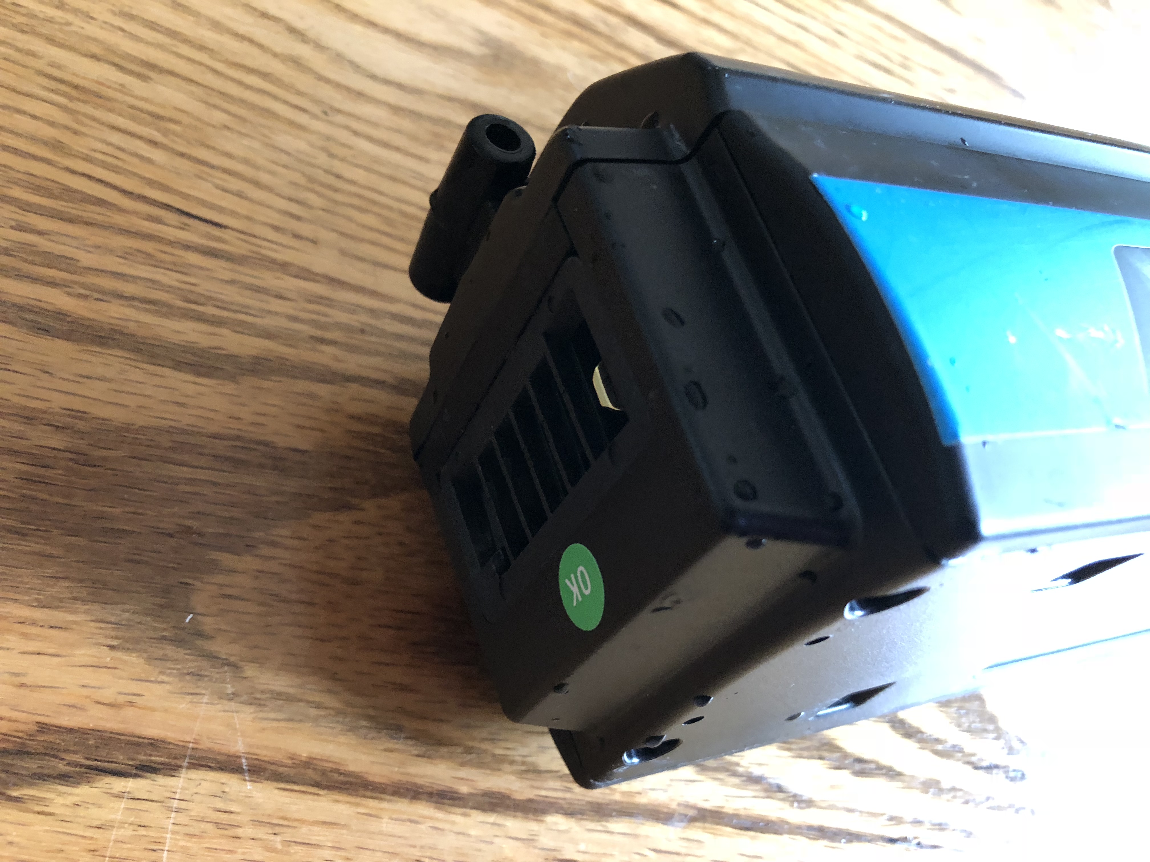

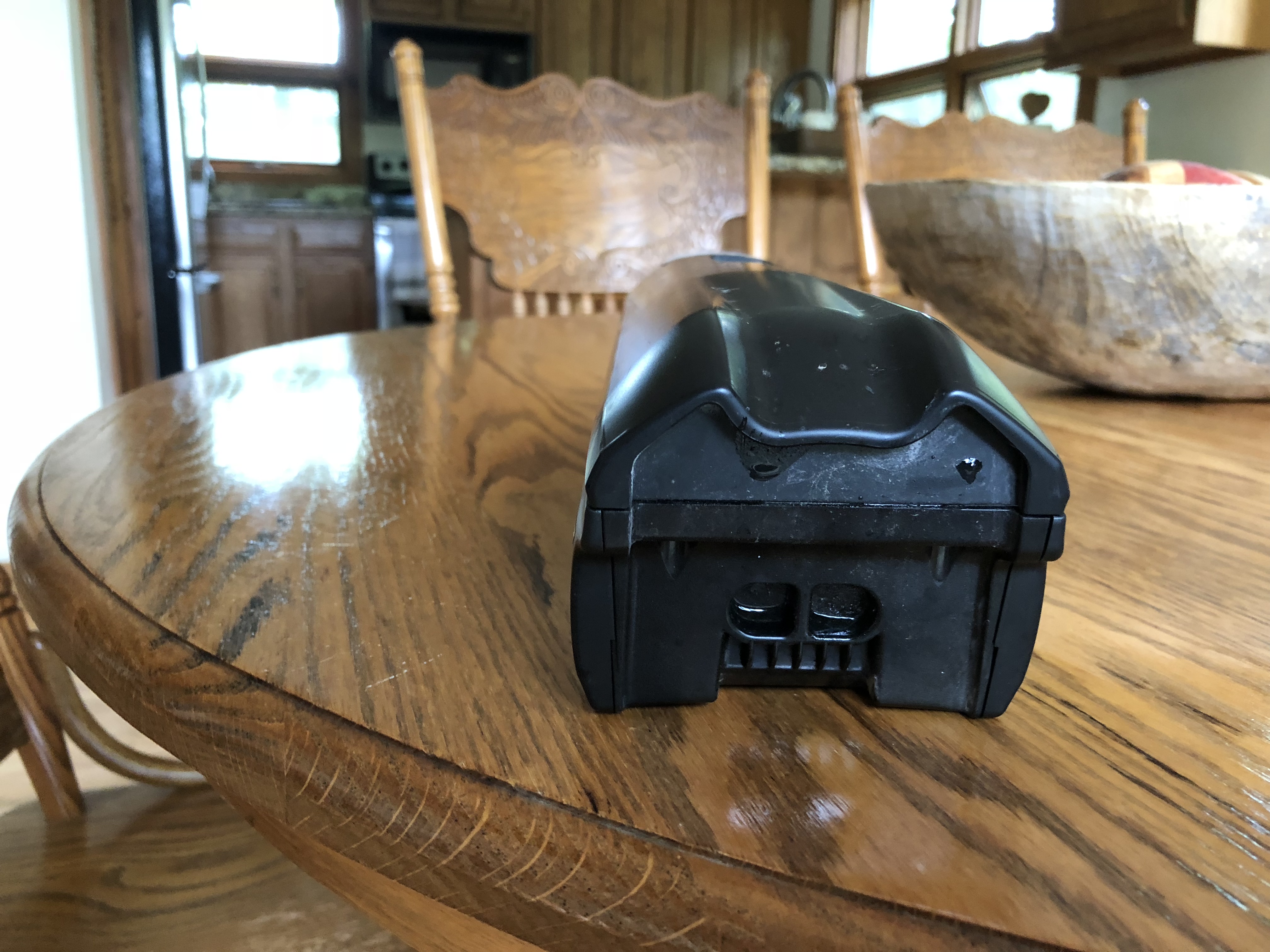

Windward...looks like I may have been given the wrong information that the batteries were interchangeable...It has come in and I will have it on Monday and see if it will work...judging by the pictures I see here it will be a problem.

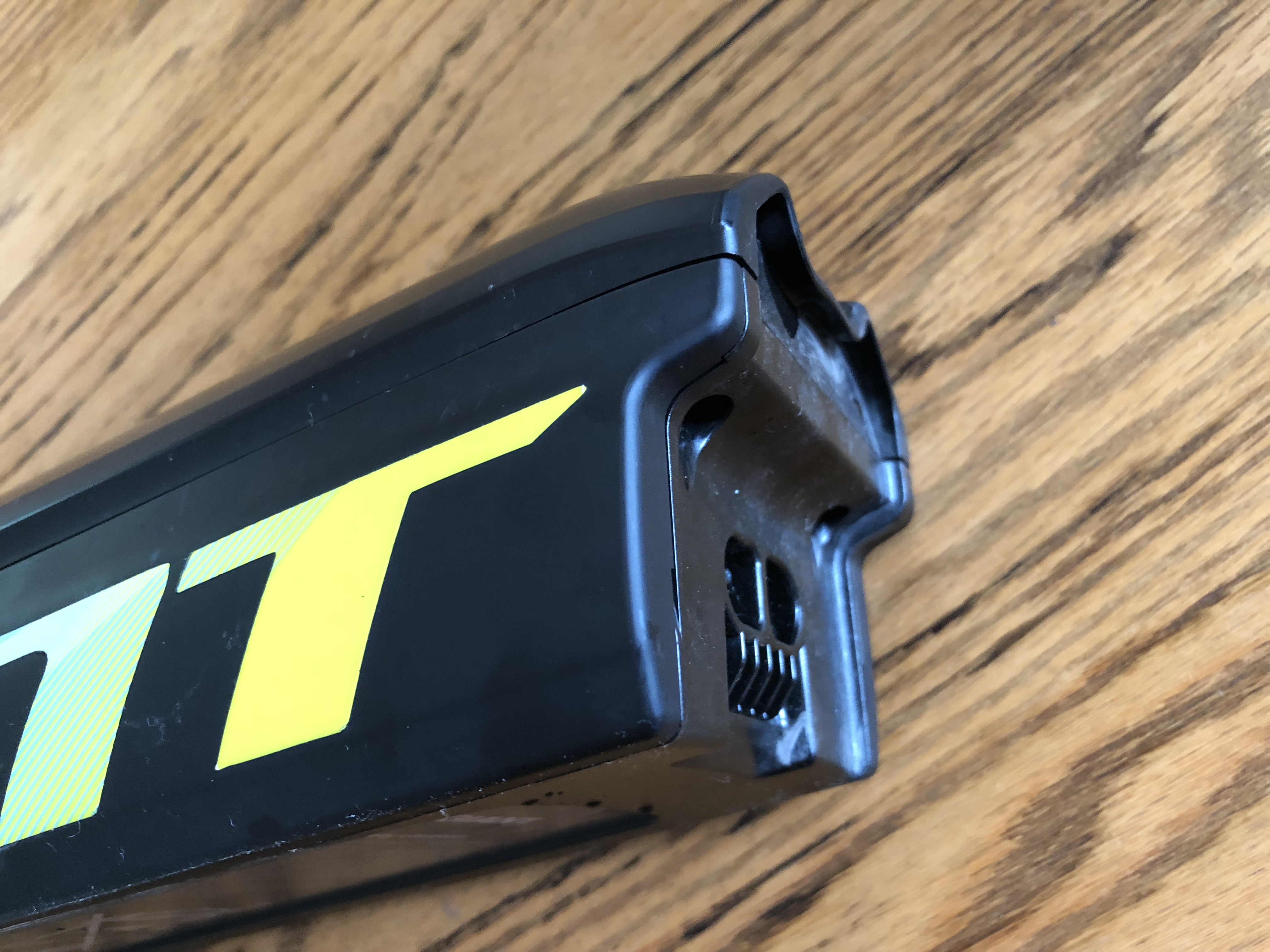

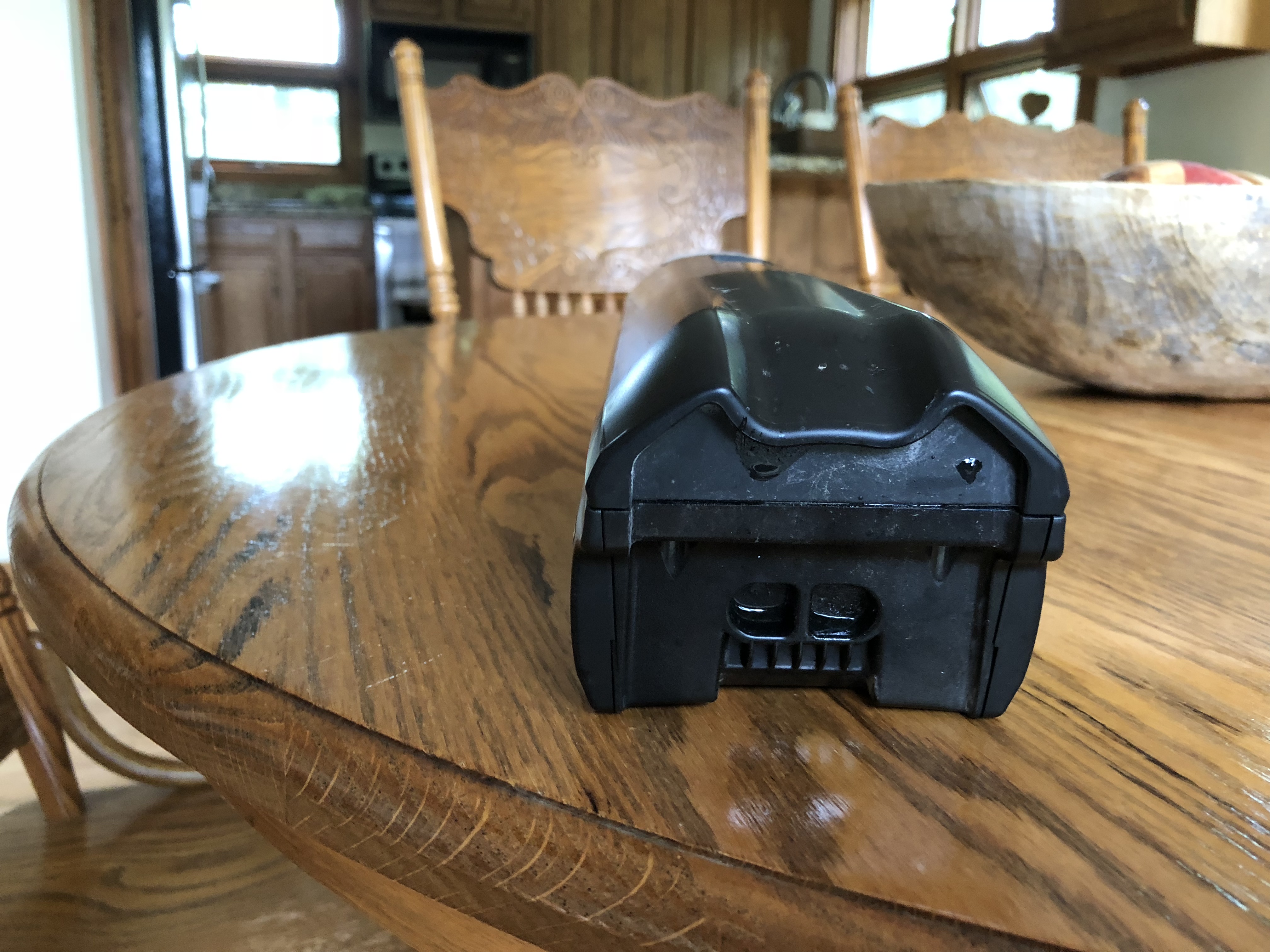

If it's any help, these are the top / bottom of the 500 battery
Now I am more hopeful as they look very similar... my friend is bringing the battery up tomorrow and I will know for sure and let you know
