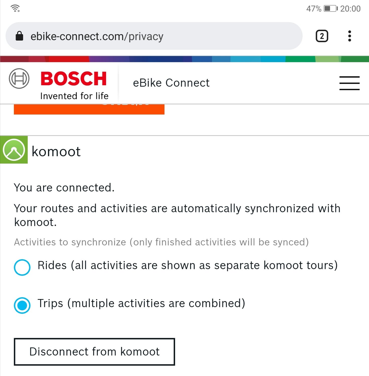

Your settings in the portal (under privacy) are the se as mine?
No. I had it set for rides, not trips. I just changed it, and will see tomorrow what happens. It may well be that this is the issues, since I'm not sure how one "finishes" a trip. Have you tried the other setting?
My understanding of it is this;
The setting on the Nyon controls onboard batching and this is where you can set the delay before individual trips are combined. You need to finish a ride here for anything to happen later in the "pipeline". That is the first failure point. Finishing rides is not something you can trigger manually, which adds to the problems.
The setting on the portal controls how trips are combined before syncing to komoot.
The confusion is how these two different things interact with each other.
Yup. This is the issue! My ride today did not go to Komoot yet. If you change to "rides" it should work, at least it has for me.
you then are back to split rides on Komoot (how it used to be), is the point of the new functionality, the ability to merge all your rides into tours? A fix isn't "turn it off".
