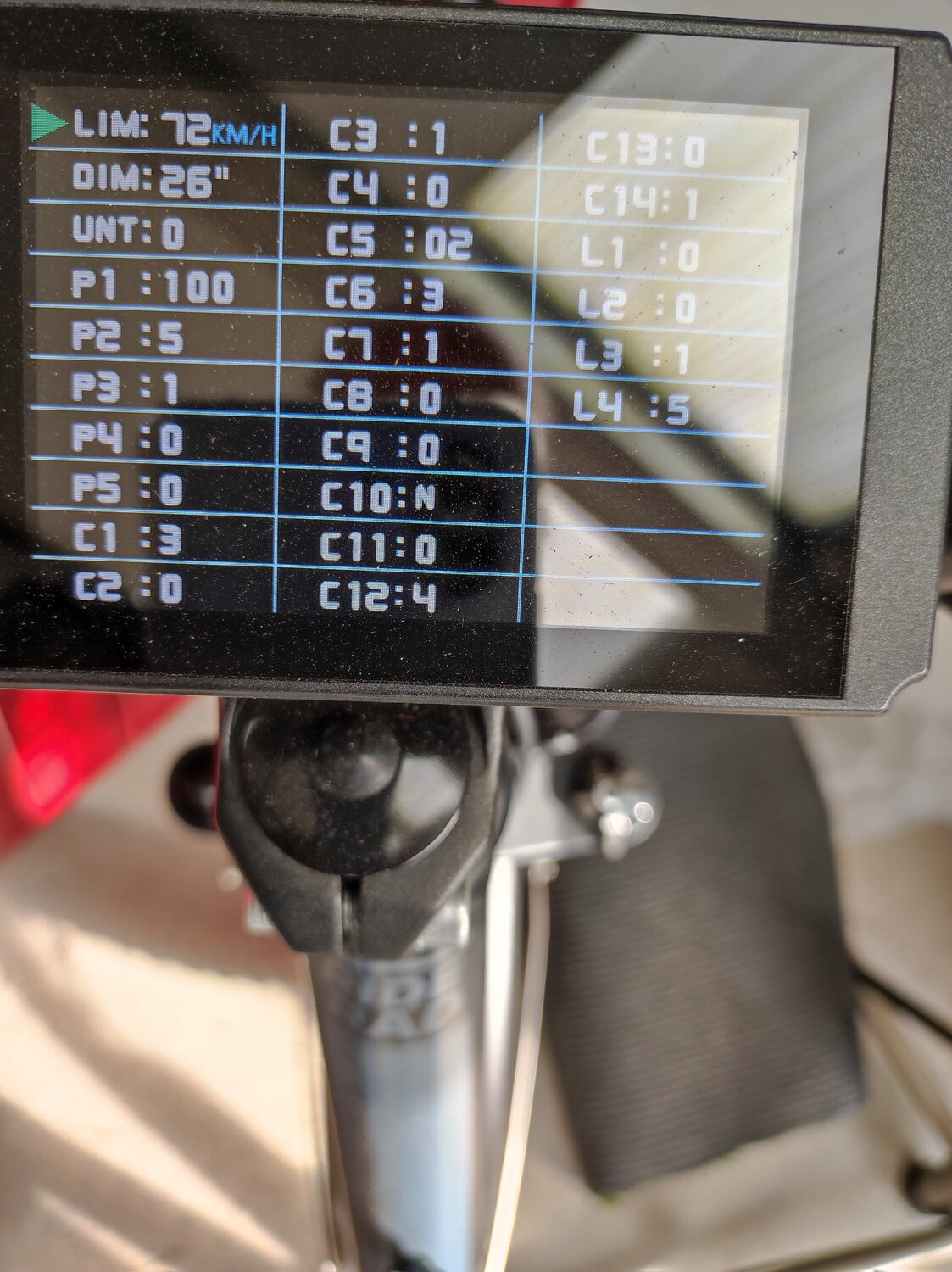

Hi A when I turn throttle it jumps between 1200 to 2000 here's my settings
Your settings didn't post.
I'm wondering if your throttle is wired correctly. I don't think your wattage readings should be anywhere near that high unless the motor is running and loaded way down.....
I tried a different throttle still the same

Different throttle, if it's wired the same as the one you have, will make no difference. There is NO assurance the colors will be correct, or that they will be installed in the same order in the connector. Are you using the throttle originally supplied by RAD?
