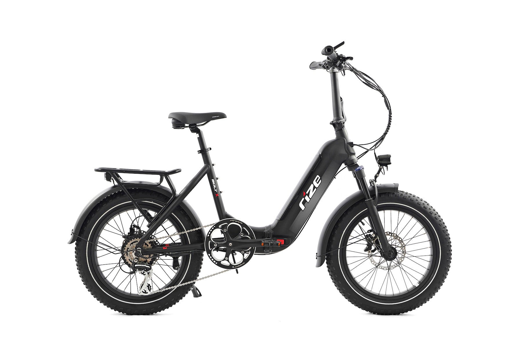

Volt Mariner
Biktrix The Kuffy
Rize Bolt X
Rad bikes have a few to choose from
I think you are better off buying local as in Canadian bike shop so if you have any problems it would be far easier to deal with. If you buy over seas and something should go wrong you could very well be looking at a head ache. If something does go wrong and they want you to ship the bike back to them, well that could end up costing more then what you paid for the bike.
The bikes I listed above are from reliable companies that build quality bikes and are not going to break the bank.
